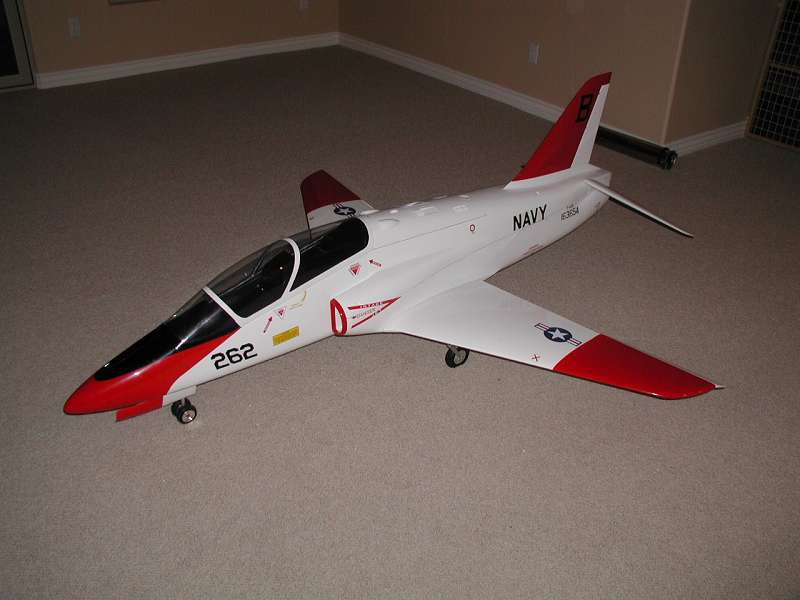

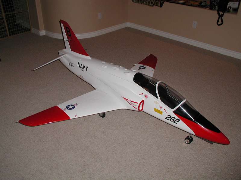

Hay Guys, I got my T45 last week, and have it almost ready for turbine install. I am also building a BVM King Cat, and had the pleasure of spending some time with John Redman, while he was here at the Pheonix flying field training a friend on his King Cat.
Here is my question, John has set up the King Cat to use CROW, a really simple way to make both ailerons go up ward when landing flaps are deployed. It really slows the KC down alot, could this configuration work on the Hawk, ??? Has anyone tried??

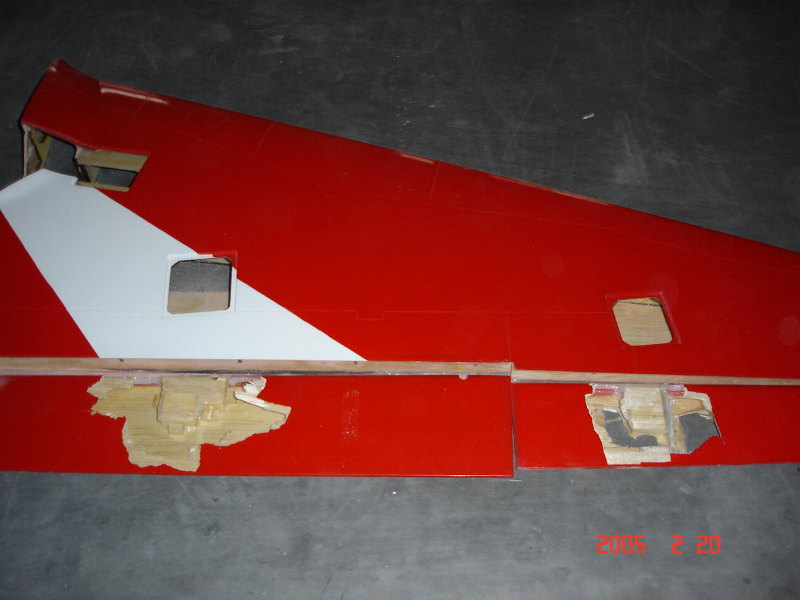

when cutting the ailerons , rudder
there is just a empty room in there no balsa
so it is extremely difficult to have them glued correctly i uses plenty of glue to fill it and then mount them
however on the flaps there was enough balsa to glue them.
they forgotten something?

when I see your post, I just cheching the inside of Flaps with Ailerons for Hawk,
I am sure that Hawk has put the Balsa inside for the Ailerons and Flaps Horns,
I will better our Quality and TKS for your suggest,

wow you did not had to destroy the wing to show me [8D]
but really the wood for the flap was there
but i could not find the aileron wood
maybe mark it next time on the outside?

don't worry, the Flap with Aileron are our cancel parts,
I just see the inside that our worker has make a mistake,
I will QC all our ARF Jet by myself , when they delivery to your doors,
Please feel free contact to us for better our Quality,

i saw the manual mentioned the aileron servo,s but now looking closely the picture on the manual is from the flap
maybe that was the mistake?
maybe in the next revision of the manual a little clearer

Please see this picture that will be right,
I think that I must clear in the our manual again,
Hello, Sandor
i see now what you mean
but for strenght is it not better to move the servo to be as close to the center of a aileron or flap?
also it is better for the hinges to have the control horn near them for strenght
anyway this is how i always set them , but now to see the picture it is more clear

Hi Larry,
Yes I ordered the carbon fiber horns seperate from cost of kit. Always ask is there any thing else I may need when ordering a kit. I learned this many moons ago. The 6 aluminum servo brackets can only be used on standard size servos, so I put them on both flaps, and elevator.
I am sure most may not agree, but when it came to the small JR aileron servos, I sanded the bottom and aero poxied them in. Now in doing so, I make sure by trial and error, that the servos are in the nuetral point (by using the tranmitter and reciever and making sure they are correct) then a lining the servo horn at a 180 (T) degree to the moving surface. It seems that Skymaster has built the servo lids on an angle??? No worry, but be sure to set the servo and horn at a 180 (T) to the moving surface.
It is important (for me) that the distance from nuetral servo horn to carbon fiber horn must be installed at the same distance, and that the horn on the moving surfaces are identical to each other. ESPECIALLY FLAPS. I achieved this by making a small jig and using a drill bit that fit in the hole of the horn. On the jig CA a piece of balsa and keep the distance the same by measuring from the trailing root, NOT THE HINGED FRONT ROOT. I measure from the trailing root, because your robart hinges my be slightly in deeper on one side and thus giving inaccurate distance.
So there is what if have done so far.
I just bought a P120, and will install when I get it in a few days. The gear doors I am still deciding how I want to mount, but besides that the entire plane is done. I have been home sick for the past 4 days and have worked on it for about 6 days total. It's ready for the turbine. Not bad when you consider every other build up kit takes almost 6 months to a year to build and detail. Scale kits of course. The King Cat has taken me about 3 weeks to build and I finished that up today also. Nice hobby to have when your home sick.
Kevin Marks
Kevin Marks
