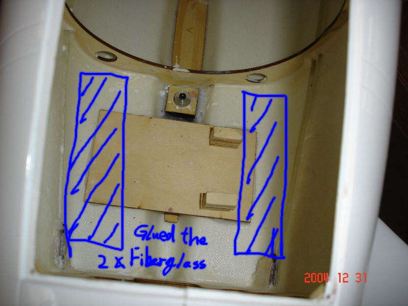

Tips for all Hawk Customers:
we had update the Instructions Manual for hawk,
Please Glued 2 Fiberglass for cover the plywood mount for Strong more...

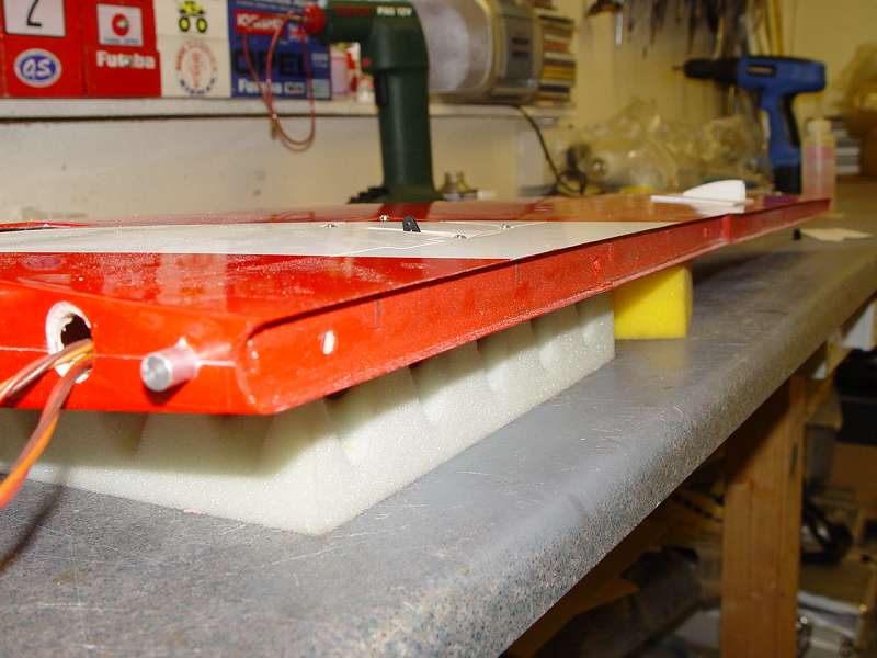

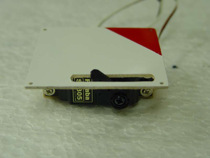

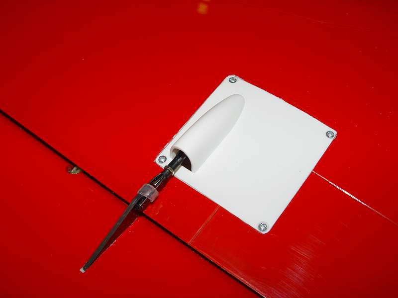

HI Guys
I just made some changes to my new hawk wing.
I was not mad keen on mini servos for the ailerons so I modified the wing so that a plastic servo box would fit. I lined the edges of the hole with ply to allow the box to screw down and this has made for a far stiffer set up and I got to use a standrd size servo.
Also the Flaps. I made the servo attached to the hatch cover. One side I stiffened and the other was left standard and there isnt too much flex in either.
For cosmetics I painted the trailing edges in the same colour as the model so that you can not see any bare wood

Ali, gree on the mini servos, JR 9411 are more suited but are a tight fit, but they will fit.

#60

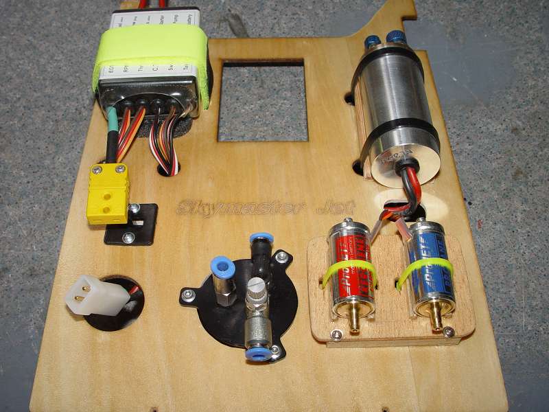

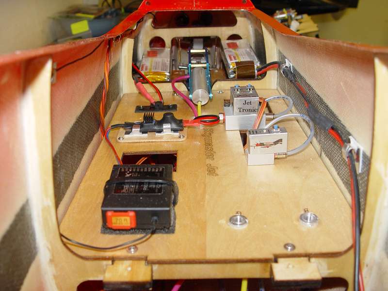

yep here you go
exept for the reciever but you can see where its going to be
the purple thing is a lipo pack 4400 7,4 volts for the turbine
i decided to use this since i am putting 2 x 5 pack sanyo 3300 in the nose to get the cg ok
the kero and gas valves , hoses , airbottles are beneath the "floor"
if anyone is wondering why the Jetcat was mounted :upon request of the customer
it was not my firt choice , i dont have jetcats

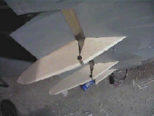

#66

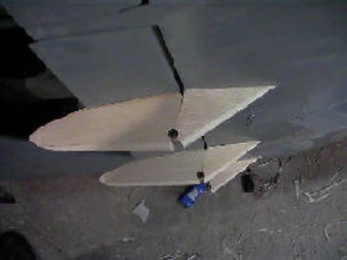

@anton and ali
found another small glitch
i was testing the gear today and found some problems
when putting gear out sometime the gears would not come out without some help
first i thought i did the mounting a little wrong maybe to tight
but found out this little problem
the cilinders input was not alligned correctly it will touch the frame when putting gear out and then cousing some friction
i used a dremel to cut out a little of the frame now all works ok
maybe you schould all check this this will save you a few hours off puzzling like me
and tell the manufacturer to check if the input is aligned in the middle (it is just a matter of drilling correctly)
note: the pictures show the gear in out position so you will have this problem only when gear is coming out!
just check if you have this problem if not leave it
here are the pictures:

Guys I like what you are doing with the more scale like flap but I am a little worried. From experience the last thing the hawk needs is more flap movement. I have been in situations Early on where large flap movements caused a pitch down that could not be picked up by the stab (No matter how much movement) Now I am saying this as a technical idiot and I do not know if the scale type flaps will lessen the pitch down situation. If so great lets go full steam ahead. But if As I suspect they do not cancel it they will only make it worse. So be careful.
David,
Whats the Spec on those Jr Servos
Sandor. I did see the potential of a similar problem with my hawk but I adjusted the position the actual retract on the bearers so this nipple cleared the wood work. I slid mine as fas as it would go toward the wing tip. Also I notice by your picture that you have raised the retracts off the mounts with washers. What I did was I removed the moulded lip that is on the wing around the retract mount opening. This meant my retracts could sit square on the wood mounts and slide toward the wing tip thus clearing the nipple.
I hope that all make sense. If not I will take some pics later today. Cant do at the moment as camera is flat
Here are some epics of my install. All done apart from the UAT which will hopefully arrive today

#68
ORIGINAL: Ali
i considered the wood but that is not a problem since you just swap the gears left with right and the wood is no problem
it was for me a real mechanical problem
secondly i put the spacers beneath the gear otherwise it will rest on the fiber and not on the wood
now the gear is ok and all works

Ali,
The JR servo is the 9411 in UK/US (9401 here in Asia/ Pacific). It is a 5Kg mini servo with metal gears and really is a mini 9411 I have used a lot of them in my jets such as the BobCats, Sabre and even in my Savex L39. with total success. It is a tight fit in the Hawk wing but it will go in. Metal gears remove the possibility of any bumping of the surface damaging the gear train.
I too would caution builders about the slotted flap mod. As I wrote earlier the pitch down problem was discovered on the original Hawk and was fixed by DELETING part of the slot on the outboard section of the flap. It might look more scale but COULD give you problems. Just a suggestion.
