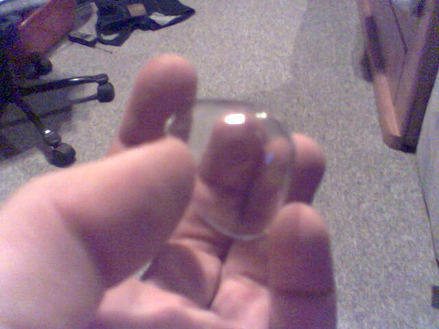

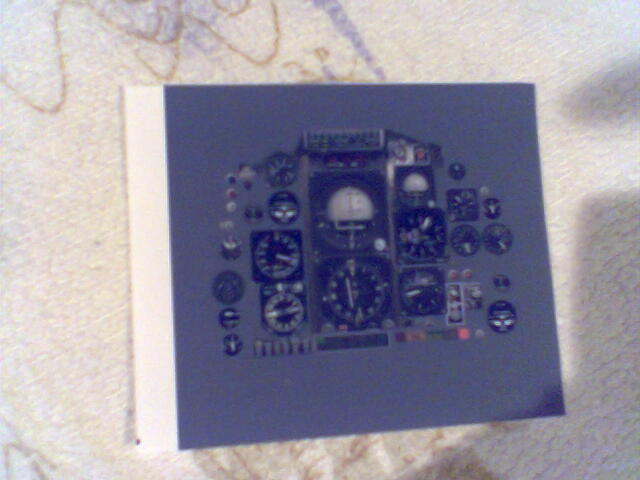

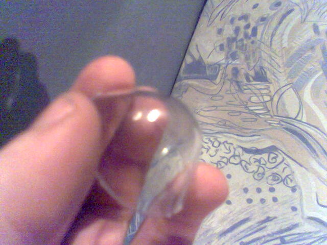

I would be very interested to see pictures of your landing light and instrument panel. I always wanted a landing light I think it might look good on my new hawk. Thankyou for your opinions on the nose section.
Ali, i will take pictures of the instrument panel tonight when i get home.
As for the landing light, pictures will be until i get a chance to visit the plane again. But the basic principle is fairly easy: A 1W luxeon emitter (available through conrad electronics for instance) with a larger custom heating conductor is placed in a MagLite flashlight mirror. Diameter is about 2cm (rough guess). I heated a butyrate sheet in the oven and pulled it over a plug to fit the Hawk nose. Cut off the nose cap, install it and off you go. We were afraid of using the 3W or 5W emitters, as they produce enormous temperatures and would probably melt away the mirror if our heat conductor doesnt work the way i plan. Might try them if the 1W holds up fine and the temps we are getting remain in the ok-range. I'll keep you posted on this, and will get the pics to you asap.
Nice looking hawk, by the way. That airbrush look sparkles out a lot
. However, it is not quite scale...the real thing had sharp lines as i recall....

Here are the pictures i promised. Sorry for the low resolution, modern mobile phones do come with camera, but they are not worth their weight in fertilizer.....cant see any of the fine panel line detail or screw heads
I'll be off to deliver the stuff tomorrow, and will see if i can get my hands on the "family digital cam" for that

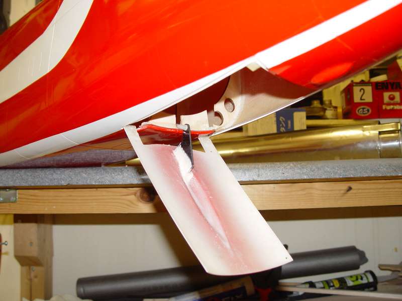

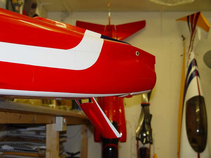

I did mass balance the stabs. It nearly cost me the model. In a blonde moment I added the lead and was so keen to see how it worked I just went out and flew. Of course I didnt factor C/G into things and the lead added made the model too tail heavy. Anyway the out come was one exciting flight and the decsion that no difference at all in flying feel was made by mass balancing. I wont do it on the one I am building now.
As for airbrake.
Just finished but have not flown with it yet.
As for airbrake.
