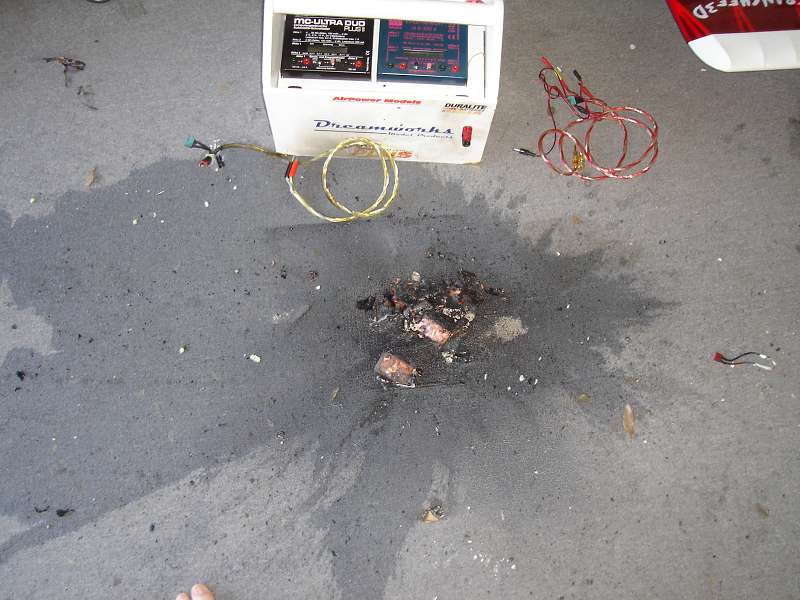

Well..... Almost had a disaster on my hands today. At FJ I picked up a small electric 3D airplane from TAM called a Banshee. I bought the entire flight package with the plane which included a 3 cell LiPo pack. This pack did not have the charge safe circuitry that most of todays Li packs have. Wanting to get a flight in the front yard this afternoon, I put the pack on charge, setting it on the floor of the garage. Went back in the house to watch the race. about 20 min later the smoke alarm in the garage goes off....! I go running out to find the battery in flames. I was very lucky as the only damage was to the charge lead, carpet and the paint finish on my charge box. This could have been a major disaster had I not recently installed a smoke alarm in the garage......
First and last time I will EVER use a Li type pack without charge safe circuitry! Also not a good idea charging in the house.... Just a reminder to be very careful with these batteries, I never thought it would happen to me

Todd,
What charger were you using? What was the pack capacity and charge rate? As far as "safe charge" circuitry, I could be mistaken but none of the Kokam, Thunder Power, Apogee, etc. packs I have purchased in the last 6 months have had one.
Glad to hear you didn't have an even bigger problem on your hands... that's ugly!

Pack was a thunder power 3 cell 1320mah, charger as a cameleon set at 3cell 1A charge. This was only the second time charging the pack, it was in perfect condition.... Just charged a Duralite 2100mah pack with the same charger to test it, working fine. All of the Duralite and great planes electrifly packs I use have the charge safe circuit and I have never had a problem with any of them.
BTW..... I SHOULD HAVE KNOWN BETTER.... I dont ever charge in the house, stupid move!

While I have never had one explode I have seen enough incidents to convince me to only charge them outside and away from everything.

Can you identify anything further to have this happen, I have been using 3 cell Thunderpower packs for last two years and have never seen anything out of ordinary. I routinely charge my 3s 1320 for a eheli @ 1.5amps on a MCDuo V8.06 and never feel any heat at all with pack. Very disturbing and puzzling, I've been thinking of outfitting all my RC models with Lipo's as I have been very pleased with their predictable charge discharge cycles.
What software version is the cameleon running?
Was it on LIoPO or LIioN just asking as you say you had just charged a Duralite......
Id be looking very carefully at what charge settings i had.
Stories of lithiums exploding during charging must in the majority of cases, be due to incorrect setup. If not, theyd be exploding all the time, Noone has ever heard of mobile phones exploding during charging, and yet we charge them all the time. I think human error is probably more likely than a faulty pack.

I think you guys are misunderstanding what I am saying..... Charge settings where indeed 100% correct, I am very careful when setting batteries on charge knowing full well the dangers involved..... This was just pure stupidity charging them in the house as I NEVER do...
After reviewing the charge settings to assure they where correct, I change the charger over to LiIon setting and charged a duralite pack just to see if the charger was working properly. No issues during this charge....perhaps just a defective pack.... whatever the cause, my point was to charge in a safe area, dont take any risks, the one time you do is when you will get bit....

This is from the Polyquest safety sheet. Please note that even with safety circuitry they don't recommend the Schultze charger. This is not a slam on anyone, just another heads up for safety sake. For those who are interested, FMA makes an add on safety circuit.
1. Protection Circuit Module (PCM)
All packs shall be used with a PCM which protects the cells/packs properly.
The PCM's have the function of preventing overcharging to maintain safety and
prevent significant deterioration of cell/pack performance.
Short circuit will destroy the cells/packs which can cause overheating, burst and/or fire.
The PCM will stop charging the battery if any one cell reaches above 4.30 volts.
Never disconnect the battery from the PCM during charging. Power down charger first.
PCM Guards are not compatible with pulse chargers such as Schultze.

Probably not defective. More likely it was abused and these batteries are really easy to abuse.

Im glad that nothing serious happened. There is a product called battery bunker im not sure who makes them but I have seen it here on RCU in the market place. Its a ceramic Jar for charging that will contain any battery issues. (Still have to be careful what you do just an additional saftey measure)
Also ThunderPower is comming out with a blalance module that will make sure all cells in the pack are balanced. I have had some of my 3 cells puff on me after some use and that got me mad because one was after 2 charges! ( Not a TP pack ). I found out that even in our 1 P 3S or 2S battery packs individual cells can get unbalanced and one can overcharge while charging. I beleive this can happen with a over charge protector that only protects the whole series of batterys together and not the individual cells. Bill or any of the electric experts please correct me if I am wrong.
The best setup is a battery with individual taps so you can use a balancer down line from your charger to balance the series batterys as they charge. This will prevent puffed cells that are the result of one cell overcharging in the series pack. Most of the new stuff I see comming out have taps and or saftey devices to use with the battery packs, you might want to check the specs out on the saftey devices and make sure that they check and balance the cells individualy rather that the whole pack at once. I have read that you will only need to balance the packs once every 5 charges, but again I am no expert I have just been reading alot lately.
I have been on the electric forums to keep up regarding this balance issue, they have some great info on these lipolys.

...perhaps the safety circuits on your other LiPos were masking a problem with your charger's LiPoly operation by limiting the peak voltage (4.2) before any damage could be done. The fact that the pack charged successfully once would indicate otherwise but, there is always the possibility that luck/chemistry were on your side on that first charge cycle. I believe the reason some folks are asking about the software rev is because of some posts on the web indicating some sort of anomaly related to LiPolys with some Schulze's with software earlier than revision 8-"something".
I know it's useless anecdotal evidence but I own a couple dozen LiPo packs from 250 mah 2S1P E-Tecs to 2100 3S1P TP's, none have a "safety circuit", all have been charged many, many times (matter of fact, several are now getting kind of decrepit after 200+ charge cycles) and I never had an incident.
Anyhow, I am sure the warning about charging in a safe place and not leaving batteries unattended, with the photo to show the consequences, will help someone out there realize they need to treat these batteries with extra care and respect.
