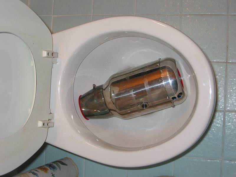

Wojtek, what I saw and heard today from your AT 400 sounded like a bad or clogged fuel nozzle. I can say with confidence that you did put oil in the fuel
If you noticed today everytime you spooled down you had the classic sign of unburnt fuel, ( the white smoke). Your motor never sounded like It ran with any kind of stability[
] My best guess would be that the incomplete combustion ( white smoke ) is whats causing the roughness and popping we heard today. Sorry I had to be the one to win the bet about how manny flights you would make before you had a problem, but at least I did not seize !

Woket, the engine did not choke when throttling up, it was when going down to idle .. sorry, I can see how I worded that improperly..
Don, you may be right, i don't know ... here is a video of the symptoms .. The engine gets throttled up to 1/2, and then brought back to idle, right at idle it makes that phhheeeuuuww sound, and puffs smoke ... it quit on the ground ince running it up like that, and then the 2nd time when taxiing out .. after that I created an extremely shallow throttle curve and slowed down the throttle channel to 2.5 sec transition time ... this did have a little effect, but the engine still puffed smoke and made that unusual sound going to idle when the stick was pulled back quickly .. During the flight i made sure to keep the stick at least at 1/3 - 1/2 stick ( that would be around 1/8 - 1/4 thrust as per my curve .. Before the engine quit, i do remember running like 2 - 3 laps at full on 100% power .. I’m pretty sure it was the next pass after that which i did at like 1/3 - 1/2 stick on the throttle .. by the time it was flying by me it was dead .. it definitely dies somewhere near 1/2 stick when it quit ....
here is the link to the video of the ground run ... im sure the FBF boys will be posting pictures the the plane being carried back to the flightline later ... [&o]

Sounds to me like you've got a fuel problem. A leaky line, bad fitting, blocked clunk, dirty filter or insufficient tank vent maybe.
I'm not sure about your earlier problems, but I was at the AMT factory Friday a week ago (11/11). They were running the s**t out of your engine trying to make it fail. I heard it running over and over throughout the day. Full throttle, idle, quick spoolups, quick idle cuts...everything they could think of.
'Low RPM' error is what you get if the fuel flow quits or is significantly reduced. A sudden fuel stop (with subsequent sudden lubrication failure) is definitely BAD on the bearings, especially if you're still airborne and windmilling. Rapid shutdown from full throttle while flying can 'shock cool' the engine causing the thinner parts to cool faster than the turbine wheel. This can occasionally cause a temporary lockup situation. It will be OK after the temps equalize as long as you don't try to turn it. I've had this happen a couple of times on my jet sailplane when I shut down in flight after a hard acro routine (lots of full throttle time), and left the engines exposed to the cold air while landing. (BTW, it's still running.)

When I first got my AT-400 it would act the same as what you are experiencing. They said that my pipe size was not the correct dia so I had Tam make another one for me. Still the same, so I put it on the bench with no pipe involved. Still the same. Then messing with the throttle curve was suggested. I fly JR 10X and when programming the failsafe there is no way to have it drop to idle with a curve. So if a split-second failsafe condition occurs it's a FLAMEOUT! An engine that cannot withstand a brief failsafe condition is junk. I sent it back and they tweeked the ECU so that it won't do that any longer which is what makes it the sluggish P.O.S. that it is today. Problem solved!

Woj---If this guy did indeed witness your engine running I would request from AMT the fuel pump and ECU they were using to test your engine. Are you using an EDT to check your throttle curve???

Kevin, that’s a good point .. If the engine did indeed run on a bench at the factory, the only difference here could be that my ECU and/or fuel pump are to blame ... however this also at the same time does not make sense ..... the pump and ECU had worked fine for a while now, and actually have been in to the factory a few times with the prior seizures .. A bad pump/ECU will not make an engine blow bearings ... as it is , at400 had issues which were supposedly a combination of out of spec bearings and improperly drilled cooling / oilier holes in the shaft tunnel ... the last time my engine quit, there was a noticeable clanking in the engine after it un-jammed. This time, the engine spun freely, but it did quit, and the symptoms of going to idle were new to me .. when it quit in the air, it was at least at 1/3 throttle , and this was not an issue of it spooling down to idle erratically and quitting .. in this case, i would think it was more the engine over the ECU/Pump ...
bottom line, it still does not work [
