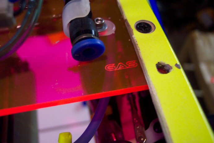

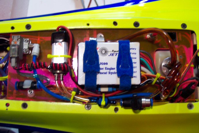

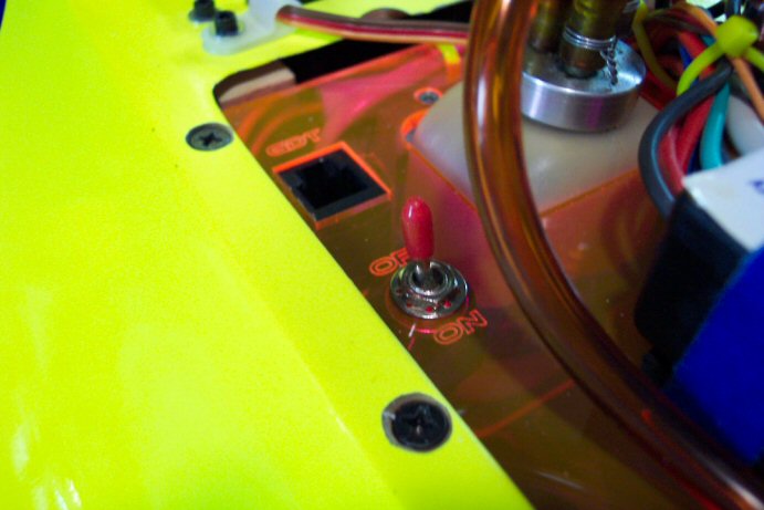

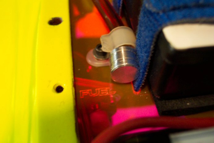

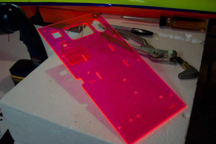

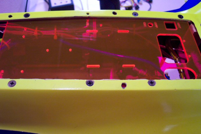

Hey guys,
Decided to fire up the laser cutter today to replace the accessory plate in my Stingray. Thought I would see what you guys thought.

A couple more.

Thanks for the comments, I have a 50 watt C02 laser from Emmission technologies. I am no sure of the minimum requirements to cut plexiglass but mine zaps right through it. It nice when I need something made, I just whip it out in CAD and throw it on the laser, sure does beat a scroll saw!

I have never tested the maximum thickness. I never cut anything thicker than 1/8" on dense materials because of beam divergence that would affect accuracy on thicker parts and materials. I have cut 1/4 balsa with no problems. E-mail Robert Conway at his site, he can give you the real specs on what it can or cannot do.
