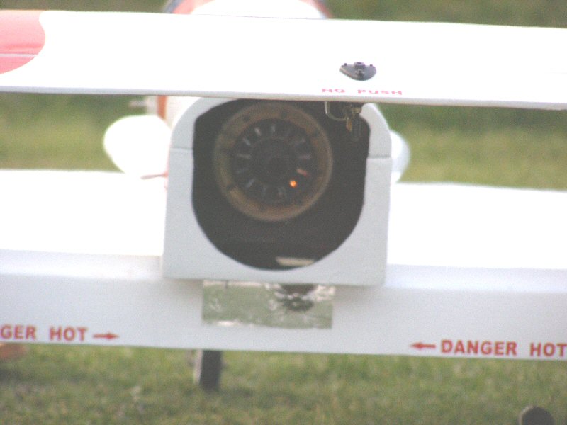

ORIGINAL: Xairflyer
Noticed a little orange glow the last evening in the low light so took a pic, wonder what it is ?
You should fire it up just after dark - you can really see where the hot-bits are http://www.youtube.com/watch?v=Nh0xpEQlAK4
BJ

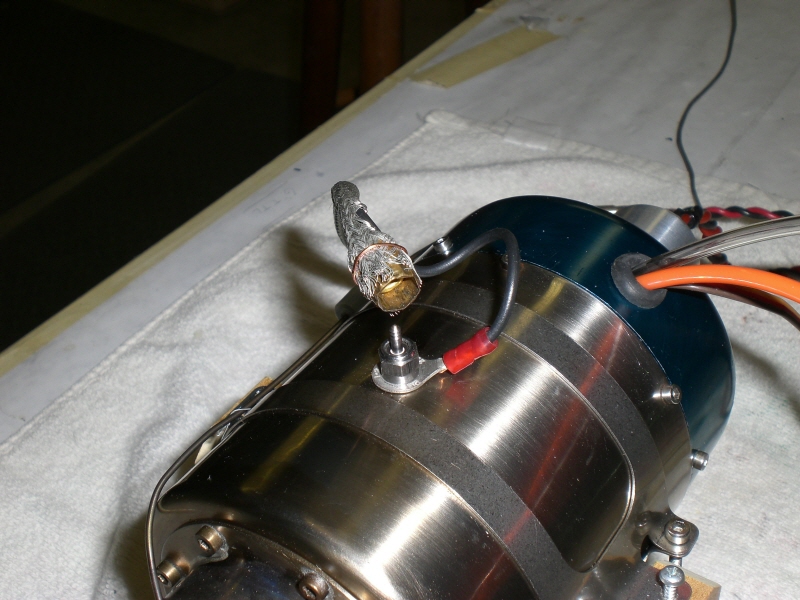

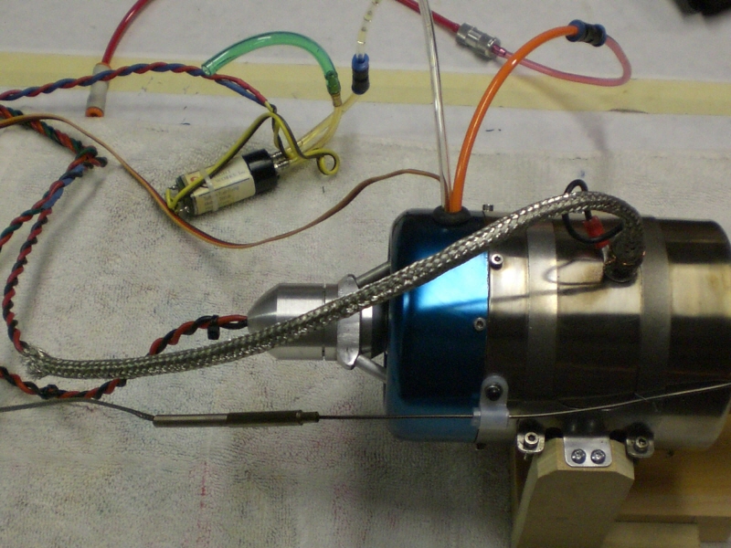

Xairflyer, Mark, BJ and others
Well, after unsuccessful starts in the airplane again, I removed the entire turbine and accessories from the aircraft and set it up on the bench.
I attempted another start and after 'ignition' was displayed, removed the plug wire and Voila! it continued to cycle as normal. (no 64200rpm)
The glow wire does have a lot of EMI coming off it out to 3-4" from the wire while the ignition cycle is on. using an alternate ground wire from the plug to the case and case to the ECU plug ground cable didn't help.
I confirmed this with a scanner/receiver set to around 500khz. I had a strong signal all along the wire 3-4" away back to about 4-5" from the ECU. The ECU had minimal EMI.-so that's good.
So, at least I know what I'm dealing with-EMI
So, I will re-visit the twisted wires, look for shielding to encapsulate the starter and glow wires. It's probably getting right to the hall effect sensor vs the wiring.
not sure why it all started.
I also changed out the glow plug.
Jack

re-twisted all the wires, and used a 3/16" ID ground strap to put around the Plug and ground wires for about 15". I grounded the braided wire to the plug ground and quick disconnect on the plug-It's a brass cap used for remote starts that requires only an 1/8 turn to lock it on.
Now all works well. Still some EMI but only about half as much is seen on my receiver, and this doesn't seem to cause any problems. so far so good.
will have some pics soon
Jack
Jack

#2743
ORIGINAL: vortex00
Here's a couple of pics of my EMI fix on the Plug wire
the other end of shielded wire has been subsequently secured
hopefully I'm back in business
Jack
Jack
Your Turbine is actually the dead-opposite of a JJ-3000. All your tubes come out of the Starboard side of the donk, whereas on a 3000 they all come out the Port side. Not that that's an issue - just an interesting difference.
One thing I do notice in your test-bench pic though is that your RPM sensor lead is running right past the fuel pumps 'hot' leads terminals. I would move it so that it's pretty much in 'fresh air'.
Also noticed that your glow ground lead is under the glowplug itself (?) May not be an issue, but I run mine to where the Turbine is bolted to my steel mounting bars, and on the opposite side to where the RPM lead comes out of the Turbine.
Either way, I'd get that RPM sensor wire as far away from any kind of wiring as possible. That's the one that will pick up any stray EMF, and if you're firing the Turbine up with it right across the fuel-pump contacts, it's not going to be doing you any favours.
I've reconfigured my test bench a couple of times now - and ended up starting with putting the FADEC in the best possible position so that the RPM sensor lead would have a clean run from the can to the FADEC without crossing any other leads.
Might be a bit difficult in an airframe scenario, but you really do need to keep it as far away from any other wiring as possible. It's a fairly sensisitive thing.
BJ
