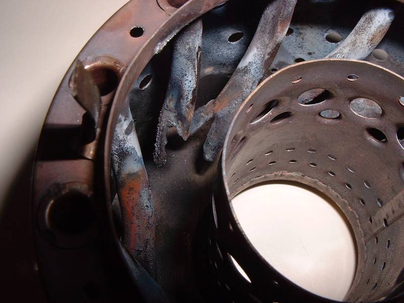

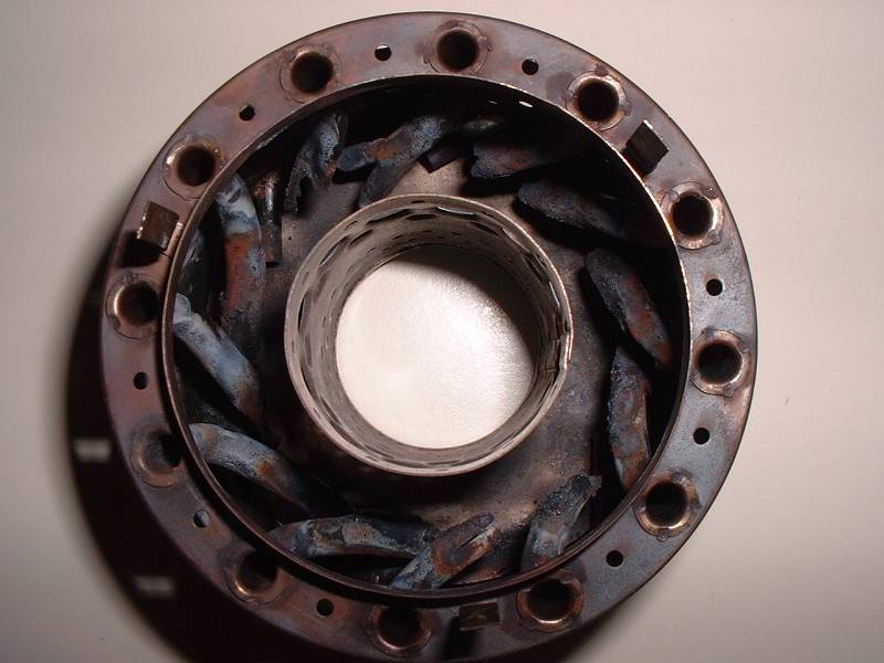

Well my curiosity got the better of me and I opened up the engine to see what may be causing the problem and I'm guessing this is it:
I have put just over 5 hours on this engine Which Joe sent to me back in September S/N 752. I can honestly say that I have never seen temps higher than 700 and then only for a few seconds during a start up or two.
Mike
Mike

You have indentified the heart of your problems, no need for more guess work as your combustion chamber is in need of a replacement or a major repair job. I would have expected to see this type of condition only after say repeated multiple wet starts and with temps *****g out over 800c on running. I'd wonder if they are inconel if you are usually under 700c. A PM to Andy at Anglesey Turbines might give a few suggestions as he will give you an unbiased opinion, as you are not in the UK. He does offer a different CC which I have used on three of mine.
The figures on the exhausts was a very useful comparison since it was on 'like for like' basis (ignoring the CC condition). The usual temps I have recorded are 620c on tick over 45k falling to 565c on max rpm, so I'd expect you to be able to drop 70-80 degrees at max rpm. With other adaptations on one JJ1400 I was able to get 560c at 45k falling to 480c at 160k, much much cooler but thrust was down requiring further work and more restriction to the exhaust. Cooler temps also allowed higher rpms above 160k. Look forward to hearing how you resolve these immediate problems.
Paul

Typical of what I have seen with this combustion chamber.... Ever wonder why reliable, quality engines use inconnel?
This issue was pointed out very early on but certain individuals said we where full of poo...
bygones....
Anyway, the one piece tailcone is the one you want to shorten by 1.5mm for thrust increase. At least for a few hours...[:-]
bygones....Anyway, the one piece tailcone is the one you want to shorten by 1.5mm for thrust increase. At least for a few hours...[:-]

I agree I should get one of Andy's CC's since this is probably why he makes his own. I'm sure Joe will send me a replacement but if it's the same material as this one why bother. My first 1400 had about 2 hours of run time on it and the CC had not started to deteriorate at all so I wonder if they had some that were made with inconel tubes and some that weren't?
Todd,
Once I get the CC replaced I will get another reading then shorten the one piece cone 1.5mm for comparison.
Mike

[quote]
lov2flyrc Date 4/1/2006 1:53:59 AM
#247
Banned
My Feedback: (119)
ORIGINAL: YLF
Thanks for the heads up. I just ordered my single piece from Joe a month ago. Can you measure the diameter of yours? I just measured mine at 45.5 mm.
Todd, any chance of me getting a measurement from your friend who opened theirs up?
Mike
ORIGINAL: EASYTIGER
Before you start cutting, make sure you and Todd are talking about the same tailcone. I have an early single-piece tailcone that has a MUCH smaller opening than my later one piece tailcone, and I don't know if Todd has seen the later one, or if that's what you have. Obviously, there is a problem that is NOT involving the tailcone!
Mike
Also...have you THOUGHT of just sending the engine back to Jetjoe in China? Really, that's the best bet, and shipping is cheap. He has been very good about support for me.
#248
Joined: Oct 2004
Posts: 546
From: Newcastle, UNITED KINGDOM
ORIGINAL: EASYTIGER
ET is spot on suggesting now going for some factory support, as for all the many words here on RCU about Jetjoe he is good at answering emails and I've always found him very easy to deal with good technical support. I'd think it worthwhile just sending back the CC for his inspection, saves on your postage and then US customs thinking you have a new turbine, coming back into the country. If Joe agrees, which is likely, he can cover your costs with some useful spares.
Paul
