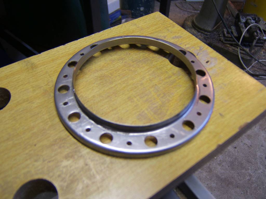

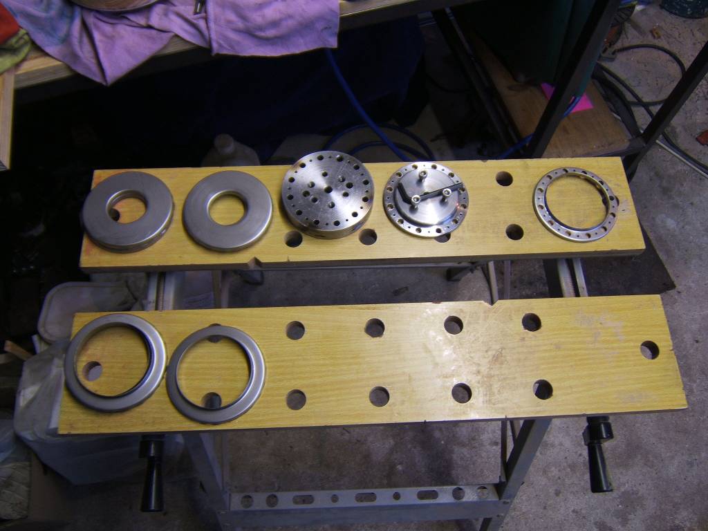

Hi Guys
I`m busy making a new combustion chamber for my JJ 1800 and the press tools have worked very well. I chose to press the end caps out,rather than spinning them on a lathe. I used 0,5 mm 304 grade stainless steel sheeting and it will be TIG welded together,during the assembling process. In the photograph,you`ll see the drilling jig,which made it a lot easier to drill the holes.

Noice
Say....I have exactly the same work-stand as you... freaky.

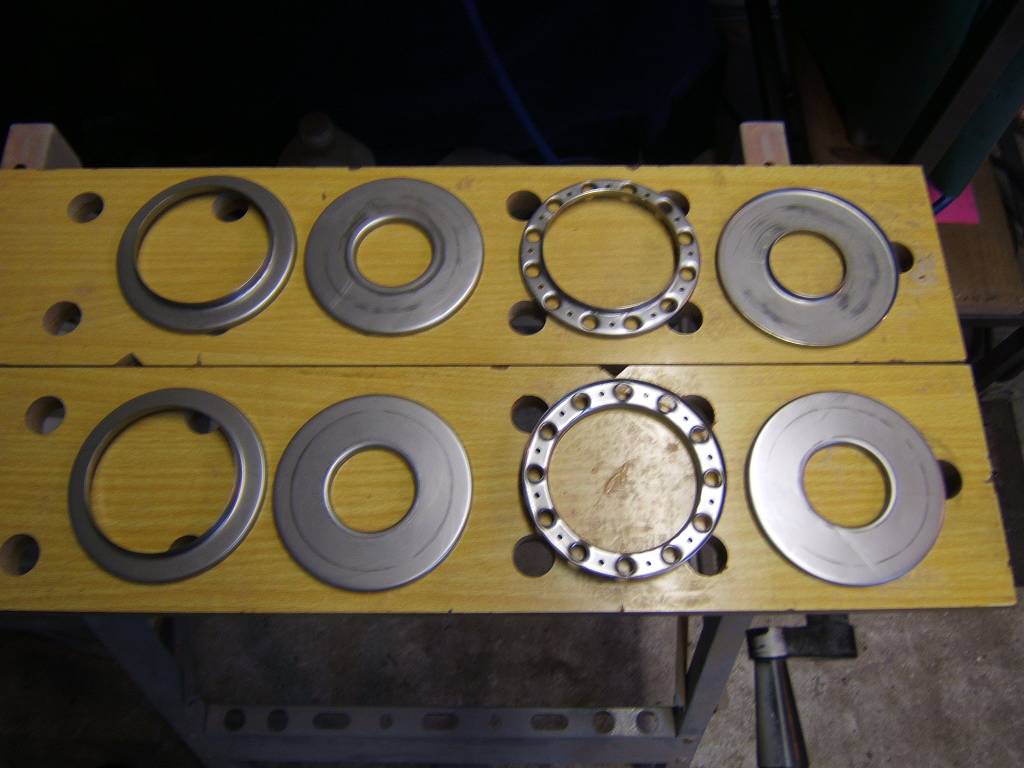

Hi Guys
I just completed the end caps for the combustion chamber and the holes haved been punched to accept the inconel vapourizer sticks. Now the inner and outer wrappers have to be made.
