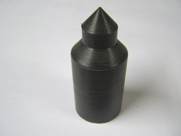

to check starter alignment make a simple tool on a lathe. Make it to to barly slip over front nut. Remover starter motor and push in tool to check alignment. To profile the legs of your starter mount to your front cover turn a piece of 3" pastic pipe to mount front cover. hot glue 3 or 4 pieces of emery cloth to front cover and spin in lathe. hold nose of tool in chuck with starter base on tool legs facing cover. sand legs agaist spinning front cover. mount cover on motor. remove emery cloth and put masking tape on where legs meet. Put tool through starter mount. slip nose of tool over nut and trace legs with fine pen. center punch with sping loaded punch .
after mounting slip in tool. It should slide easy over front nut.
if it is off some you can reverse the tool to "tweak " the front cover.

Thanks for the info and drawings Idleup.
I started to look at doing what DW crash suggested and when I had it all apart I thought why not check the way it is already with the square method.
So i put the housing on a flat surface with a square to the side/behind and slowly rotated it until I identified which way it was off, I then gave it a little "tweak" and checked again.
I now have it perfectly square but it may still be off center, but this method works really well to get it vertical.
Going to turn up a dummy motor with a point and then slide it through the housing and see if it meets with the center of the spinner nut. If not then I will have to re-drill using Idleups method I think.
Thanks again all the different suggestions got me thinking in the right direction.

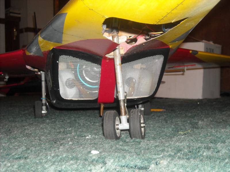

Old 05-27-2008 | 04:28 PM
  #1711
My Feedback: (10)
Joined: May 2004
Posts: 548
Received 4 Likes on 3 Posts
From: Fayetteville, NC
Default RE: JetJoe OWNERS thread
Where did you buy your engine? I have one in a Topgun Mig29 and it's doing well.
Steve

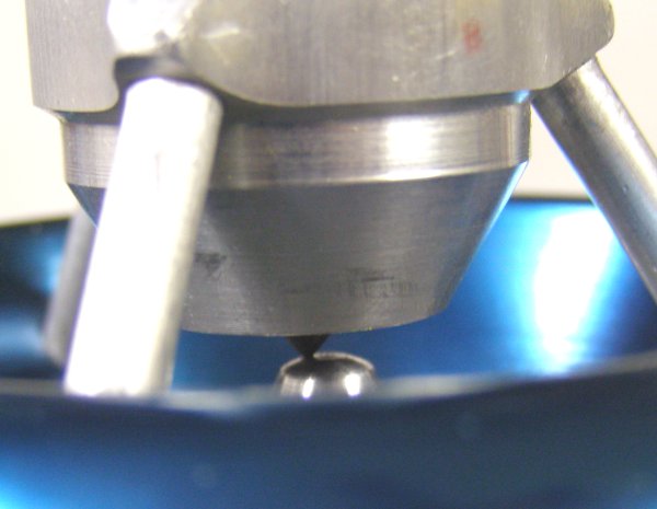

Made up a tool last last similar to what idelup suggested, I went with a turned point so I could see exactly how it lined up.
My starter housing was vertical but offset one way as I suspected. see picture. I was able then to tweak (bend, push, hammer) it until I got the point lining up in the middle of the spinner nut.
Made the tool 24.3mm dia and is a nice sliding fit in the housing. The small diameter is 14mm to fit through the hole, other dimensions are not that critical.
Tried my starter and it lines up lovely now, new problem was it was too far in as when I tightened up the starter bullet cover it pushed the motor in too far, (I think the new motor I have the bendix is further out on the starter shaft) ended up fitting a 3mm washer under each of the housing legs and then had to align it again.
Have it all fitted in again and might get to fire it up tonight.

Fired it up last night, still cut at 25K then realised I had fitted the fuel valve plug on the gas valve pins after correcting that he fired up perfect.
My big concern with getting the starter alignment perfect was to stop it jamming on the turbine nut and effectivily becoming a generator and blowing the ecu.
Then I realised when looking through the ecu manual, the ecu shuts the power to the motor (at 30k in my case) and then applies a brake (reverse) so that would release it from the spinner cone, so long of course that the starter is the correct distance back.

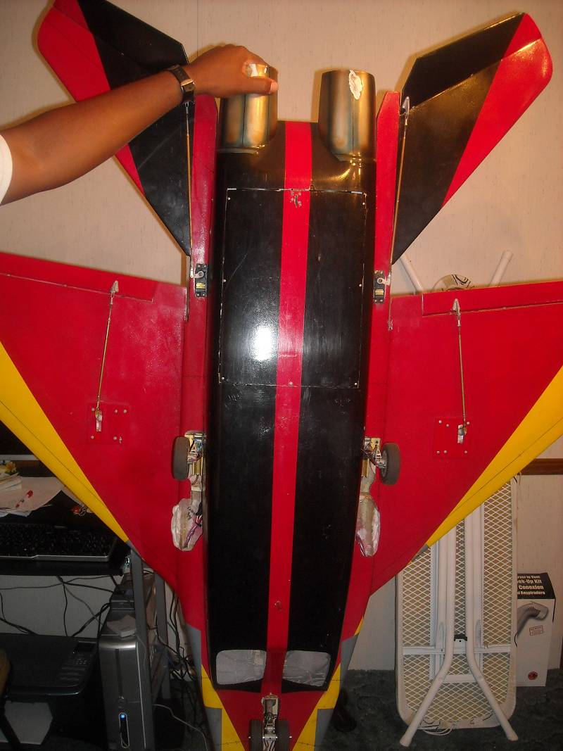

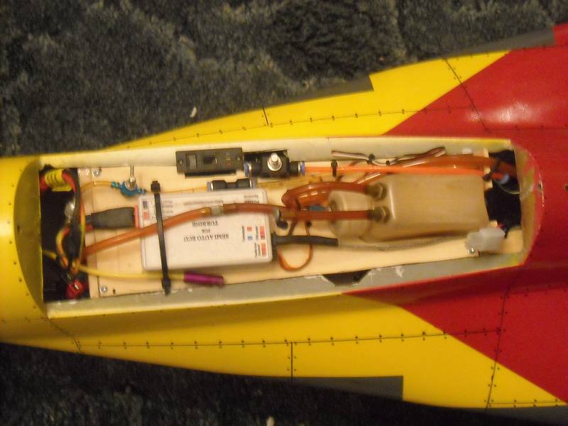

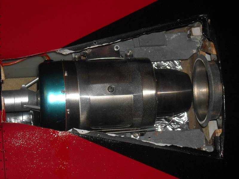

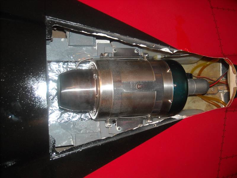

Here are some pictures of my Topgun Mig 29n powered by a JJ 1800. It flys awsome with power to spare. It's 20 lbs dry .
Steve
