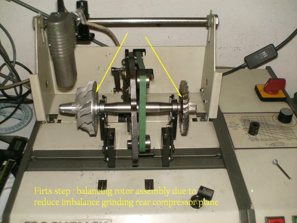

like jetcat and other
when i balance first only rotor assembly i grind rear compressor plane
after i balance all assembled engine grinding between compressor blade
like this P70 JETCAT example

i found this in jetcat 160 and other engine that i repaired
but NEVER on the blade or at the blade base
i balance the rotor assembly first due to obtain low imbalance then i finish the engine assembled
the material to grind after is very is little
jetcat 160 first maintenance

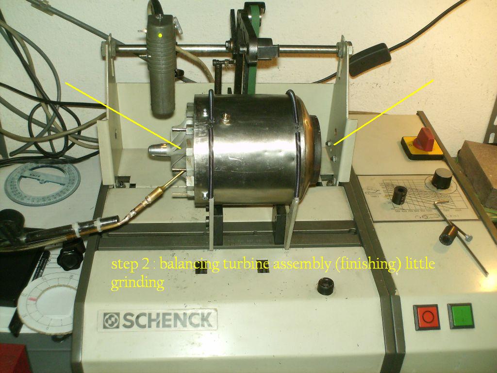

Hi Guys,
Essentially this is the only real way to do it, material removed from between the compressor blades like this is very common and an accepted practice, balancing engines as an assembly or "core" is a good way to get a very good result, although Wren have been able to get good results with their engines using the rotor only method. An experienced balancer will know where to remove material so as to not weaken the assembly, it's better to spread the mass removal over a larger area rather than a large mass from a small area. All the better engine manufacturers use this technique, Jet-Cat, Jet Central, Kingtech, AMT, Behotec etc...the larger the diameter of mass removal the less material has to be removed compared to closer to the hub.
There's no need to disassemble the rotor after balancing which allows the recorded result to not be disturbed. A "rotor only" balance requires the assembly to be disassembled thus disturbing the result. A very good balance job can be obtained using this technique. The method Chrigui is using is spot on..!

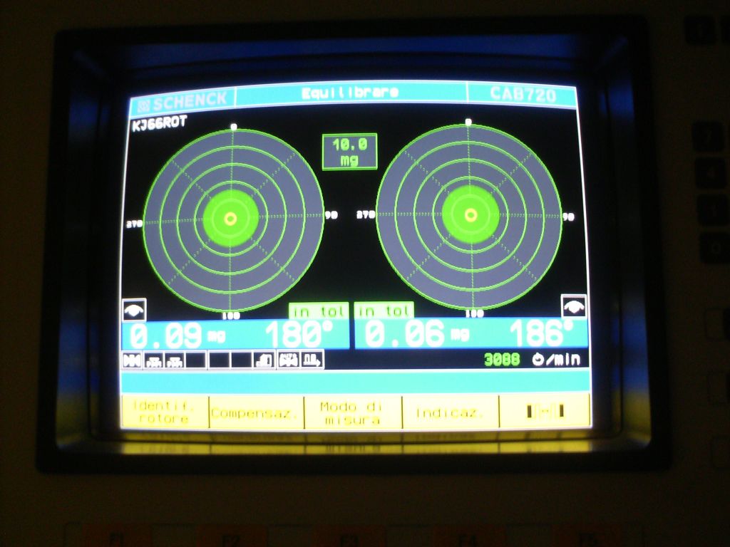

example
First step pic : balancing only rotor to eliminate big imbalance
Second step pic : balancing all assembled engine to eliminate little imbalance

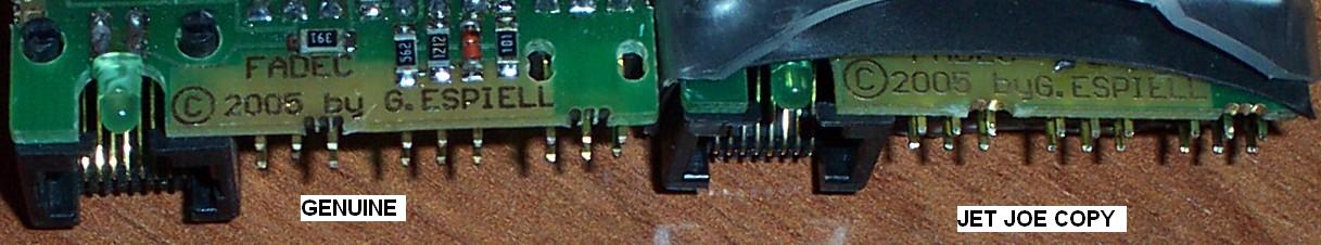

Hi,
Just la little "heads up" for JJ costumers. We have received several ecus for repair sold by JJ as "genuine", but in fact they are copies of our model 2005. They had took seriously the copy thing, copied my name, scanned our company sticker, etc, but nobody is perfect nor is Mr. Jeff Wong, (AKA Joe) and his gang. In order to help you in to recognize the fake ecus, below you have a couple of pictures that you can check before sending your ecu to us, that of course, will not be serviced.
Externally the differences are:
Thick transparent shrink wrap.
Sticker printed by a inkjet printer.
Copyright readings misplaced. See pictures below, this is the easiest detail to check.
There are more internal differences that is not possible to check without removing the shrink wrap, but some easy to check are:
In JJ copy the components are hand soldered, ours are machine soldered
Capacitors in JJ are of black color, ours blue.
No serial number printed on the PCB on JJ copy.
Datecode on components in genuine ecus are of 2005 (0503) , on copies are dates from 2006. We manufactured this model only in 2005, so it is impossible to have any of our ecus with datecodes older than 2005.
Easy to see the difference, on the copied one there is no space between the "y" and the "G" in "by G.Espiell"
On top side, in the original is possible to see the second zero of the "2005", in the copy only the "5" is visible.
