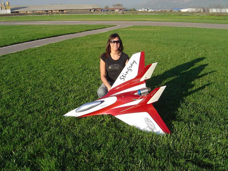

That stingray looks like a fast machine to me, i know that u have some videos to share with the jet comunity so why don´t you upload them here ? one of those high speed fly by will be nice [sm=shades_smile.gif]
