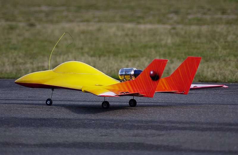

Well, here's how mine sits. Mostly level and maybe slightly nose low, probably level with the wings on. Notice the trailing arm nose gear unit. Steers perfect, no taxi, takeoff or landing issues. Less than half stick to rotate without smoke, something over half with smoke tanks full.
No, the mains don't lift with braking cause they're too busy kicking up a large dust cloud from the lakebed when I use the brakes. A 17 mile headwind is not a heavy wind and we do get tons of gusts and crosswinds. Besides, the wing doesn't know the wind is blowing. You still have to make good on the correct landing speed at touch down. And well, the TopCat is sort of a delta with with a stab and accounts for 850 of those other landings.
BTW, every Roo I've seen with a straight strut for the nose gear has trouble with steering.

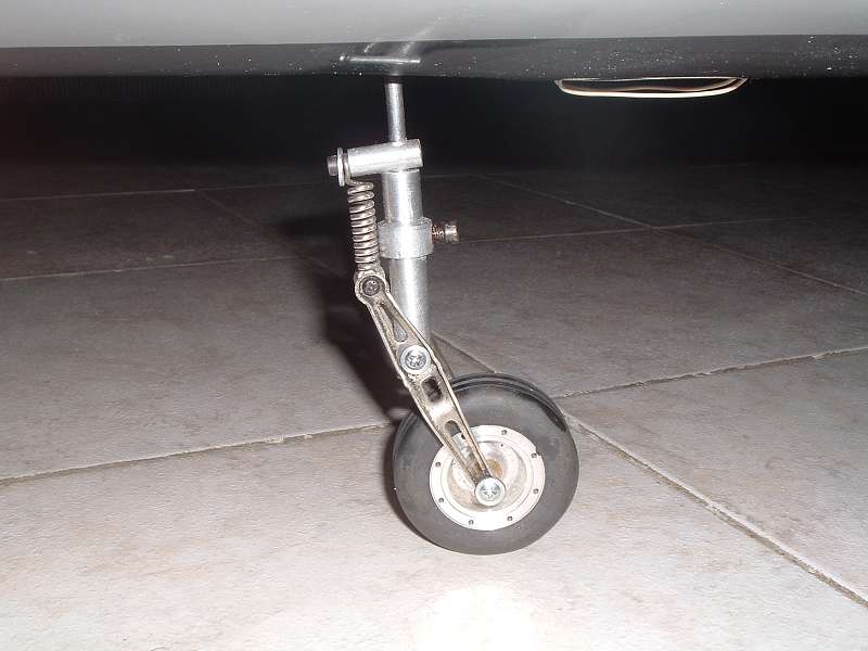

Ok. here it is the homemade strut, works very well althought it is somewhat ugly.. spent 15$ on it
and it never breaked...wheels and wire rear struts by bvm... a little more expensive, but they work quite well too.
Enrique
Enrique

Hello All,
Attached is the photo of my gear setup.
Today I have recieved the Eurokit parcel, so I will install a new trailing nosegear and hopefully it helps.
BR,
Jussi
BR,
Jussi
My Feedback: (162)
It looks like your nosegear is bent forward. That along with a semi flexible strut will make it very sensitive. The strut should be straight in line with the strut mount. I also have dual rates set for steering/rudders. I use minimal throw for takeoffs and landings. I have the spring airs in my kangaroo and don't have any problem with takeoffs and my brakes are on my down elevator and they work fine.

I also changed the 4mm wire nose to eurokit nose strut.
On the first flight it tracked OK in the start, but I managed to land 1m wide of our tarmac, to guite heavy gravel (first jet flight of the season...). The nose strut lower part broke as this was cast aluminium and about 7mm in dia. At this state I still has the 4mm wires and struts in the mains. The mains also bent back heavily.
Then I made a new lower part to the nose from my earlier Yellow A-4 main strut and changed from 4mm to 5mm wire for mains crank/strut fix. After this the plane has been trouble free in 4 flights with 90 deg sidewind.
But... My friend has quite a similar setup and he still has problems with tracking. He has even sturdier mains now, but with robart tires and had problems with tracking. His nose setup also has a bit less lag. So I will advice him to make two changes, that should help.
- More lag to the nose steering. With lag I mean the distance between the steering rotation axis to wheel rotation axis.
- Stiffer, low profile tires to the main, so that the rubber will not flex under the weight.
We also use harder tire in the nose and softer pair in the mains to prevent oversteering. (Note! Hitech Formula one tire selection here!!)

Finally my Roo track straight now. For the time being anyhow.
I changed the mains wire from 4mm to 5mm with struts and robart tires to eurokit ones. I also filled the eurokit tires inside cavity with foam to make them sturdier in compression, as we saw marks in the sides of the robarts, that flex sideways a lot more.

Good to hear that your Roo is fixed.. about the tires softness I mostly use bvm wheels, and sometimes the softer eurokit tires... I didn't found a difference at all in handling between them, but seems that the bvm can handle more abuse. that's why I prefer them.
p.s. I bet that the people at your club started saying that you finally learned to take off a plane!
BR, Enrique
