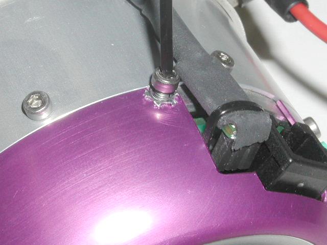

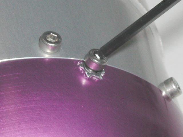

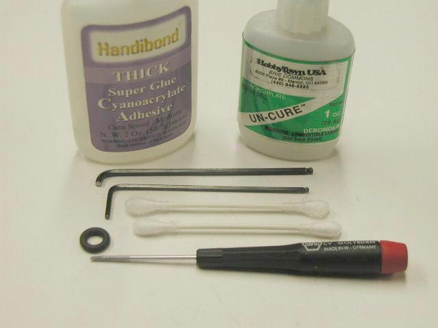

Folks,
Thought I'd document the starter Oring replacement I just performed on my JetCat P60. I'm not sure how other models are but I do know this is how I replaced mine. Feel free to add any comments or hints and tips YOU may have. I'm sure this is not the "last word".
Dave Rigotti
The pictures will follow along from left to right.
I gathered a 2mm hex wrench, thick CA (cyano for our English friends), debonder, a few cotton swabs, a small screwdriver, and a modified 2 1/2mm hex wrench. I cut off the short arm pretty close to the bend. You'll see why......
Remove the 3 cowl screws with the 2mm wrench being careful not to lose the star washers. Slide the cowl off the turbine housing.
Remove the 2 starter housing screws with the modified 2 1/2mm wrench. The data buss socket covers one screw as shown. Be careful not to damage the turbine housing by banging the wrench into it.

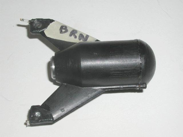

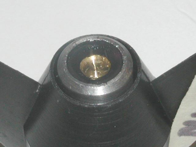

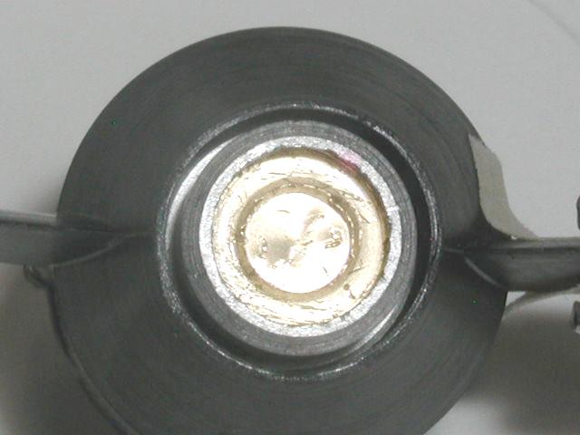

Next we'll remove the starter housing by unsoldering the two wires from it. Label one leg with the matching color wire first!
Gently wiggle it out from the turbine housing
I used a soldering aid with 2 alligator clips on it to hold the starter housing vertical.
I dribbled some debonder into the Oring cavity and waited a few minutes for it to do its job.
Dig out the old Oring as carefully as you can with a small screwdriver or whatever you feel comfortable with.
Squirt additional debonder into the cavity and work out any fragments that are left.
A final cleaning with a cotton swab or two will leave no trace of the old Oring. I used a short blast of bottled air to assure all was clean.

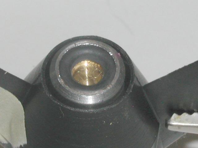

To install the new Oring apply a single drop of thick CA (cyano) to the Oring seat and install the new Oring. I squished it in on the opposite side I applied the CA to allow the most time to get it seated.
Resolder the wires to the housing and reinstall it using the 2 1/2mm modified wrench.
Install the cowl to complete the Oring replacement.
Be careful not to get any material into the turbine itself.
BTW...It is a 6mm ID by 3mm thick. Probably 70 duro
