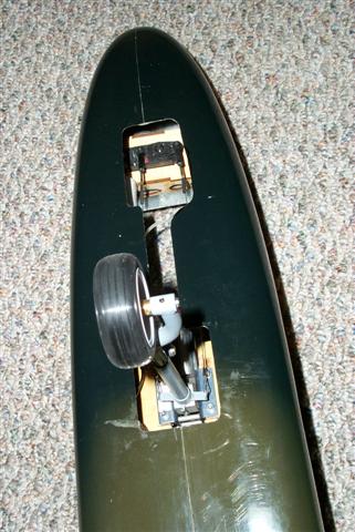

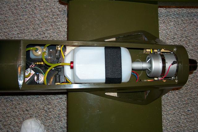

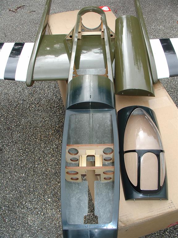

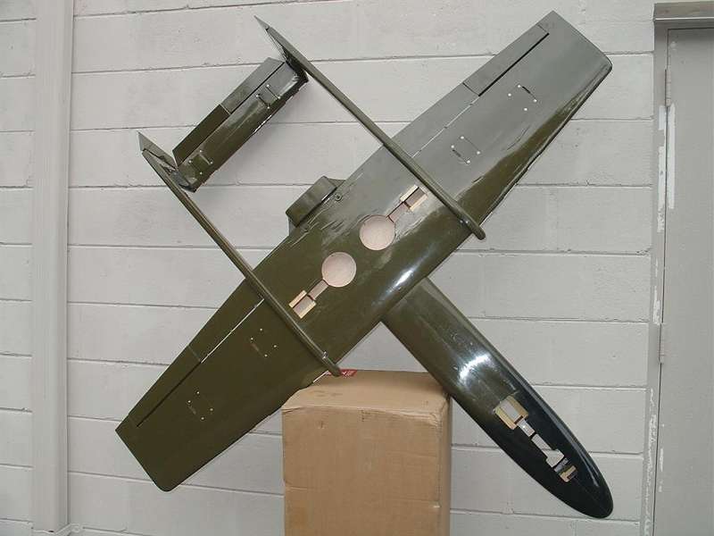

Thought you guys might like to see a few pics of the new A-10X. I am currently building one, powered by an Artes Bee, to test flight performance and compile the manual. So far, I am quite impressed with the quality. With the exception of some poor glue joints to the fuse formers (which will be corrected on production), the kit is very well made and should be an excellent grass field capable, trainer type aircraft (or, every day beater ). Airframe consits of a fiberglass fuse and booms, built-up wings, center section and stab. Assembly is minimal, really just a matter gear, electronics and engine installation... The kit is designed around the 54 class engines, it is not possible to fit a larger can (ie: KJ66 size) in the mounts. The A-10X will be available in three color schemes and will also be offered as a combo package including retracts, wheels, air support, fuel tank ect...We are expecting delivery of the A-10X in early August.
BTW, not seen in these images but included is a belly pan which has the wheel wells molded into it....
Todd

Looks nice Todd and hope that all goes well for you. In the photos the seam lines are pretty apparent and the Monokote work on the underside of the wing needs some attention too.. But it's just me being picky . What retracts is the bird built for?

I'll assume you mean the fuse seam lines (painted in the mold fuse)? No seams seen in the covering as they are done at the leading/trailing edge.... As for the loose covering, anyone who lives in florida knows this is typical for an out of the box ARF, especially in dark colors... The heat tends to sag the covering until it has been heated and rubbed down good. Even then, you have to keep shrinking it back up during our hot summer days (our flying season is oct thru may ).
Retracts... they are also supplied by RCARF and I have no yet received a set. I have ordered a set of Robarts new spring-air style gear to test out in this plane along with as set of the robart 550s to see which will be the best for this application. Will report on their performance as well if you are curious...

Yep I was speaking of the seam lines on the fuselage. But it still looks great and understand about the Monokote. I live in Kentucky and experience the same problem here with the sagging. I'm just being a stinker held hostage at the office and waiting for the weekend to get some flying in. Yes I am interested and looking forward to your report.

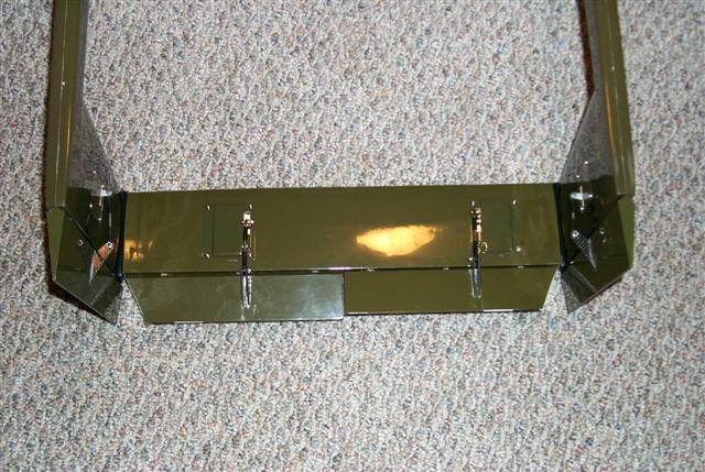

Several have asked for more images of the plane, Detail shots.... so, while your waiting for flight reports, I thought I would throw these up...
Todd

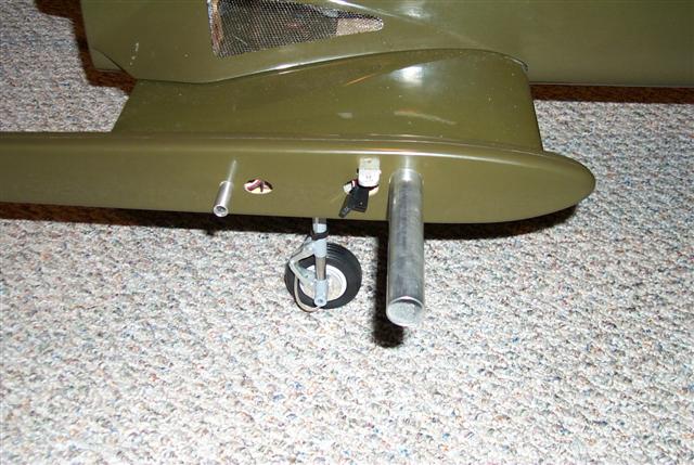

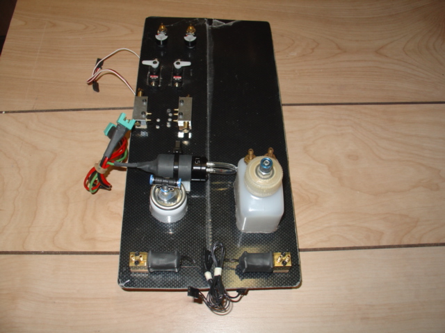

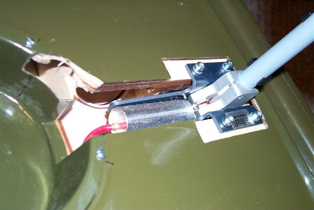

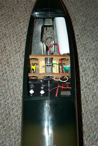

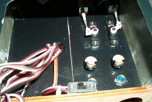

Only "Mods" made was addition of the "FOD" screen to the intakes and the systems tray for a clean install. In order to make the tray easy to install/remove, I split the tray down the middle and hinged it with CA hinges. This allows the tray to fold as it is installed.
Retracts used where Robart 550 series with 7/16 struts since I was not able to get the "Combo Package" at the time of build. I also used a Dubro 50oz tank, the included fiberglass tank was also not ready at time of delivery.

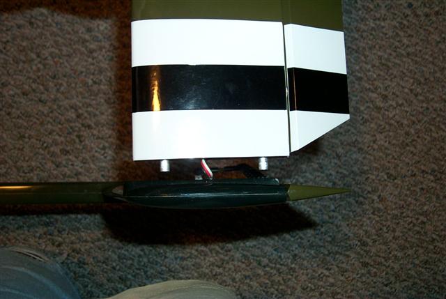

As you can see, the linkage is way overkill for this plane (servos too) but I plan to wring this thing out to the extremes... Looking to get an idea of this plane full capabilities. If I cant break it, no one will Lets hope the rain holds out this weekend!
