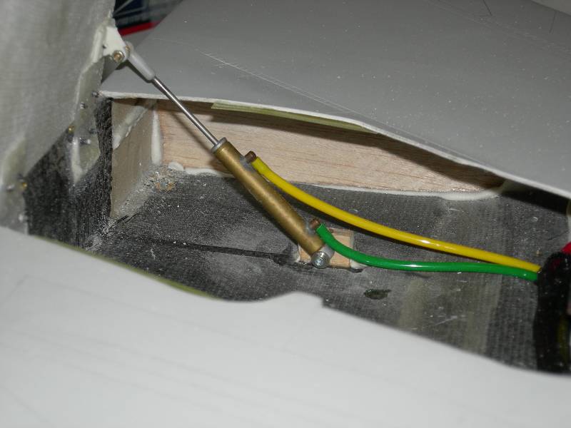

ORIGINAL: ravill
I have to say that I think SM got the door cylinder lengths wrong. I think the nose needed a long cylinder and the mains could have used the short cylinder. I've racked my brain to make them work perfect, but they are just barely closing and I think that in the sky they will not have enough force to stay shut. I'm hoping for a boundry layer effect!!
I will maiden my F-4, likely next week. I'll be posting some video.
Raf
The nose does need a longer cylinder. I replaced the SM cylinder with a BVM cylinder I had on hand. The cylinder for the inner main doors work, but just barely. I had to fiddle with mine, but finally got a decent lock and sufficient clearance when the doors are open. I installed them in the same configuration that the CARF people are using on the new Lightning kit. I did also reinforce the root with carbon fiber cloth on the inside of the gear bay, as you cannot afford a lot of flex in the hinge area where the door cylinder connects. I was actually getting some cracking of the root at the point where it met the bottom surface of the wing. The bead of glue they ran down the root area for stiffening just wasn't getting the job done.

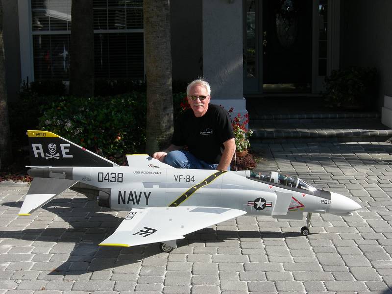

OK, she is done. Rhino started up without a hitch on the test run today and I hope to have a test flight next weekend if the weather cooperates.
Came out just a shade over 34 pounds

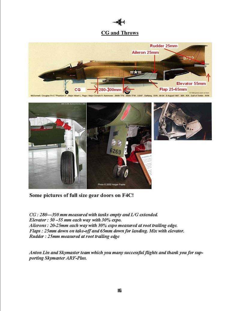

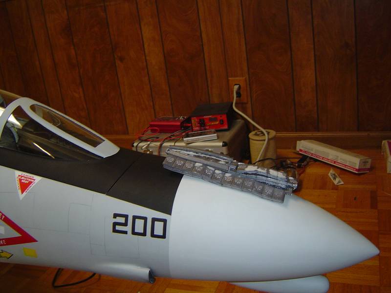

Pilot28, Your phantom looks great!!
My F-4 is ready to maiden. She's balanced an checked. I had to add 30 oz to the nose to get her to balance at 280mm. []
My max elevator deflection is 55mm, as per the instructions. Do you guys think that is enough? David?

Raf,
My experience would indicate that 280 is wayyy nose heavy. You'll need every bit of that elevator to bring it around at speed, and you have to keep your speed up in turns. Seriously, move it back to 290, or 285 at least. I'm going to measure my throws later today and will post.
David S

Keith & Raf,
I measured my throws today and suggest you go with the measurements reccomended by SkyMaster and adjust according to your feel. Mine were within 10% of their throws give or take adjusted to my feel. If you move your cg back you won't need as much elevator. I use low medium and high rates, with high at their full rate and med backed off a bit, which has turned out to be where I fly most. Ailerons I am on the high side a bit of their throws, elevator a bit on the low side. My flaps are more on both settings, TO & Landing

Dave,
Thanks for the update. I moved the CG back to 290mm and I wanted to leave the elevators at 55mm. To get any more I was going to have to shave the side of the fuse. It sounds like 55 will be just fine. I also set up my flaps as you did.
I fired her up and taxied her down my street! Nothing like the neighbors looking at you with the mixed *** and COOL Looks!!
I was also delighted to find that the elevators did not get that hot at low to medium throttle. I only "burped" her to full throttle for a second as I didn't want to piss off my neighbors too much!!
Can't wait to maiden!!
