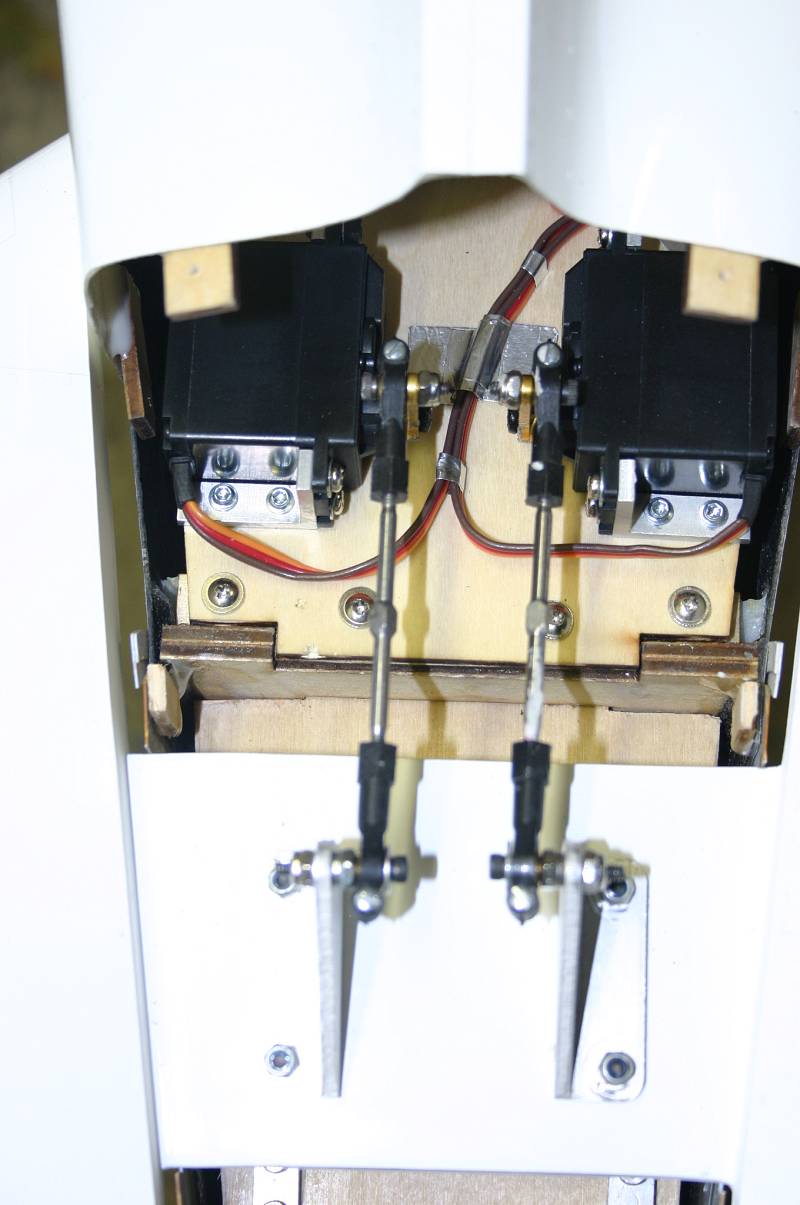

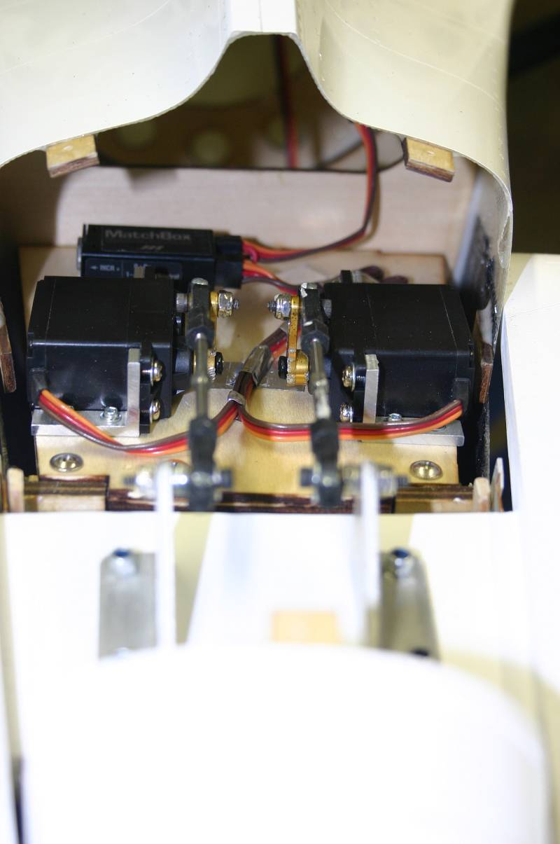

as for the eagletree unit, i have no reason to think it is not accurate .. on the king cat i had it up to i believe like 16 or 17 Gs in a tight turn. I think a good way to see how accurate it is ( or if its even close) would be to take video of a plane doing a nice symmetrical loop at a set speed (can be done with a speed limiter on the ECU) .. do the math on the speed / vs loop diameter and see if the reading off of the eagletree is in the ballpark ....
I would not worry about the whole G thing on the planes you fly however …. Foam makes for very light wing loadings
Voy
#195
My Feedback: (61)
Still waiting on the reversed one [
] Horizon is a little late.
Could not wait any longer so i decided to use the matchbox. I'm actually glad as after going through 8 new 8611a I just got, i could not match two with the same throw and spline neutral point.
Matchbox saved the day.
Adil
Adil
#196
nice install, but i would not personally feel safe with the match box on the 2 servos for the elevator .. If i was to use a matchbox, i would put it behind a power box or some sort of power bus .. im asuming those are 8611 servos , and I know they are impossible to get matched up, so you do need a match box ... or how about a pair of Hitec 5955 servos ? didn't you hve a bunch of those ? anyway, thats just me and my paranoia ..
looking good man ..
Voy
looking good man ..
Voy
#198
My Feedback: (61)
ORIGINAL: wojtek
looking good man ..
Voy
looking good man ..
Voy
Dude, You read my mind..
I used the Hitecs on my flaps and all it took was 2 seconds on the programmer to reverse one. They perfectly matched and work flawlessly.
I continuously ran the servos (8611A's) for 10 minutes with a load on the elevator and they did not heat up or anything.
I tried different servo locations with one longer rod but just was not getting the loads right.
I did not close out the back for this reason. I don't feel comfortable with the match box on elevators. I'll try out the reversed servo when it arrives or it is time for the Hitecs.
Adil
#199
heres the problem i have found with matching 8611 servos ... if you get them centered to eachother, the end points will slightly be off .. if you adjust this with a match box, and now you have the center and enpoints to match, i have found that the travel "curves" might still varry through the transitions between center and the end poinits ... and on top of that i have also found that speeds might slightly vary also between the 2 servos ... great servo for a single surface, but not for ganging up ..
Voy
Voy
