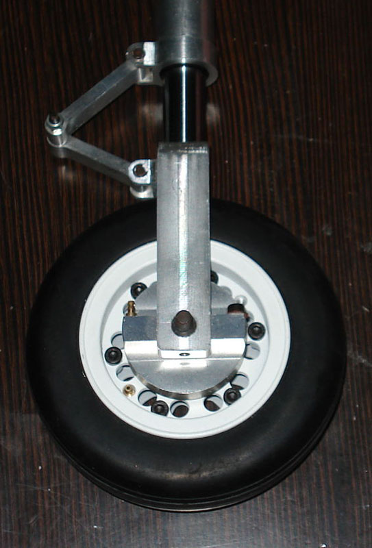

Here are some pics of the landing gear... Very soft hidraulic oleo legs, special for those hard landings...
Michel

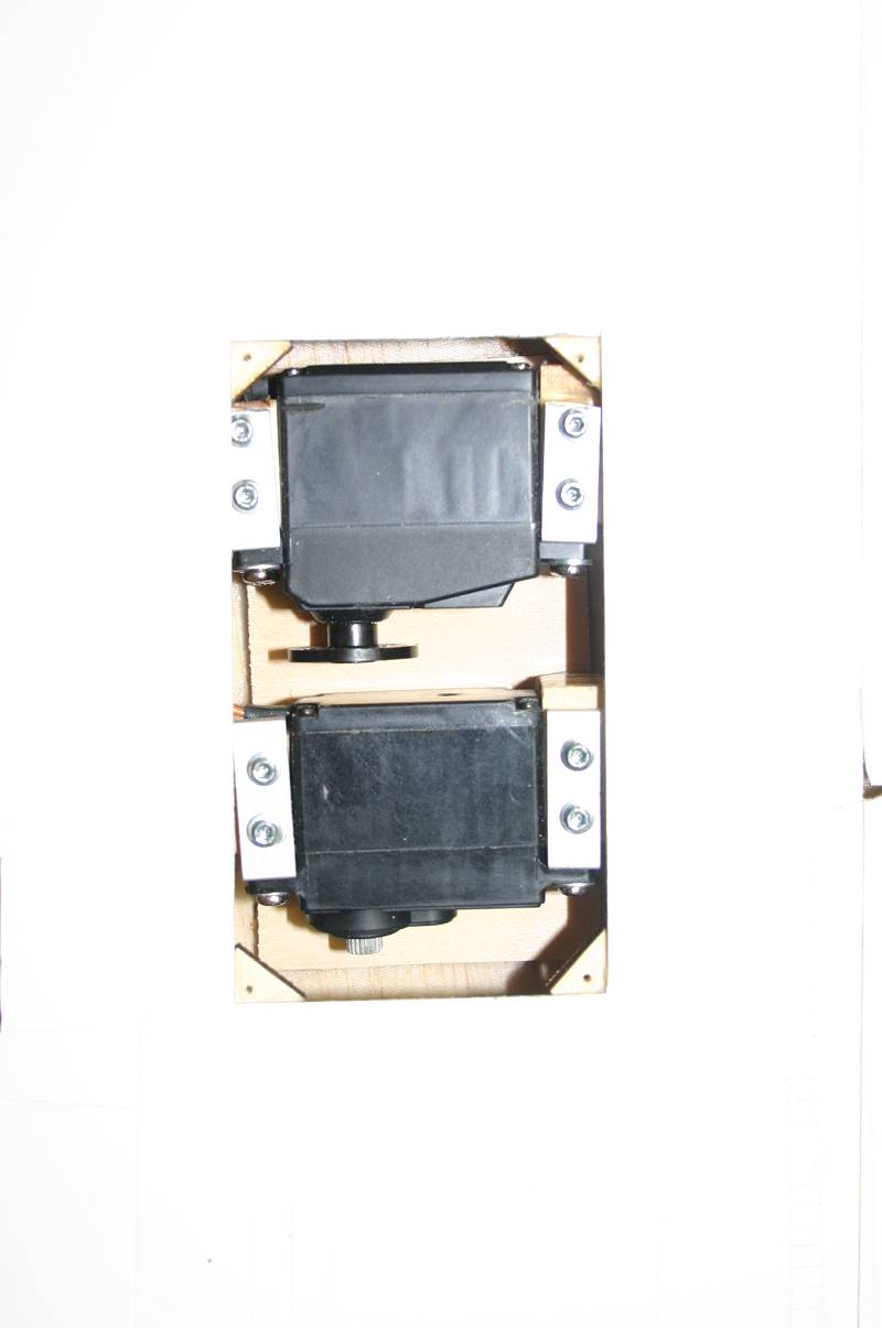

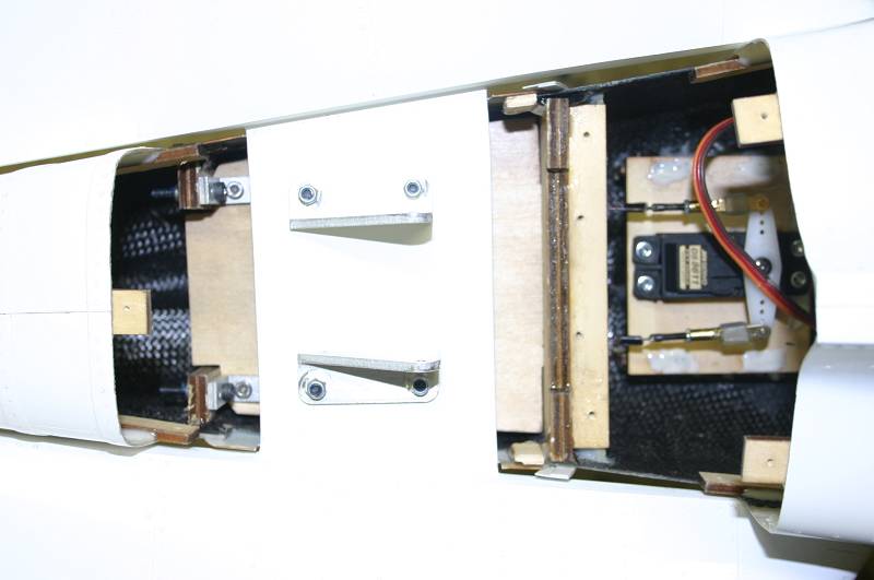

I got a couple of hours of work done last evening. I have to say that due to the large size of the airframe, there is so much room to work. The tail group is pretty much done. I just have to bolt 2 8611's for the stab. I'm waiting for a reversed one to arrive (LHS order).
The wings have a lot of room for standard size servos. I glued a 1/8 ply plate before mounting the servo blocks and there is more than enough room. I'm going with JR 2721 for the flaps and Futaba 3152 for the ailerons.
You will notice that the entire tail section is CF laminated with 1/4 ply formers. Everything lined up perfectly and works slop free.
Tonight I'll work on the fuel tanks and servo wiring... I'll post the acutal capacity of the fuel tanks as well later....
Adil

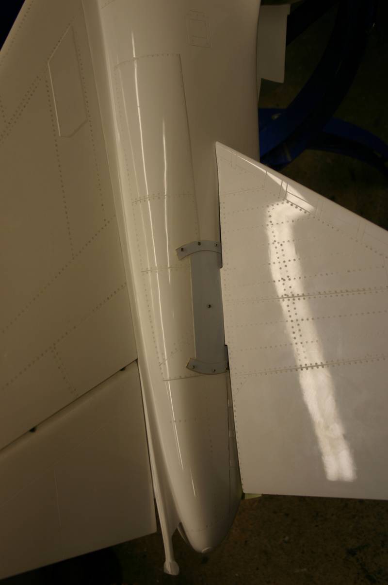

great pix of how the stab is installed!!
are all the rudder formers pre-installed? I'm sure the next pix will show where the stab servos go. hopefully relatively close to the stab.

The air adjustable nose struts are made by Matrix Machine, Rochester NY. I'm sure that John Moselello would be able to machine a nose strut for this Rhino also.

Yep. All the formers and the CF is preinstalled. If you look closely, both the vertical CF rods are running in phenolic tubes which are glued in the 1/4 formers (slotted). The best part is that all the removable formers (stabs) and stab servo formers are 1/4 ply which slide into slotted formers in the front and held down in the back with bolts / screws. Very nice and thoughtful set up. The stab servos mount on the 1/4 ply plate right in front of the stab so you can make the linkage between 2-4" at the most.

The retract mounting is not full scale and by looking at the video, it seems like it is set up for ease of rotating etc.
I have been in conversations with John Mesollela (Matrix Machining) and he is willing to make me a adjustable nose strut (He is currently updating my F-14 gear as is).
