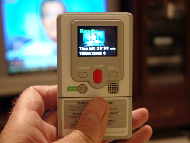

I got my CVS DV cam working today. The part of the process I found confusing is the hardware hack v3 on boot up of the camera at http://camerahacks.10.forumer.com/viewtopic.php?t=1577 .
Once you are successful with getting the cam to boot up in the preview mode without status or time info you are done with that process. But the confusing part is that the NEXT TIME you boot the camera it will go through its NORMAL CVS boot screen, there is NO indication at this point that the hack was done. But the hack is done and you are ready to connect it to your computer and unlock it with OPS 13. If it unlocks you are good to go.
I put the USB port on the side of the cam as you can see below. The USB connector came off some old computer parts I had laying around and the USB cable was $2 at Delta Computers in Atlanta. You will also need the XviD Codec; found here http://www.xvidmovies.com/codec/ to view the videos with Windows Media Player 10.

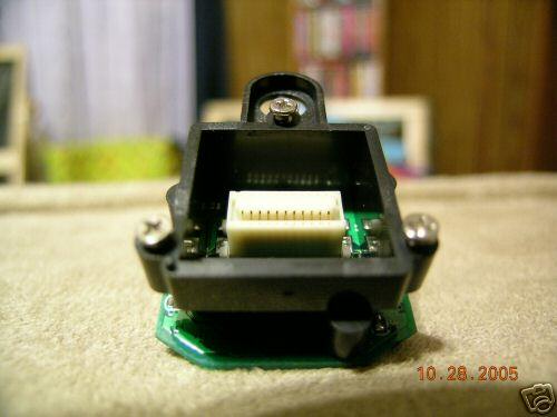

Anyone tried separating the camera head from the main board and attaching it with a cable? if it can be done, it'd be easy to stick one of these in a chubby looking dummy centreline tank!
I'm planning try it when mine get her (thanks again Ben). I think they're still stuck in customs though... [] I saw these pictures on Ebay; it looks doable if the connector can be found in an electronics catalogue somewhere...
Kelly
