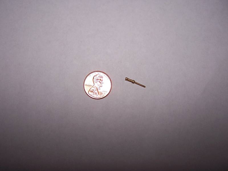

Kelly--it does look simple enough---I count 11 pins in your pic. I have ample access to edge connectors with ribbon cables attached. I'll have to look around and see what I come up with. Pin count doesn't concern me--It's the spacing that matters. You can take a 20 pin edge connector and cut it down to 11 very easily. (I've had to do this at work when we didn't have the right pin count ribbon cable.) Since it appears that you will need to have both male and female ends---A trip to the electronics store for pins may be in order as ribbon cables w/edge connectors have both ends gendered female. I have plenty of these small gold plated pins that can be soldered to a wire or cut and inserted into a female edge connector to conver it to male. Penny is for size comparison. Look for sales of these cameras to explode within our ranks when the right cable is found!!! When I get mine I'll see what I can do.
Kevin

Here's just one of the many cool cables I've collected over the years....This is a shielded USB to 5 pin edge connector cable. Makes it easy to add the USB cable to these cameras. Has anyone converted one to Fire Wire---I've got lots of those too.
