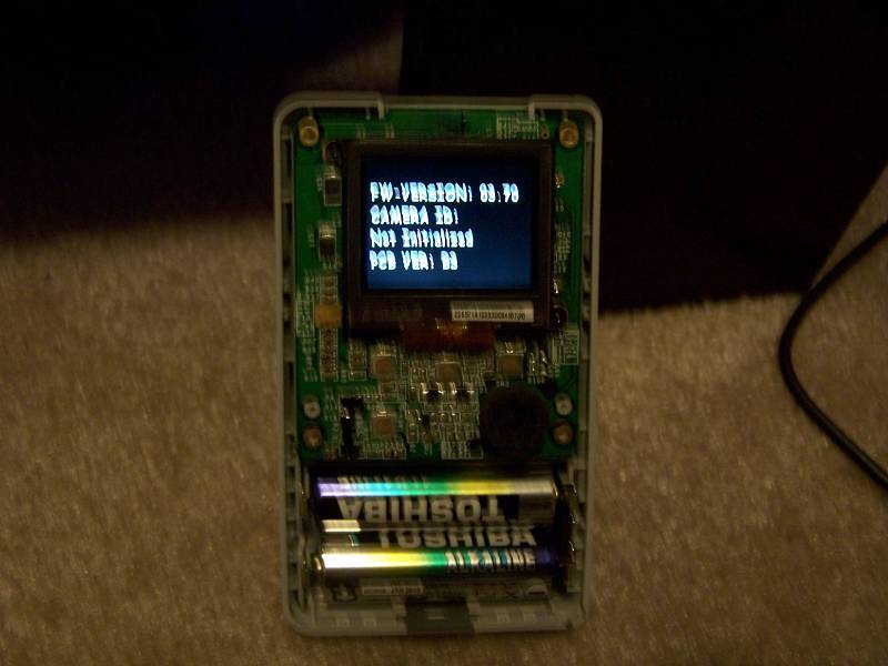

#217
My Feedback: (85)
Man--I've been shorting the resistor out at least 100 times....I've gotten everything from jibberish numbers to a blank screen. I can't get the camera to unlock. Opening the camera is fine but unlocking has proven to be a (*&%##^^*(^$#$$!!!!!!.[:@]
What am I doing wrong?? After you get the blank screen do you attempt to unlock then or do you power down and then attempt to unlock?? When will the camera say "not initialized"?? Are you shorting the left side of the resistor or right???
Kevin
Kevin

#220
My Feedback: (85)
Looks like I fried this one....I know i tried at least a couple of hundred times...I know that I also didn't touch anything else that I shouldn't have---This one was just tired of being screwed with I guess. I got the blank screen as described in the link but the camera never would unlock.
Well--I've got two more to try---We'll see what happens.
Kevin
Kevin

#222
My Feedback: (85)
Now Ben.....Don't be so quick to martyr yourself on MY behalf as the camera you sent me is a version 3.40!!!!
I'm on camera #2 and still haven't hacked it....Am I too slow or what??? I touch the resistor right after the beep and I have successfully brought up the blank screen but no unlock....[:@]
Kevin

#224
My Feedback: (85)
EUREKA!!! I FINALLY got it!!! This second camera only took about a dozen tries. Here's what the screen looks like when you've got it in the first photo. (I was so proud to get it unlocked that the pic is a little blurry)
The second pic shows my hacking wire....Just a male pin from a servo extension wire. No loose wire strands to worry about touching something in the wrong way, shorting out the wrong component.
