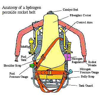

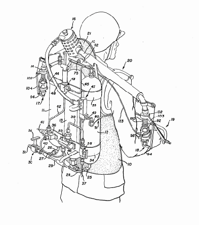

The engines are angled out away from the pilot. This should give stability like a dihedral wing does for a plane, same as the successful bell rocketpack below, and will help keep the heat off of him... I also think this guy is "out there" with this jetpack, but only because of our own distrust in the engines reliability.. Let's just say- if the engine reliability were not a factor, what would keep it from working any different than the very flyable bell pack, which is about the same set-up except for propulsion????? as I said before I think it's dumb to announced it and try to sell it before it's proven, it does seem very scammy.. but other than engine reliability, and forget fuel consumption/ flt time.. why would it not work????? .. Is the engine reliability factor the only reason we think it is bs... No 100mph at 10,000 ft bull, but just simple hover/flt just like the bell pack.. and yes, even if it does work and engines were no worry, it will still be very dangerous.. Let's have it all you naysaying engineers, why will it fail to work other than motor problems??? A bicycle doesn't look like it should work to me, but it does..
ID:	396567   Click image for larger version
Old 01-27-2006 | 08:54 PM
  #97
Posts: 5,437
Received 8 Likes on 6 Posts
From: Slidell, LA LA
Default RE: jet pack project
Well, for one thing, the Bell pack had the thrust line a lot closer to the CG, fore/aft wise. The nozzles were far outboard to help with heat and to get that thrust line far more forward than this goofball can get with eight AMTs.
But it don't matter anyway! He does not need another reason besides motor reliability. That one is PLENTY!!!
