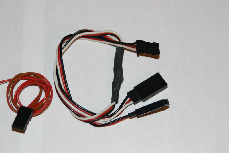

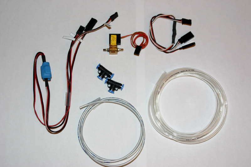

We are very pleased to announce that we have finished testing the Turbine Starting Gas Dump kit.
The kit is universal and will work with any radio or any turbine installation. Please note: This kit allows you to dump into open air and not dump the excess gas into the turbine, hence removing any overheating/flameout possibilities.

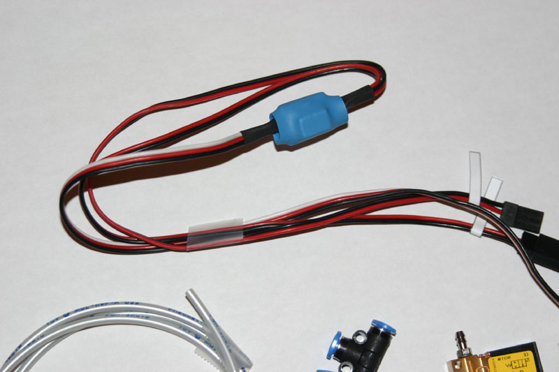

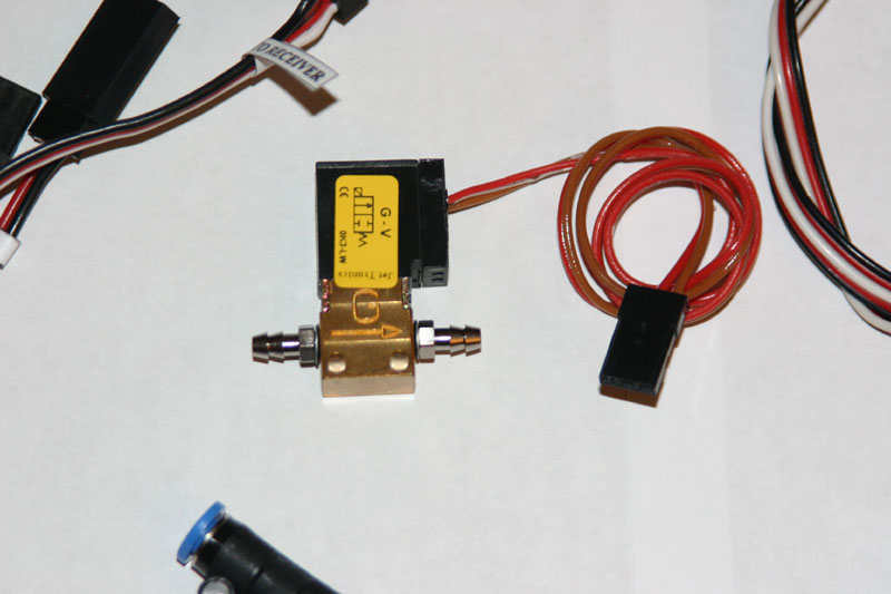

Setting-up is extremely easy, just cut your starting gas line between the starting gas tank and solenoid, insert the Festo T piece, hook up the provided gas valve to the gas line, the gas valve control lead to the control circuit, and the control circuit to a spare channel on your receiver (switch channel works as well). Activate the switch from your transmitter and the gas is evacuated.

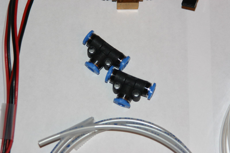

Since some turbines use 3mm for the starting gas, and some use 4mm, we have provided both 3mm and 4mm tubing as well as 3 and 4mm Festo T pieces. The Y harness is universal and will fit all radio systems.

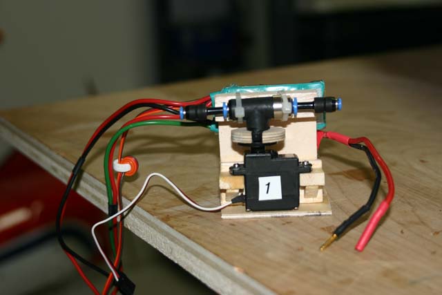

Yes John, this is the purpose behind this kit. It does not take much for gas to burn, hence we use it to start our engines. There a danger that in a minor crash, the gas will burn in case of a damaged gas line or a punctured tank. In a major crash, it might not make much difference. It will make a lot of difference in a Helicopter turbine set-up.

The Festo fittings are needed to split the gas between the starting gas tank and your own turbine gas valve.
Two are supplied since some manufacturers use 3mm and some use 4mm for gas lines. Also 1 m of 3mm as well as 1 m of 4mm tubine are supplied.
