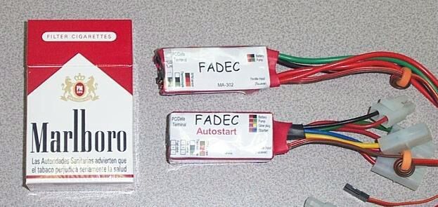

Hello,
The FADEC ECO ecu that you are talking about is the 2001 version. The hardware is the same on Wren and JDE units, but the software is custom for the JDE units, written under the JDE specifications.
Below I attach a pictures of the new version, that will be available in January. This unit is smaller than the one that you have, about 2/3 of the size, to be used in the new generation of small engines, like the MW44 and the Artesjet Bee.
The weight is 25g the manual start version, and 45g (1.3oz) the full autostart version.
Despite the small size, it have more features than the current one, like a flight recorder memory that stores the measures of the engine and airspeed each 0,5s up to 52 minutes.
Regards,
Gaspar
Regards,
Gaspar

Thank you
Andrew
That is a great report just what I was looking for!
Wow
Gaspar
To hear from you is a true privilege.
I have a 66 that could use an auto start.
If it will run my 66 ok put me on the January list.
Johnny klinner

Hello,
@ Johnny: Yes, these units are capable for Kj66. The list of tested engines includes SimJet, Jetcat P120 and bigger engines.
@ W.G.Hunter : Of course, the RAM 500 too, as it is like a MW54. But not AMA legal if you are in the USA. I have some costumers that are using it on a RAM 500 successfully.
@ Duke: I don't know what your JDE instructions say about fuel bypass, but it isn't necessary in these units, it was necessary in the old pressure types. Don't know what type of pumps are supplied now in the JDE kits, but in the Wren kits using the Wren supplied pump (Hausl 280) the recommended battery voltage is 4,8V. Simply use 4,8V battery packs, and let the ecu to take care of the battery voltages.
For further questions, you can ask me directly at [email protected]
BRG,
Gaspar
