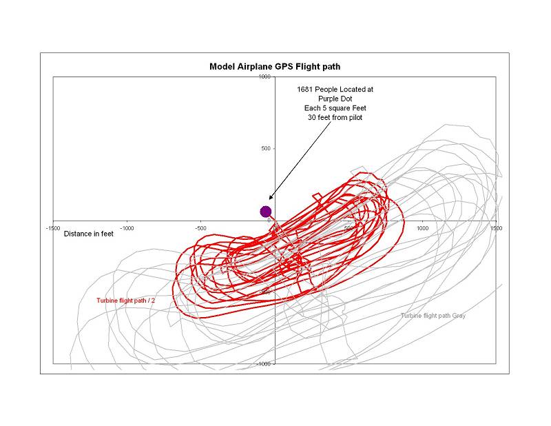

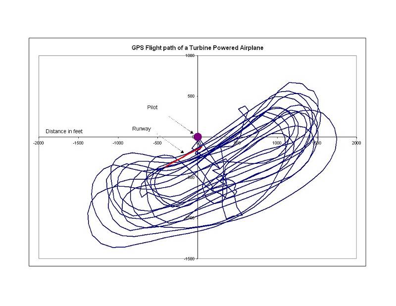

Attached are two graphs of the Probability of getting hit with an airplane.
There are a few assumptions but all are reasonable.
1) Every flight crashes
2) Each Person is 5 ft^2 and the plane does not have area
More info at
http://www.corpcomp.com/weeks1/Prob/...iles/frame.htm
Power Point
http://www.corpcomp.com/weeks1/Prob/Prob.ppt
In the first graph, This is real data collect from a Turbine plane.
The second graph is the same data divided by two. Not a prop plane
(I assumed a prop plane Goes 1/2 as fast and 1/2 as far)
Also in the second graph I calculated the odds with 1681 people standing 30 feet
Behind the pilot. Then I calculated the odds of any one of these people getting
Hit with an out of control plane..
Graph 1:
One Pilot flying a turbine, Odds of getting hit are ~1,000,000 to 1
Graph 2:
1681 people 30 feet from pilot Odds of getting hit are 213 to 1
This Probability calculation may or may not be accurate but its very good at
showing us what is important.
Eddie Weeks

In reality and Eddies post was most interesting, all we can really do is our utmost to avoid aircraft to person contact in terms of flying, and attempt to eliminate ground incidents which could range through compressor explosion, fingers etc being ingested to burns, fires and battery explosions. The danger comes from various sources such as batteries, fuel, tubing etc etc.
But note, the lottery odds are greater than Eddies and there are hundreds of winners, and those odds proved tragically what statistics can show us to two people who had come to enjoy some of our hobby.
