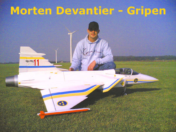

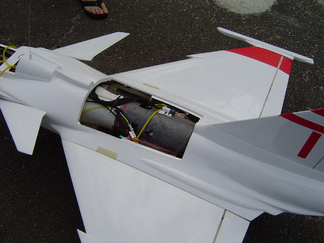

Old 05-22-2006 | 07:43 AM
Posts: 2,580
From: Mia, FL
Default RE: How do canards work???
Look at the pictures in my post. One on the left showing the canards in the up position and the other on the right is in the down position.
Hope this helps
Pictures was taking from skymaster site.
