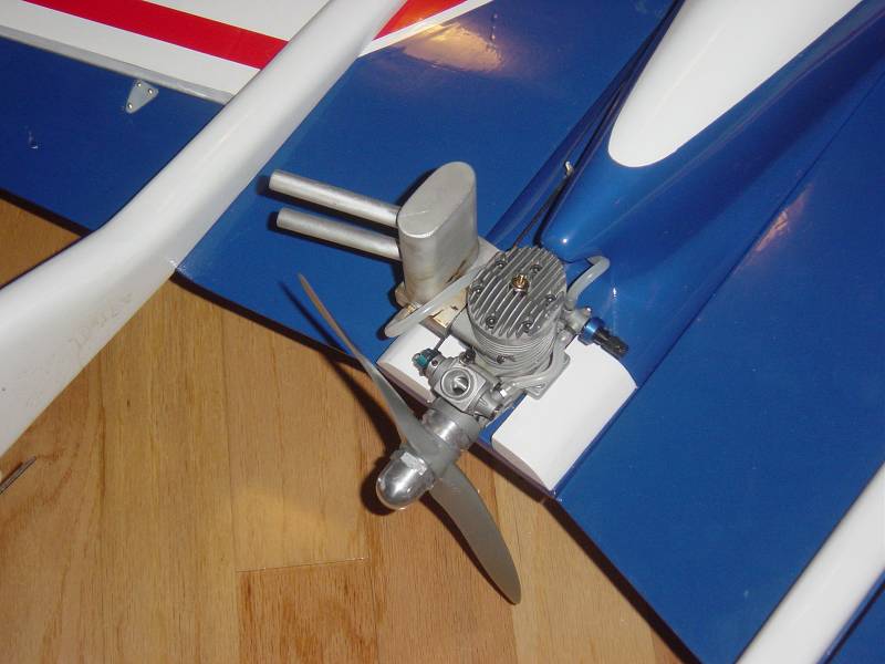

AGR,
The Pitts style muffler works well on my Evolution 46.

Hey AGR413
I read your review and pretty much followed your build, (same servos,engine,etc.) but seeing how you had the back pressure, too rich problem with your muffler, I ordered the Pitts muffler for mine. Just finished putting it together last night.
Will maybe maiden it tomorrow.

CrashPro,
Fantastic, thanks, I hope it helped you out. Thanks for posting the picture that's pitts does not look bad on there. I just could not imagine the scale until you posted the picture.

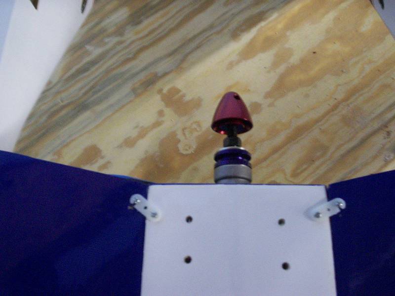

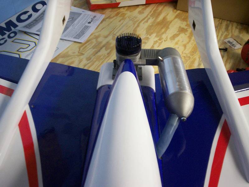

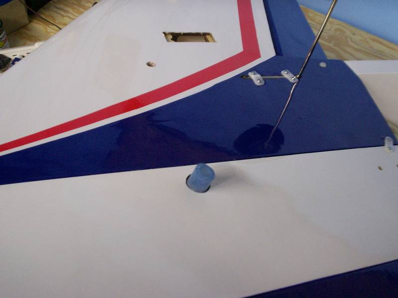

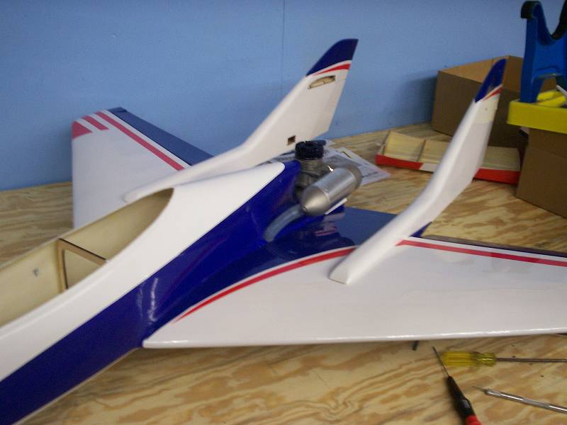

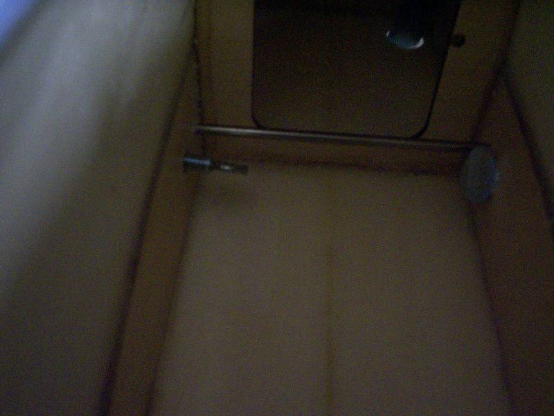

Here are some pictures of my modifications. You can see how exhaust exits out the bottom. I haven't put anything on the exhaust yet to make sure it won't come off. Also in pictures I have put 1/4-20 blind nuts in wings and then use thumb screws to tighten up to fuselage.
Works great. You can see I also put some Goldberg snaps on bottoms of wing and fuselage to hold the back ends together. I am still doing other things and will post some more pictures when I get there.
Rich O.

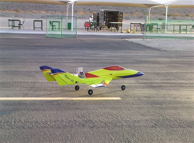

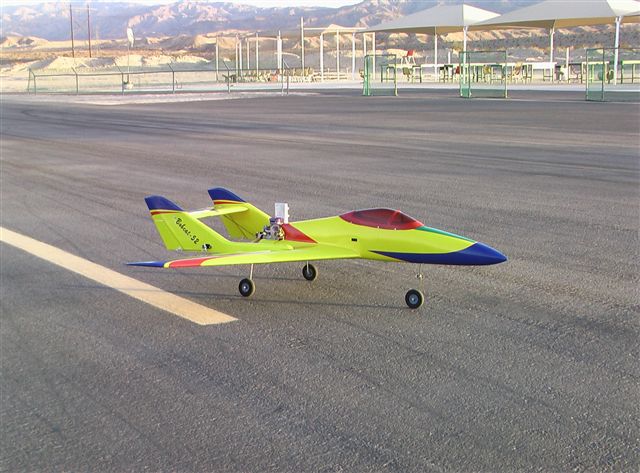

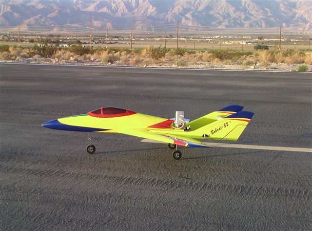

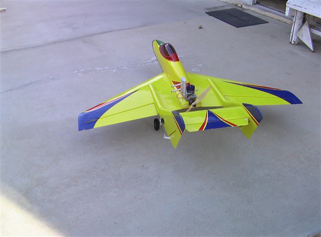

Maiden flight this morning......3 flights....several touch and goes. Had one crappy landing,..came in a little too hot,...got a couple bounces,....bent one of the mains a little. Other than that, no problems,...I love it already, gonna have fun with this one.

Nice pics, congrats on the flights. Did the engine reach top RPM? Any issues with the Pitts muffler?
