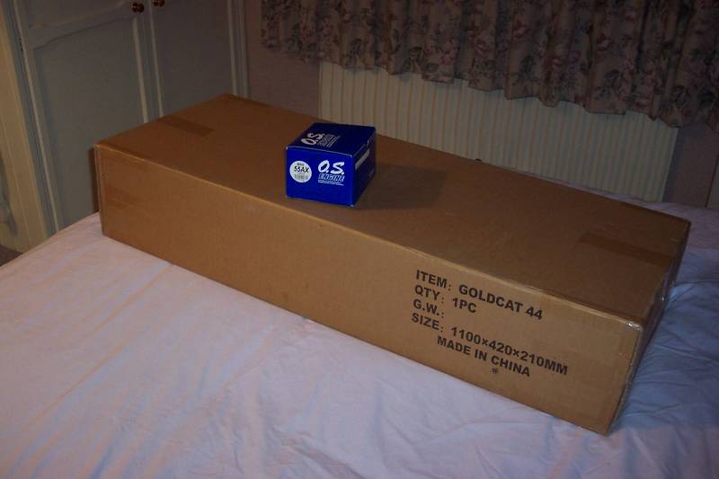

This is an interesting box.............. look carefully at the writing on the side..... Picked it up in the UK today for £149.99............. It is intended to get my hand in before I fly my first turbine
Dennis

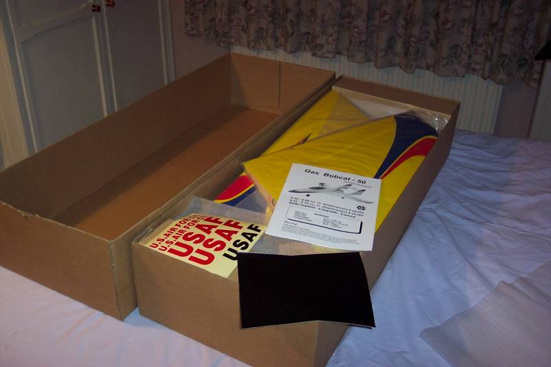

Old 01-10-2007 | 02:53 PM
  #883
Banned
Joined: Jul 2004
Posts: 2,725
From: England, , UNITED KINGDOM
Default RE: Nitro models pusher Bobcat?

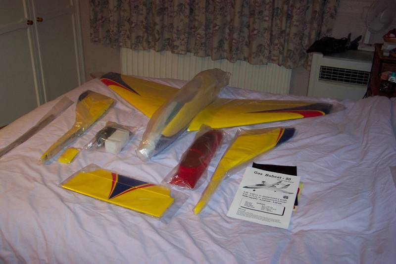

And here it is out of the box.............. A Goldcat or a Bobcat You decide ?
Dennis
www.densplanes.co.uk
ID:	595038   Click image for larger version

I forget what the outside shipping box on mine said, but it wasn't GoldCat or Bobcat. I think some of he decals are different too. But what the heck, as long as the stuffin is right.
You got it from Colchester models and you are going to put a Wren 44 in it..
....you lucky dog, you !!!!!!!!!!!!!!

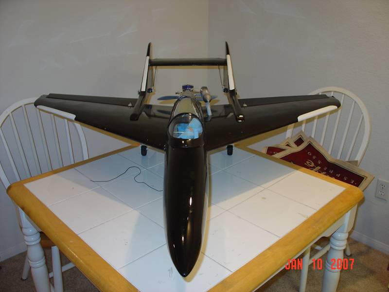

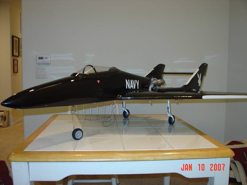

Well here is my baby. Using a Hobby People Magnum .52 with a 10x6 APC prop. Not getting the speeds I want. Looks like from the feedback I should try a 11x7. First flight the stock landing gear craked the wing on one side. With her new stems she now lands nice and smooth. It looks like everyone's CG is about 10.25 to 10.5 from the leading edge. It that with the fuel tank full or empty??? Still one of the funnest planes I have had and she turns some heads at the field.
Old 01-11-2007 | 01:47 AM
  #891
Joined: Jul 2004
Posts: 7
From: Lancaster, CA
Thank You Very Much.....
Old 01-11-2007 | 01:57 AM
  #892
Joined: Oct 2005
Posts: 26
From: Ladera Ranch, CA
I guess the pictures did not upload. I will try again.

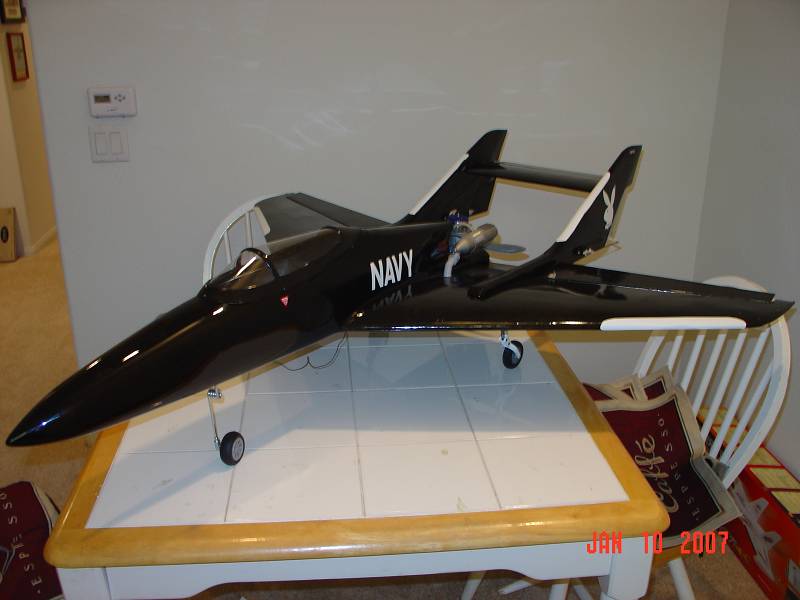

Here is some more. None of the colors they were selling really did anything for me, but the bunny does.
TOPGUN---THERE CAN ONLY BE ONE!

I was going to put my wren in her but I have decided to go with the OS 55AX I am using this model as a lead in before I fly my AMD Hawk with the wren in her
Dennis

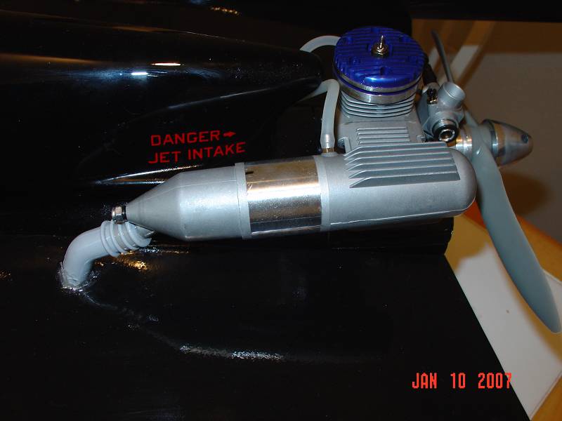

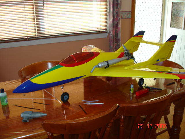

Well after reading the issues with pressure from the forward facing exhaust. I made a new one.
The baffles have been removed. The tuned length is longer as I have replaced the missing section with
A hollow pice of pipe, by doing this i can remove the long silicon joiner used originally.
This is my first ali weld so its ugly but strong and sealed,it will also deal with the pusher pipe issues.

Mattgrant, nice job! I have one that I'm just about to glass the wings, retracts are installed and just finishing the details on the booms and off to the paint room.
Where did you get the clear canopy?
