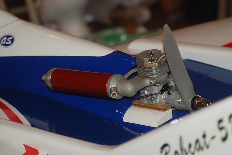

Hi guys,
DUB from JETT ENGINEERING IS COOL!
Look what he made for me! He took the normal rear-exhaust pipe, filled the hole, then put the stinger facing the rear. I will give you test results (RPM's) as soon as I run it.
With the stock muffler, using 30% Heli fuel, APC 11x7 prop, I'm turning around 13,200 on the ground....I will run the same setup, but just change the pipe to the new pipe, and fly it, and let you know what happens. They guys at Jett think I should be using a smaller prop to get around 15K...so I'll see if I can find any smaller pusher props (10x6, 10x7, or 11x6) I just don't know if I can find any.
So I'm anxious to get back out to the field! It may have to wait until Thursday unfortunately, but I'll run the motor tomorrow after work just to see what it does.
OPJOSE - send me the Bobcat file for Real Flight! [email protected] Thanks, man.
CYA!
Mark

I am fying the same setup you have but with an ultrathrust muffler .You will find that the best prop for the
os 55 on this plane is the 11x7apc .I have tried all of them . The hot pipe will bring you about another 1500 rpm, better vertical performance, and almost double your fuel consumption .I am out of fuel in 5 minutes.

Timevac - I paid $75 for the pipe...this doesn't mean it's his final price - he built it for me after a couple of emails back and forth. But definitely call him or email him and let him know he should produce them.
I have the Weston pipe on it's way, too.
I can't believe what you're saying about the fuel consumption....wow....I land after 5 minutes or so with a bunch of fuel left now...I guess I'll set the timer for 5 minutes and then check it. I don't fly with the throttle wide open continuously, though. I'm sure flying styly also affects things. What fuel are you using?
I'll probably take it out around lunchtime today...
Cya
Mark
Cya
Mark
