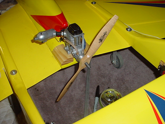

After looking at pictures of the nitro version of this plane, I see the engine is mounted without an engine mount, so how would I mount an electric motor? Is there a firewall I can bolt it to?
Old 10-09-2007 | 11:14 PM
  #2309
Flyboy Dave's Avatar
My Feedback: (21)
Posts: 13,864
Received 10 Likes on 10 Posts
From: Pinon Hills, CA
Default RE: Nitro models pusher Bobcat?
....no firewall. The nitro engines bolt on like this.
FBD.

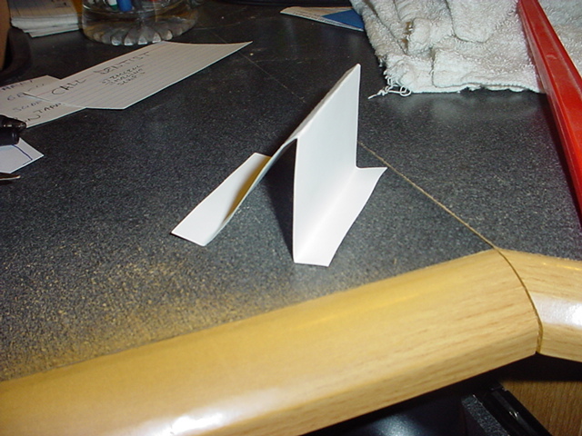

Any idea how I would mount an electric motor?
Old 10-10-2007 | 12:30 AM
  #2311
My Feedback: (21)
Posts: 13,864
.....bend an aluminum plate like this, and cut a hole in it . Bolt the plate to the existing mount,
or modify the wood as necessary. Bolt the electric motor to the plate....you're in.

Would this plane be faster with a tower .75 engine in it or a hacker A40/10L? If not the tower, then what engine will give me the most speed?
Old 10-10-2007 | 10:43 AM
  #2315
opjose's Avatar
Joined: Nov 2005
Posts: 12,624
From: Poolesville, MD
I can't speak for the Hacker, but the Bobcat .50 REALLY moves with the GMS .76 engine and the Graupner 11x8P prop.

ORIGINAL: RCplaneflyer14
Also will these retracts work without any mods to the plane [link=http://www2.towerhobbies.com/cgi-bin/wti0001p?&I=LXL406&P=7]Retracts[/link] And how many retract servos will I need for those retracts?
No you want pneumatic retracts on the wings.
Mechanical retracts will require some modifications.
You could possibly use a mechanical nose retract, but if you have pneumatic wing retracts why bother?
No firewall.
The "LIP" we mount the engines onto is VERY VERY hard wood. ( They did this right on this plane. ).
So you could bolt on any sort of mount you want to come up with.
A pair of hardwood blocks cut to size then epoxied into the fuse works fine, adjust as needed for an electric.

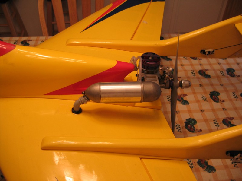

Old 10-10-2007 | 07:42 PM
  #2322
still4given's Avatar
Joined: Jan 2006
Posts: 1,611
From: Victorville, CA
I have the Tower 75 and it zips along very well. I ran the exhaust down through the wing. Keeps things pretty clean.
Blessings, Terry
