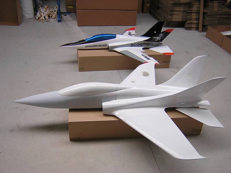

Managed to remove three ounces from each wing, although this will be offset to some extent by fitting standard size servos instead of minis.
Some advice for Aviation design. It would be helpful if the guy who makes the left wing, consulted with the guy who makes the right wing, & came to some agreement as to whether the wood blocks that support the flap & aileron horns are to be placed inboard or outboard. At present they each have opposite preferences.
Regards
Jim
Regards
Jim
#308
I now have everything in place, using a Wren supersport, 2 X 5 cell nicad Rx packs & the ECU lipo in the nose. The Scorpion after all its mods weighs 18lbs 2 ozs & balances at 160mm with the gear down & a full UAT. No nose weight required. Standard size servos all round Except rudders (Hitec 225)
Regards
Jim

I don't know how you have got down to 18lbs 2oz!!! I am at 22lbs with the Wren SS and 12oz of noseweight, of course I was unable to copy your weight saving mods as my model was too far advanced to go back and rip all the excess glue out. Taking the weight out of the equation you are 3lbs 2oz lighter than me using a similiar battery setup. I am using a 2 litre coke bottle tank and a six oz hopper and my CG is at 165mm . At 18lbs yours should fly very well, I hope to maiden mine at RAF Leuchars this coming Saturday if the weather is ok.
John

John. With no nose weight, I am immediately saving 12ozs. You would not believe the amount of Hysol I removed from each fin. It is also possible to almost balance the stabs by removing weight behind the mount pin. There is also some Hysol that can be removed from the wing. I opened up the inner face & removed lumps of it from the wing tube supports.
I used the optional kevlar tank & a standard UAT.
Good luck with the maiden flight. I am sure it will be fine. Sometimes a heavier model is more stable in flight. They tend not to get blown about so much with the wind.
