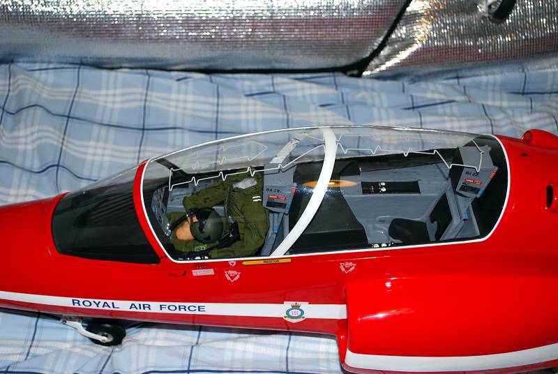

Bit more progress on the cockpit MDC fitted and white stripe painted on the inside of the screen.
John

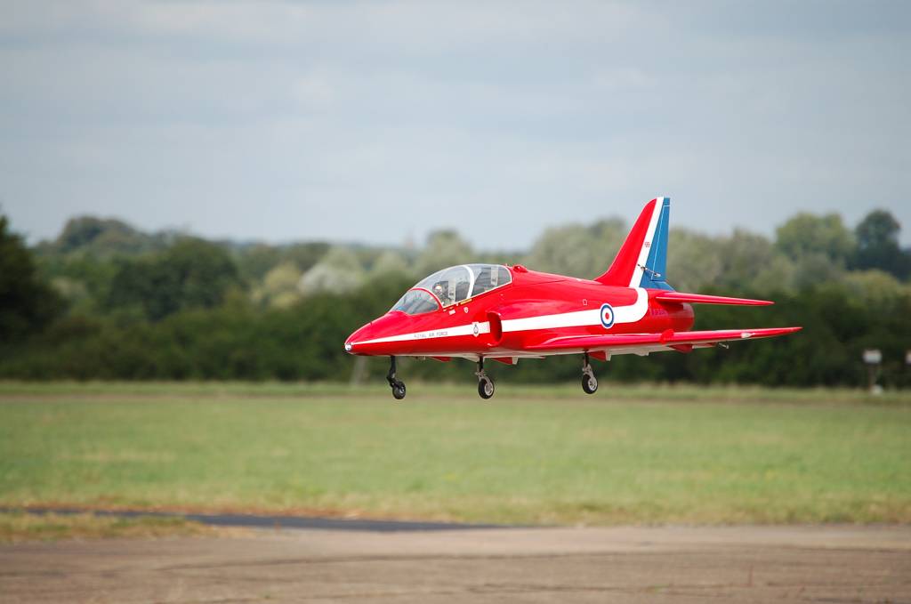

Default RE: FOX COMPOSITES Bae HAWK, Build thread
Quick post.
Nice picture taken by Dave Wiltshire from Motors and Rotors.
My Hawk on landing run in.
Shows clearly the new legs i have now fitted.
They work really well, also the nav lights can be seen, more details on these when i get a moment.
Paul

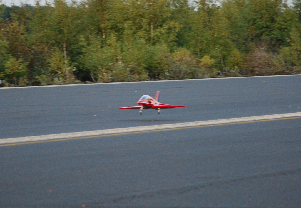

Been very busy with shows and family.
I will give details on the nav lights soon but here is a pic taken at the Hop Farm(Southern Model Airshow) last weekend.
The nav lighs show up really well
Paul

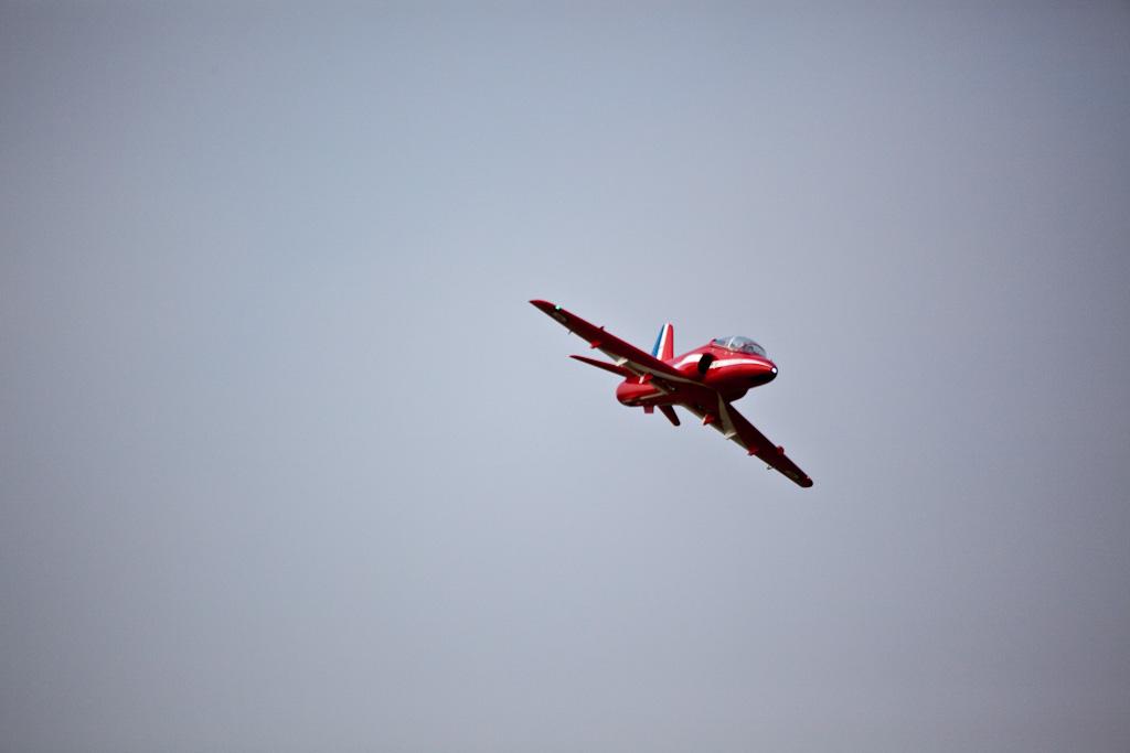

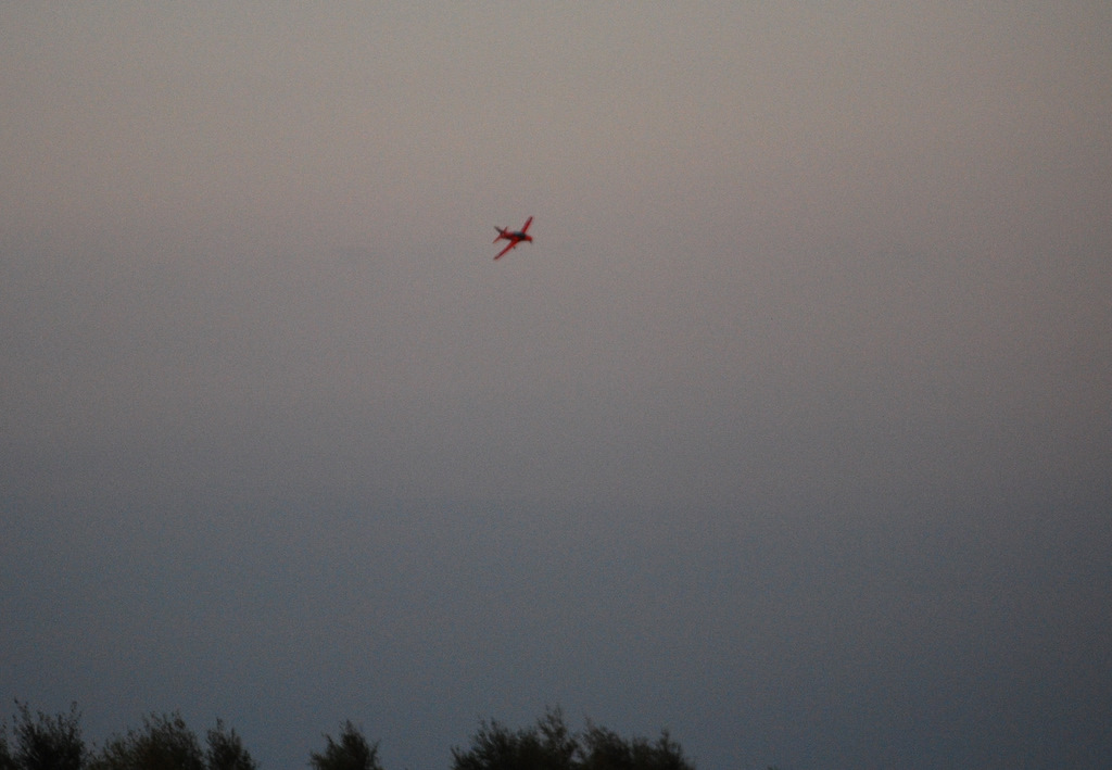

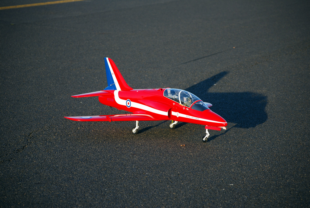

Decided to test fly the hawk today it was very late in the day and was starting to get dark and there was no wind.
The model climb after takeoff and needed half down trim for level flight.
I found the controls very soft with the recommend travel and expo [X(]. I will remove the expo and increases the control travel for the next flight.
The centre of gravity was ok as it did not require much down for inverted flight .
Due to poor light I decided to land after 4 1/2 minutes using half flap. I need some lights.
I have attached some photos the quality is not very good due to poor light. I will get some more photos next time.
John

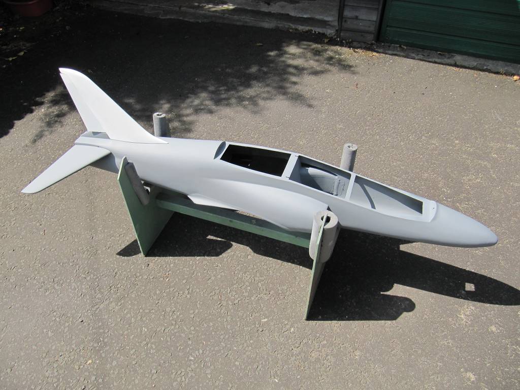

Got my Hawk last week from M&R and started work today, took advantage of a warm still morning and removed the high gloss finish from the fuselage and tail feathers with a 3M fine sanding pad followed by a clean down with cellulose thinners followed by a coat of primer. (My kit was black and it will be painted in the Swiss scheme) Ordered the decals and MDC from Ralle at Tailormade last week and they arrived today. Power will be Wren 44 Gold / Wren pipe / Jet1A oleos / Springairs. Do not have a set of instructions yet so looking for help on the method of installing the elevator servo which will allow me to complete the rear fuselage, Paul, Gordon , John, anyone?
John
