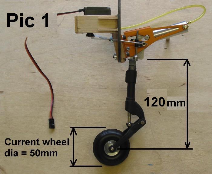

can you guys tell me :
is it rail mounted or firewall mounted?
oleo size from pickup to axle centre from mains and front?
we do have some sets that could fit.

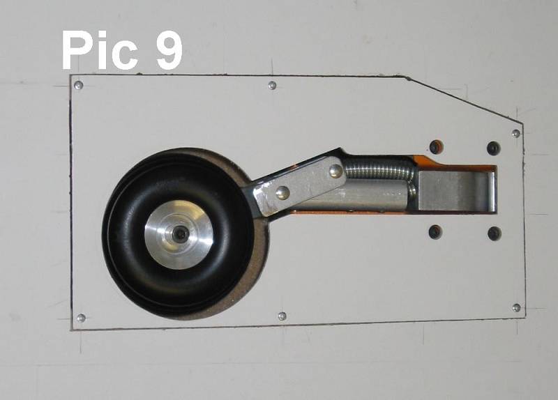

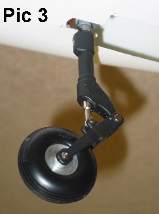

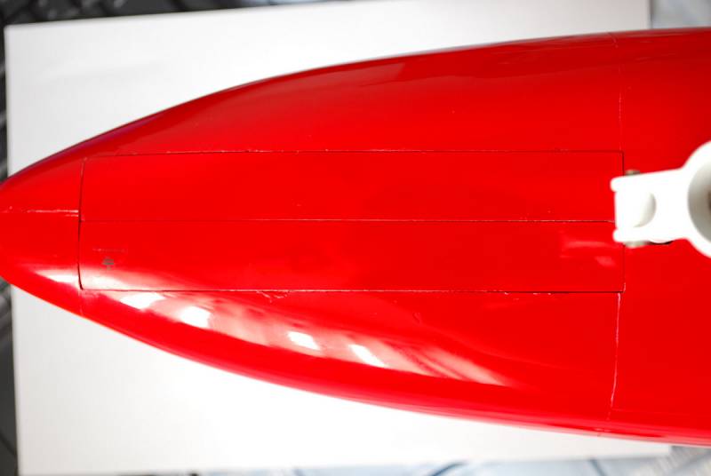

Hi Sandor

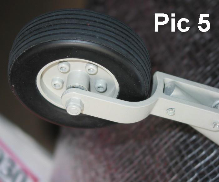

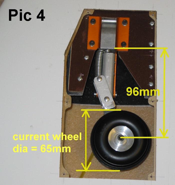

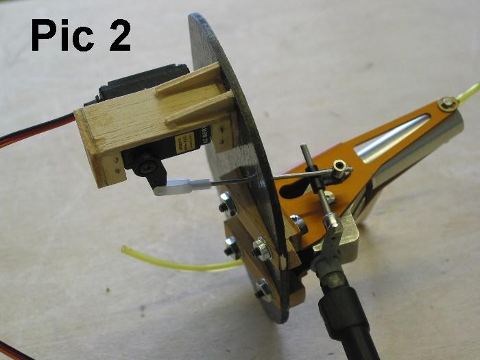

Pic 1 is noseleg length (120mm) from base of retract block to wheel axle on mine. Nosegear is Robart 517 105deg. Wheel dia is now 50mm.
Pic 2 shows Robart steering arm, which is separate from leg.
Pic 3 shows that piston is directly linked to swinging arm, resulting in binding at ends of travel. An intermediate link is needed.
Pic 4 shows length of mains from base of retract block to wheel axle. Retract unit is Robart 510 90deg.
Pic 5 shows inboard side of cut-off wheel yoke.
Pic 6 shows outboard side of wheel. Main wheels are now 65mm Eurokit.
Hope this helps
Gordon

Old 07-06-2009 | 02:18 PM

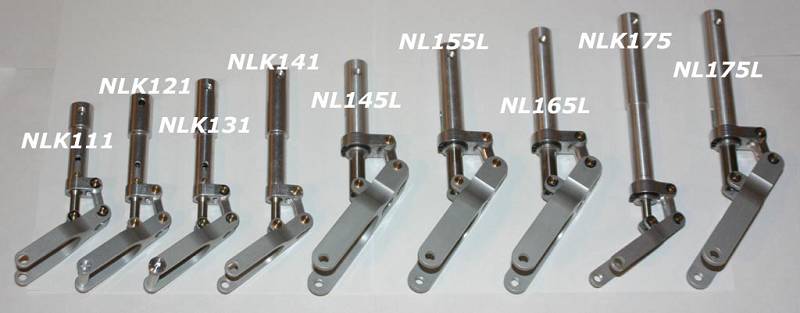

If you download the Eurokit .pdf cat there is a side view.
I don't see that file! [&o] I don't read Italian. So I can't find the file to download? Maybe I'm not in the right website?
I also see in their website you have to sign in?
I would like to have the nosewheel strut. Could someone buy it for me and send it to me? I would appreciate it. I can use PayPal, check, Master Card.
Gordon, those photos are great! Really helps me alot. Thank you.
I was going to have my gear retract backwards, but I see now I can have it go forward just like the actual aircraft. Great setup!
Gordon, did you shorten the nosegear strut? I'm asking because I see you have your mains are at 96MM and the nose gear at 120MM. Your model sits nice and level?
Your retracts are air?
I'm doing my first Jet and first retracts so I need all the input I can get.
Help me with getting the nosewheel? one less thing I won't have to think about[sm=bananahead.gif]
Here's the link to the struts in this photo.
http://www.altecare.com/struts.htm
John,
Thanks for those photos and the link.
Charles

Hi Charles
Motors & Rotors have the legs in stock, I am shore Dave will be able to help you.
http://www.motorsandrotors.com/

Gordon what is the depth of the wing?
measure please top of the rails , and distance from depth to top of those rails.
also need depth of max retract

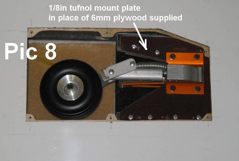

ORIGINAL: digitech
A moulded grp bracket epoxied in the wing supports the main gear mount plate.
View post 44 page 2 and post 285 page 12 of this thread to see what is supplied.
Pic 7 below is an end view of the bracket with dimensions showing the depth available between top inner surface of wing and mounting flange. The overal depth of the wing at the retract unit position is around 40mm, maybe a mm or two more. I glued plywood doublers beneath the flanges for the self-tappers to screw into.
In pic 8, I used 1/8in thick tufnol instead of the 1/4in ply provided so that my rertract units would be concealed by the cover plate seen in pic 9. However, I don't now regard this as important.
Gordon

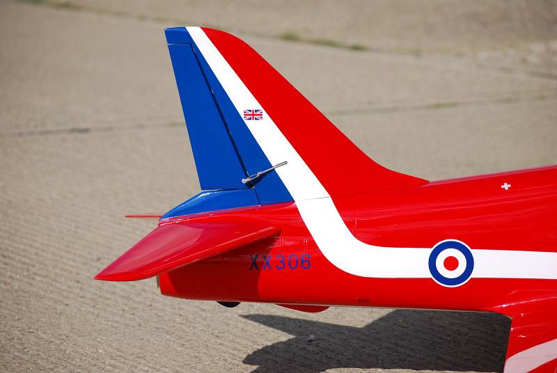

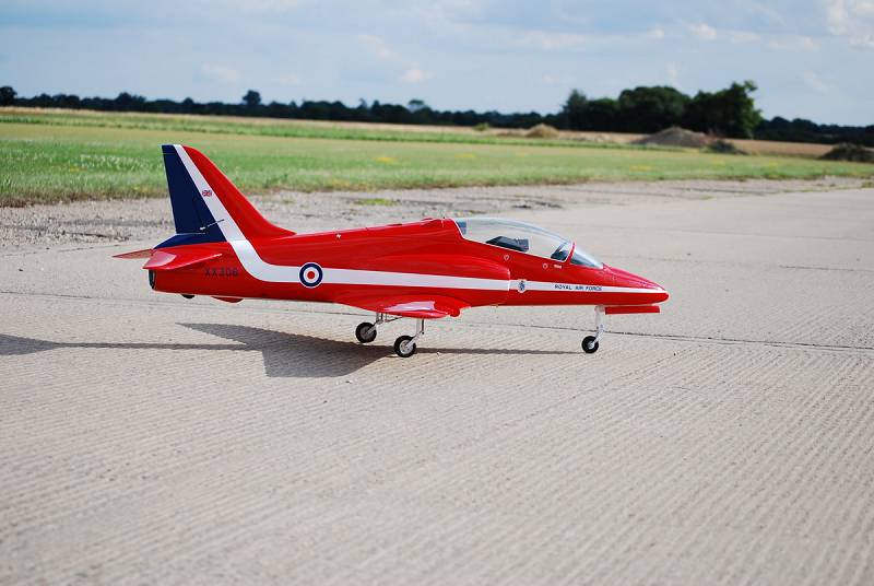

Old 07-26-2009 | 04:12 AM
  #693
Joined: Mar 2005
Posts: 89
From: felixstowe, UNITED KINGDOM
Default RE: FOX COMPOSITES Bae HAWK, Build thread

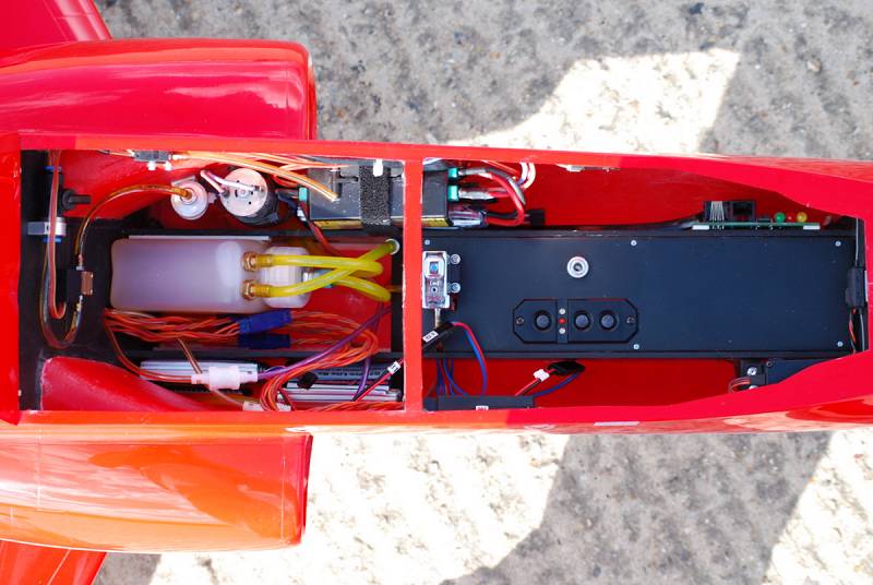

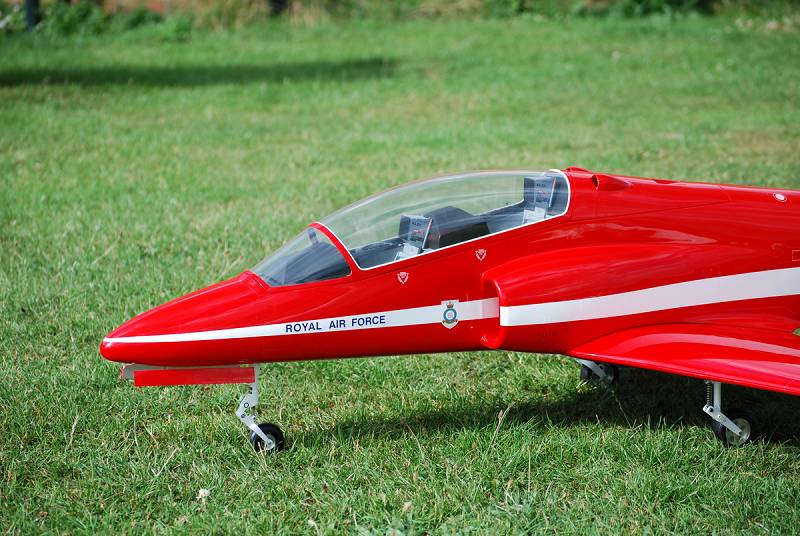

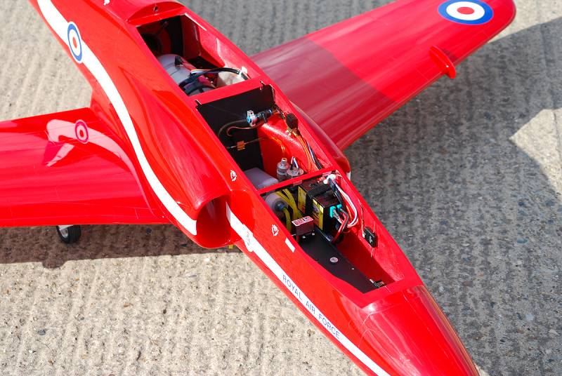

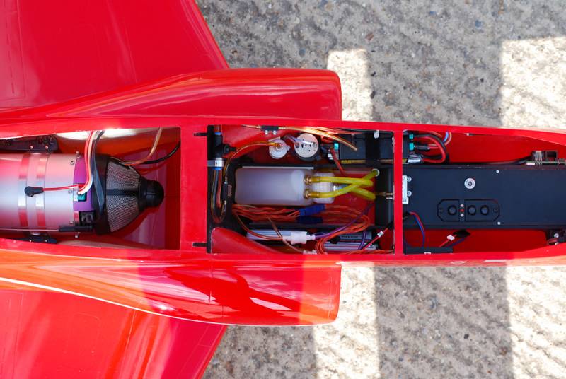

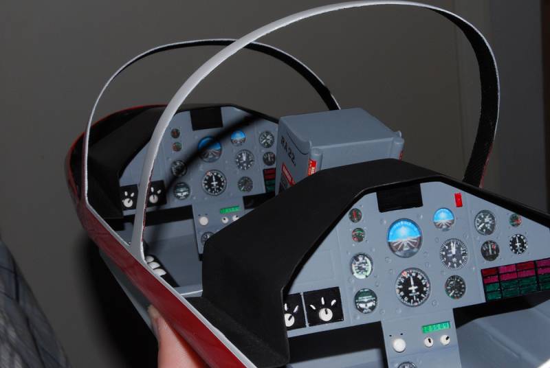

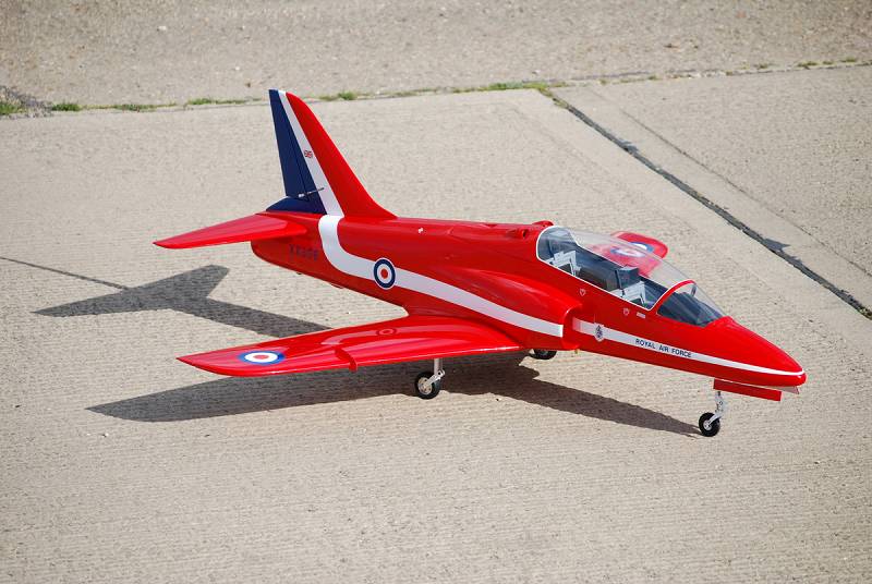

I have almost finished my hawk so I took it up field to do an engine test run the P60 fired up straight away and run perfectly.
I still have to finish the cockpit and balance the model.
Hear are some photos.
This thread has been grate help in building this model and I would like to thank those that have posted Photos of there set ups.
John

Old 07-26-2009 | 04:17 AM
  #694
Joined: Mar 2005
Posts: 89
moor pic's
ID:	1243651   Click image for larger version
ID:	1243652   Click image for larger version
ID:	1243653   Click image for larger version
ID:	1243654   Click image for larger version
ID:	1243655   Click image for larger version
ID:	1243656   Click image for larger version
Old 07-26-2009 | 08:23 AM
  #695
Gordon W's Avatar
Joined: Mar 2004
Posts: 644
From: UK
Your Hawk looks absolutely superb John with a very neat installation. I hope she gives you lots of great flying.
Gordon
Old 07-26-2009 | 10:47 AM
  #696
Joined: Mar 2005
Posts: 89
Thanks Gordan
I copy your method of installing the Robart retracts Your photos saved me a lot of time.
I hope she flys OK this is my first Jet. I have test flown about 9 jets in the last 2 years for my friends so I hope this one is ok.
John
Old 07-26-2009 | 11:41 AM
  #697
GrayUK's Avatar
Joined: Oct 2003
Posts: 3,601
From: Dunstable, UNITED KINGDOM
Looks absolutely awesome!
Just remember you have ‘bags’ of extra power with the P60.[X(]
Half throttle should be more than enough.
Keep us informed.
Paul
Old 07-26-2009 | 12:15 PM
  #698
Joined: Mar 2005
Posts: 89
Thanks Paul
For you help and starting this thread.
The P60 should push her along fairly well . I will have to throttle back to save on fuel. I would have gone for the 44gold but was offered a low mileage P60 at a very good price.
I fitted my canopy window on the inside of the frame as you suggested.
I will keep you updated on the progress
John
Old 07-27-2009 | 09:03 AM
  #699
Ron101's Avatar
My Feedback: (22)
Joined: Aug 2004
Posts: 1,833
From: Brentwood, CA
Hey 3D Flip (John)
is that the stock red..with the white stripe added? it looks way to good to be stock... I'm guessing you painted the red also?
great looking model... I'm going to do an EDF version very soon with a Stu Max fan
also what struts and wheels are those...the whole thing just looks awsome... great job!!
thanks
Ron
Old 07-27-2009 | 09:36 AM
  #700
Joined: Mar 2005
Posts: 89
Hi Ron
It is the stock red paint. I painted the white stripe and blue.
The only red I have done is the cockpit frame because I filled it to matched the fuselage better, A Friend mix up some 2 pack paint to match the fuss for me.
The legs & tyres are eurokit. I made my own wheels.
John
