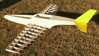

I recently purchased a BobCat and am almost finished with it. I have never flown a jet and I quickly realized I probably should start with a trainer first. I could not find one I liked so I came up with my own design. I started on it several months ago. When I took it to the flying field to show a friend another club member says it looks a lot like the Facet. It is almost the same, but has a fully semetrical low wing. I have a Wren MW54 I am going to put on it.
I have attached a picture. It has a 72" wingspan and is all balsa and plywood. If there is enough interest I may try to kit it.
Any comments or suggestions are welcomed.
Hal

Looks Great! What's the wing area going to be? Do you think that there's going to be enough room for fuel? Keep me posted on your progress, after building a Super Reaper, I've got an itch to build with plywood?

Looks good! Keep us posted-
Sure doesn't look like a home-made, and that is meant as a compliment!

I think it looks appealing as well. I Hope you decide to move forward with it.
You said MW54. Is that the size the design is targeted for?

It is designed around the Wren MW54. It should weigh around 12-13 lbs. I have a forty ounce tank in it right now, but it could hold a much larger tank. The fuse is around 6 1/2" wide. I will get some accurate measurements, but I would say the wing area is around 850 - 900 square inches about the same as a .60-1.20 size Extra 300, Cap 232, etc. It should be a floater. I will not have retracts but could be built with them.

'Sounds better all the time! My Reaper is powered by a MW54 as well and has a 40oz and a 32oz tank in it. With my timer set at 7 minutes I can do a couple of "missed" approaches and still land with "comfortable" fuel. Most of my flying was done at full power. I think that your wing area is about right. The Reaper is a REAL floater at 171/4 pounds and 1650 sq. inches.

Nice looking jet, where is your inlet i hope you are not putting
your inlet at the bottom ???

The inlets will be on the side. I assume they will be made of ply unless someone knows of a better way. I also need some suggestions on where I might find a main gear. I would like to use plastic gear because it holds up better than aluminum.

I like the lines of the fuselage.
Personally since it is a fully symmetrical airfoil I would shoot for 1100 square inches of wing and no flaps to keep things simple.
I would also put two rudders on the elevator ends. This should give you a lot better knife edge flight and would look different from other kits.
Leave some room in the front for a video camera.
Looks good, please keep us posted

Looks great! What airfoil(s) are you using?
