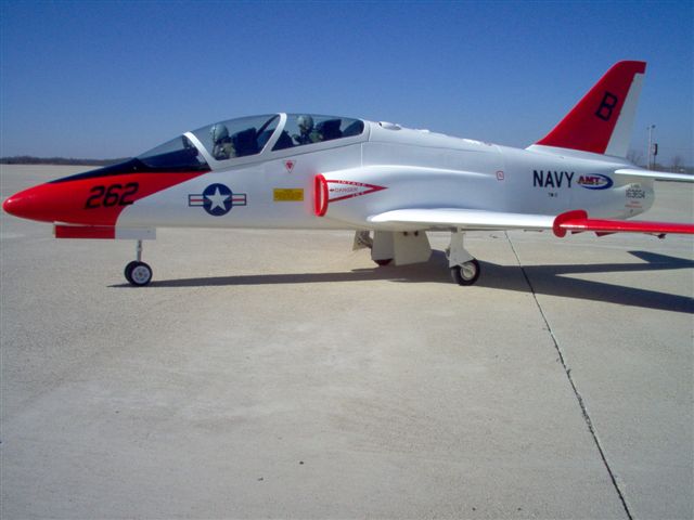

I too have not had any problems. I have been flying a skymaster hawk with the DX-7 since it was introduced. I however use a battery backer system from Electrodynamics that gives me constant voltage to the receiver.
The General
