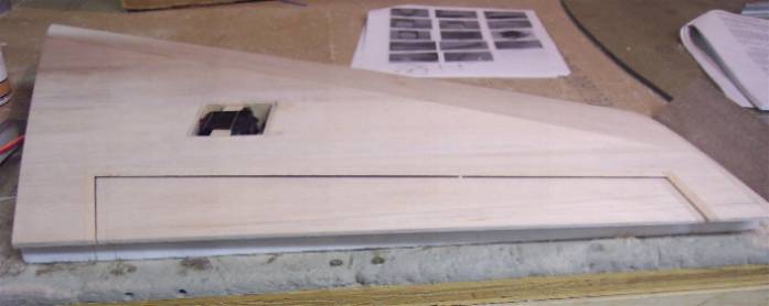

Here is a few pics of the elevons

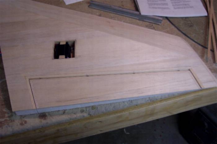

here is one after hinging, I used the large Robarts

this is after the hinge gap cover was installed.

and another of the gap cover

and about those hinge gap seals.. is that just a thin strip of balsa on the top and bottom of the hinge line after hinging the surface? i need to know the best way to hinge things on a jet as i have several at this stage including a sting ray.. always sealed them with clear ultracote in the giant scale stuff. but this painted glass work is a bit different.. any easy tips..
Old 03-03-2003 | 03:21 AM
  #31
Posts: 993
From: Otis Orchards, WA
Default Stingray Construction
The gap seals are a triangular stock, more like a right triangle. They are applied after the control is hinged and rounded. Some sanding was still required after the stock is applied. I think these gap seals are really more to hide the hinge line and make a smoother surface but as far as sealing them it is not doing much for them. I am going to put some thin soft foam in the pocket after painting and just before glueing to help with the sealing of the top and bottom surface. The covers were easy to install and look good so they are worth the effort in my opinion. As far as the doors go, what you are describing is the effect that I am hoping for. I will let you know how it goes.

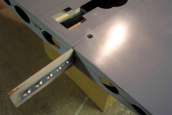

I am starting the wing mounting. I have prepped the spars and am ready to fit the wings to the fuselage. The spars fit nice and snug, it should be a very stiff structure when complete.
Here is the parts

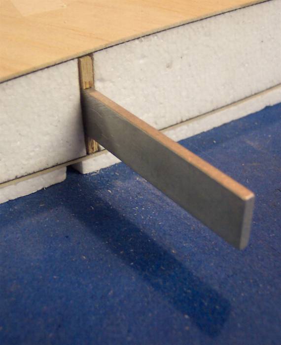

Here, the spar is glued to the reinforcing plate and the spar slot liners are ready to be glued into the wing.

The liners being epoxied into the wing with the spar holding them tight in position.

I now have the wing spars set in the wings. The anti-rotation pins still have to be installed.
