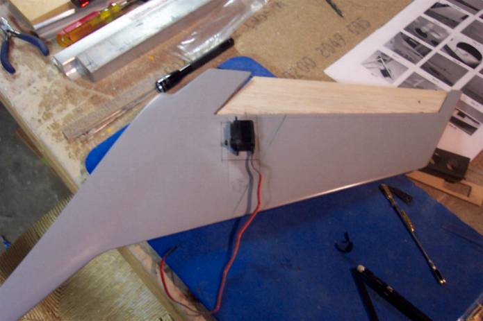

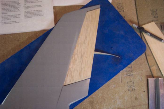

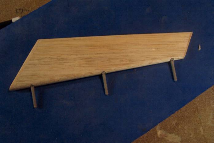

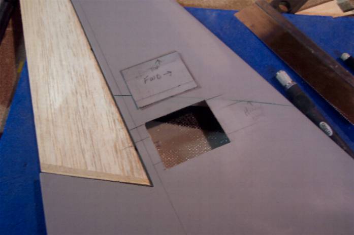

Well, here some pics of the vertical fins. The initial fit of the rudder was a little off but no big deal, just took a little more sanding and fitting. Here again, I did not like the way that the angles of the hingeline and the pushrod were in relation to each other, it seems that there could be a fair amount of binding as the rudder throw increased so I had a couple of ideas to make it better, or so I hope! I was going to machine a torque shaft that went into the bottom of the rudder and down to the servo utilizing a fully concealed linkage and then change the angle of the mount so that everything would be perpendicular when set up, I changed my mind on that because I was worried that I would not get enough leverage on the linkage so I am going for mounting the servo farther up in the fin through a hatch and jsut run a direct drive to the rudder. We will see how it goes! I hope that the fin will be rigid enough when everything is finished.
Chris

I chose to use the large robart hinges on the rudders as well, better safe than sorry!

fin, rudder assy.

Too far to turn back now!

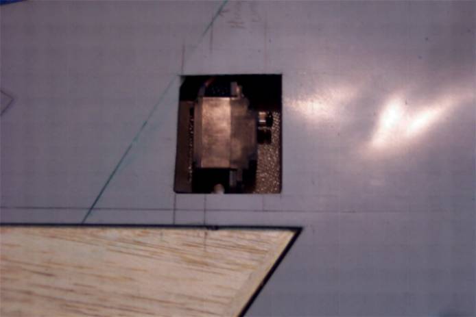

The servo mount.

Strato, if it is not too late, flip the servo around so that the output arm is facing up, instead of down. This will put the control horn closer to the aero center of the rudder and make a torsional flutter mode less likely.

Thanks Woketman, I will try to get it flipped, I have not glued anything yet. The only problem I will have is getting the servo out if I need too. I put it upside down so I could get to the screws through the bottom of the fin. I will lt you know how it goes.
Chris

I'm also a little concerned about the angles (rudder hinge line relative to the pushrod angle). I think the way you handled that, Stratotanker, is very sound.

Thanks, I am still tinkering with it. I was a little concerned about the mod but am more certain that it will work now that I have had a couple of replies supporting my efforts! One other thing, when you drill the holes in the fin for the rudder hinges, be very cautious, when I was drilling out the holes everything was good until the bit hit that carbon roving and it caused the bit to jump off center, you experienced guys may have already known this but this is my first experience with carbon fiber, just thought I would pass it on to those that are building that might not know about it.

I've found it a little tough to assemble the rudder to the fin with the hinges in place due to the sweepback of the fin. Am I missing something?
