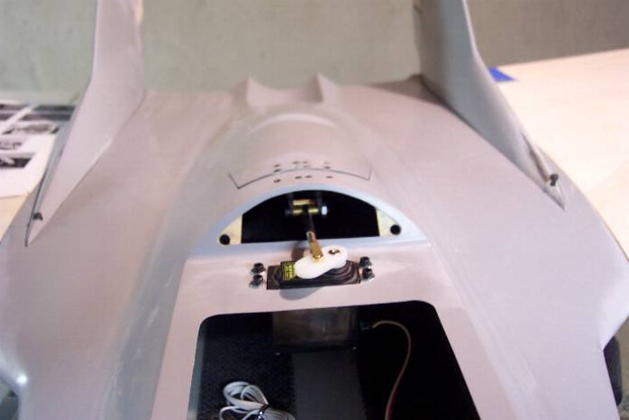

Thanks Paul, I was actually talking about the top speedbrake, sorry for not being more clear. I do like the idea you used on the bottom too, I am not quite to that stage yet. I am hoping to cut a brake out of the bottom and use an air cylinder as you did but mount the cylinder inside between the wheel wells or put the brake in front of the tanks to hopefully counter the nose down pitching of the top brake. As you can see, I am still very much undecided in the method that I am going to use.

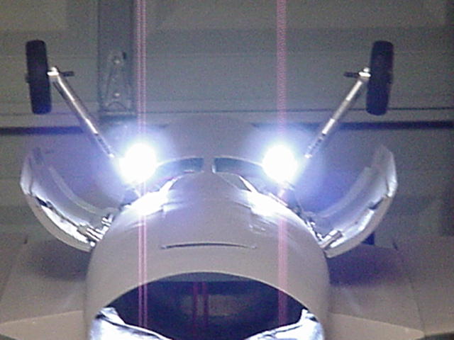

My almost completed new AD F16 Falcon.

Now that is a great looking Falcon Paul!
Old 03-28-2003 | 11:21 PM

I'm working on it. No Clear yet working on detail.This one has Ailrons. and full scale lighting.The colore and markings are scale.
The full scale bird belonged to the Royal Netherlands Air National gard, Squadron 322, in 1993.That particular aircraft was the 50th anniversary of 322 Sqn.If interested check out this link. Thanks Paul jpofl
http://www.322squadron.nl/index800.html

Paul,
Great looking Falcon! Can I get a closeup of the gear? What did they cost?

Hi Shaun. Here is a shot with the lights on, Paul JPOFL

Ok, after a week and a couple cases of beer, I finally made up my mind on the upper speed brake. The actuation linkage as recommended by the kit I did not like because it was limited on the throw that I was able to use and it also was going to interfere with the kevlar tanks so I changed it to something that I think is going to work, I feel that the linkage hookup to the hinges may be less than desireable but I have 110 oz of torque and metal gears so hopefully all will be well. When I glued the hinges to the speedbrake there was some torsional twisting between the two hinges so I machined some supports that tied the two hinges together and it made quite a difference. The only play that can be made in it know is airframe flexing which I hope will be diminished after more construction is done and the thing is stiffened up, but really how much stress is going to be on the brake at landing speeds anyway???, I hope that I am just being overcautious. I will add the lower brake after I get some of the internal equipment installed and then work around it. Here are the pics, tell me what you guys think. Nice F-16 Paul!
Chris
