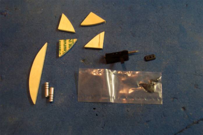

The fins are complete and I have started on the canopy.

Old 03-14-2003 | 06:04 AM
  #112
Posts: 993
From: Otis Orchards, WA
Default Stingray Construction
Here are some more pics of the canopy. The fit is ok but the sides hung out a bit.
Old 03-14-2003 | 06:07 AM
  #113
Posts: 993
I made these alignment pins out of aluminium to bring the sides of the canopy in. The seam still needs some work to conceal it better and will be accomplished closer the finishing.
