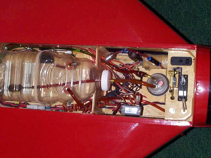

747drvr, i may not be explaining things correctly. I am not really running a "header" tank but straight off one of the main tanks so i am concerned when the tank gets low there is a chance of getting some air.
V..

Sorry Vincent . I thought you were using a header tank . You can also use a small fuel filter element available at an auto parts store and adapt it to attach to a fuel line but the felt clunk is probably easier . I would still use a header tank unless space is a big issue . I'm using Sullivan 2oz tanks as headers in my MW44 powered planes and they take up very little space .
Marc

Felt clinks aren't recommended for turbines. I know that some have done it without issue, however it is easy for felt particles to migrate from the clunk and plug your injectors or downstream filter.
You can make a pleated filter clunk from an automotive fuel filter. The JPO website use to have a how to set of instructions on their website. For some reason they removed it. They work great and will drain the last bit of fuel from your tank without any air. I still do use a UAT with it, which I make myself using the same filter..
See http://www.rcuniverse.com/forum/m_15...tm.htm#1527831
http://www.rcuniverse.com/forum/m_20...olution/tm.htm
Joe

That's the element I use . It works well but it will also shed the odd fibre . Maybe not enought to worry about though . I really don't think you need one in a header tank if you have a central pick up.
Marc
