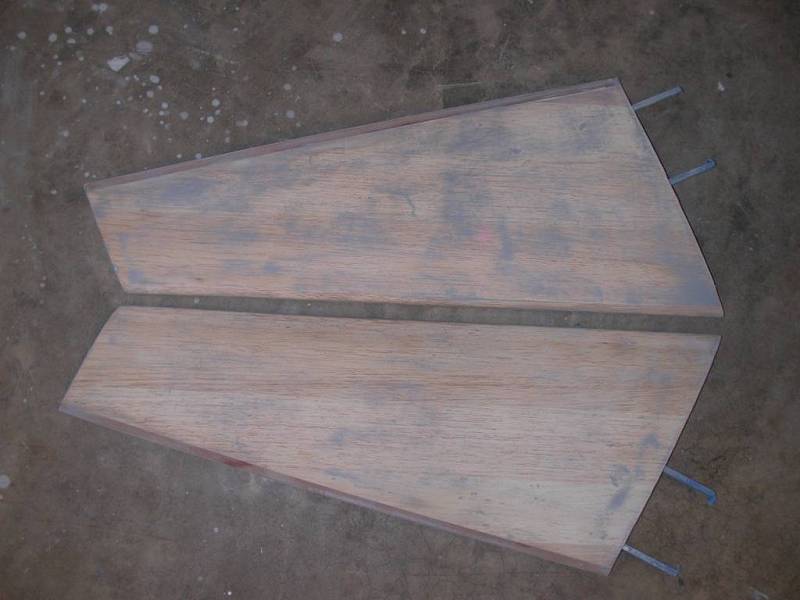

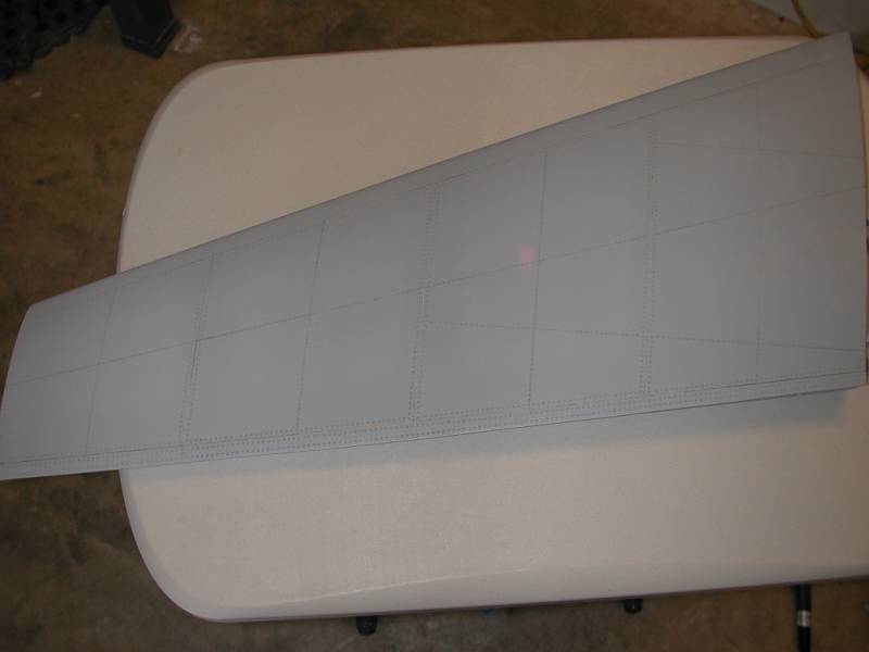

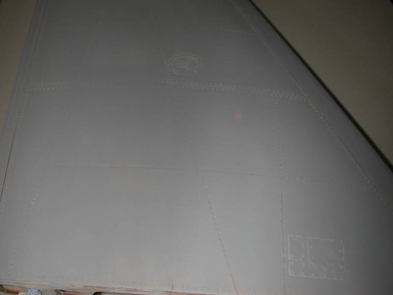

Before glassing the wings a 3/8ths wide strip of 1/64th ply was added to the top T.E. of the wing to provide a hinge line cover. This is not part of the kit but I have been doing this for years.
All of the wood structures have been glassed with 3/4 oz cloth and West Systems epoxy resin. After te epoxy dried, they were sanded and then primed. Filler was added where needed and the structures were sanded again, removing most of the primer.
Panel lines were drawn with a pencil. 1/32nd Chart Pack chart tape was laid over the drawn on lines and the inspection covers were placed on the wing.
A couple of light coats of primer was sprayed over the entire structure. Then a couple heavy coats of primer was sprayed over the chart tape. After the primer dried, the chart tape was removed.
The next step is to add the rivets. These will be burnt into the primer using a low amp soldering iron with an attached 1/16th brass tube. Photo 1 shows the tools I use; a soldering iron, a thin brass strip with holes drilled, and a Top Flite Warbird template. As you can see, the tempate includes rivet spacing for 1/7th through 1/3rd scale and various shapes to make inspection covers. I used the template to drill the holes in the brass strip.
Lines were drawn where I wanted to add rivets that were not next to panel lines. A low amp soldering iron with an attached 1/16th brass tube was used to burn the rivets into the primer. After all of the rivets had been burnt into the primer, the suface of the was wet sanded with 600 grit in preparation for paint.
Kirk

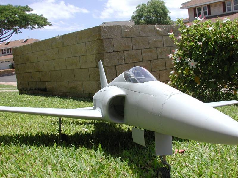

The horizontal and vertical stabs were glued to the fuse. Fillets were made using auto body filler where the stabs joined the fuse. The white gel coat on the fuse was wet sanded with 400 grit and panel lines were drawn and taped just like the wing. Once the primer dried, several thousand rivets were burnt into the fuse and stabs. The fiberglass canopy was cut off and the clear canopy was fitted along with the cockpit provided with the kit. The fuse still needs to be wet sanded with 600 grit in preparation for paint.

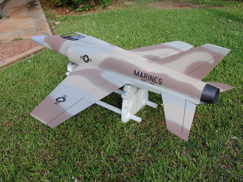

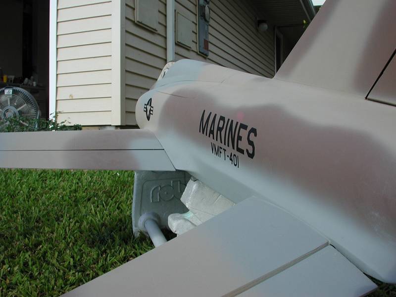

The painting is complete. The colors are the same as what was used on the F-16. Beings this is not a scale airframe, I took the liberty to create a fictious Marine Corps Adversary scheme. I made paint mask for the stars and bars, service name, and squadron codes and pianted with flat black. I will add the rest of the decals after they arrive from Pro-Mark. The cockpit and canopy have not been glue in yet. Once the canopy is glued in, it will sit tighter than it does in the photos. Next step is to start the weathering process and the first step is to rub down the paint with steel wool. This will start to give the paint a worn look and it will also start to bring out some of the details such as the rivets and inspection covers.

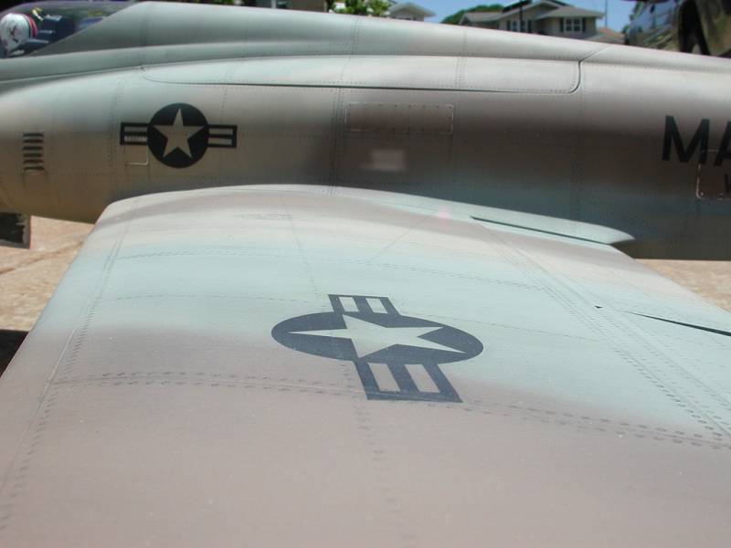

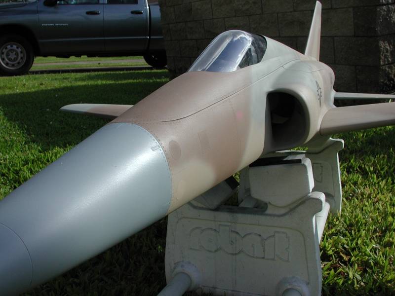

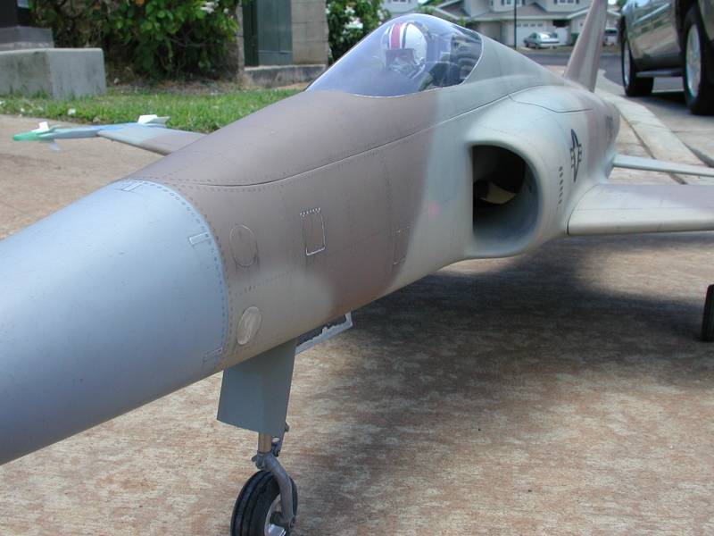

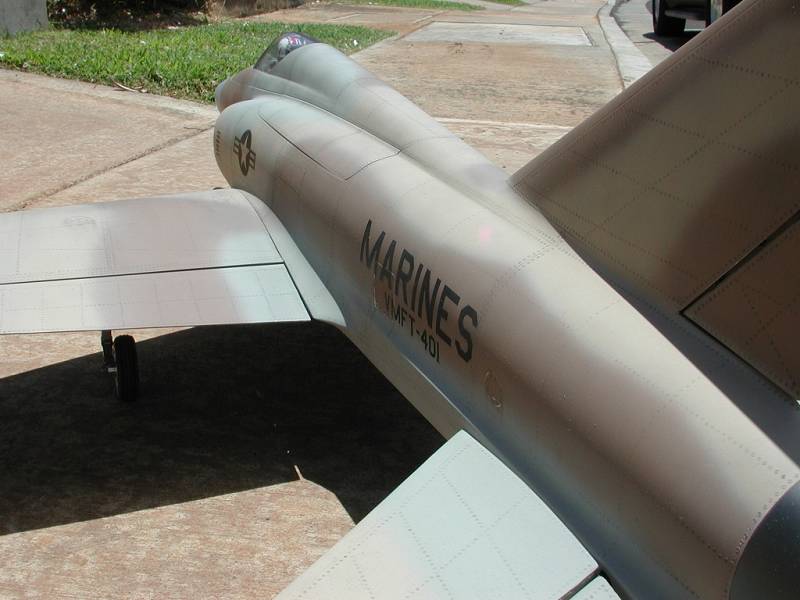

I have started the weathering and detailing process. First, I started rubbing it down with steel wool (right wing and right side of the fuse). I also started the detailing of the fuse (about the first 3/4 of the fuse) by applying dry paint pigment to the panel lines, rivets and inspection covers and then wiping it off with a damp paper towel.
Kirk

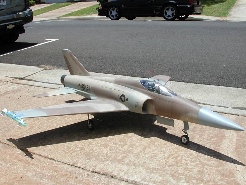

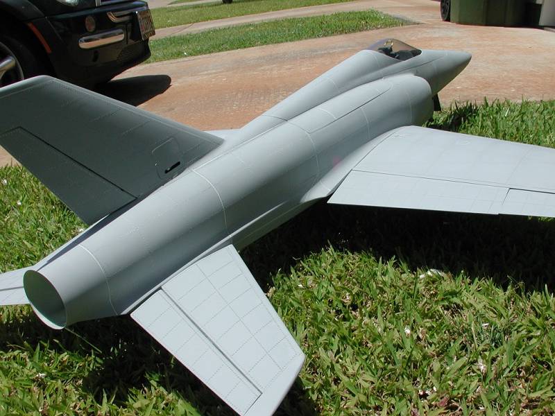

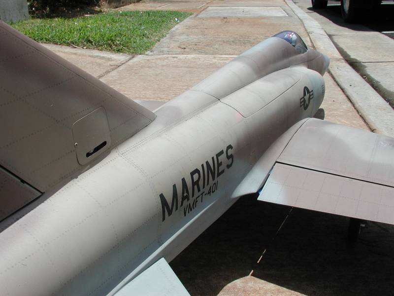

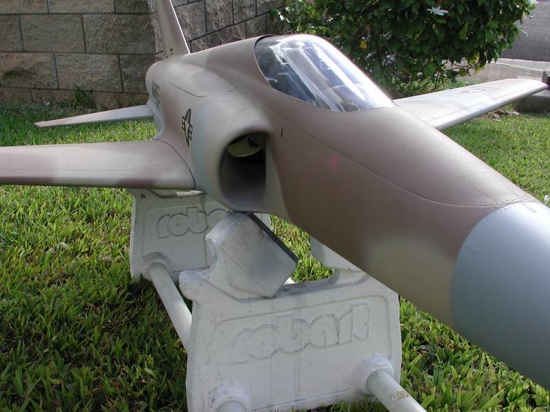

The weathering is finished. The canopy has been glued in place along with the pilot and cockpit. Currently working on the missile rails and missiles.
Things left to do:
- install what' left of the radio equipment (3 servos, receiver, and receiver battery, run servo leads)
- install the fan
- install the flight batteries
Weight in current condition (minus the above mentioned equipment) is 7.5 pounds.
Kirk

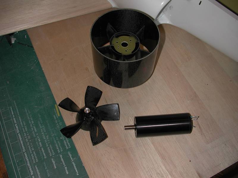

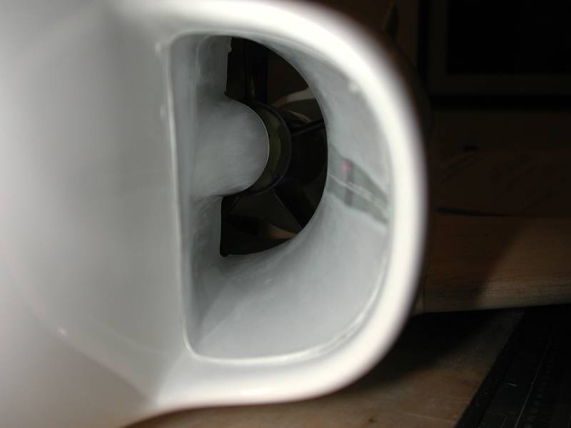

I took the Electra out to the field today and ran the setup on 10S and 12S Thunder Power ProLite 8000 mAh packs. On both run ups the packs were holding at 3.3V per cell. The numbers for the 10S were 127A and just under 4200 watts. The numbers for the 12S were 122A and 4850 watts. The maiden is set for next Sunday and will be performed using TP Extremes 12S (these batteries hold 3.6 volts per cell under load) which should bump up this setup to over 5200 watts. I can't wait
Kirk

Here are the numbers from the WaveOscope doppler program. I adjusted the speed in the upwind to compensate for the head wind and in the downwind pass to compensate for the tail wind and dive using the following formulas:
(Upwind Speed) + (Head wind Speed) = Speed of Pass
(Downwind Speed) - (Tail Wind Speed) - (Est. Speed Picked up in Dive) = Speed
Upwind Pass:
Time on video - 2:01 to 2:11
Speed - 242kph/150mph
Adjusted Speed - 150+10 = 160mph
First Downwind Pass:
Time on video - 2:20 to 2:29
Speed - 340kph/211mph
Adjusted Speed - 211-10-10 = 191mph
Second Downwind Pass:
Time on video - 2:52 to 3:00
Speed - 370kph/230mph
Adjusted Speed - 230-10-15 = 205mph
In the coming couple of weeks I plan to use an Eagle Tree and radar to verify the doppler readings.
Here's a link to the video: [link=http://www.rcgroups.com/forums/showthread.php?t=737082#post8107319]http://www.rcgroups.com/forums/showthread.php?t=737082#post8107319[/link]
Kirk
