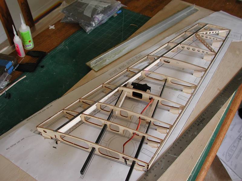

Started on the Electra wing. First one is built and ready for bottom sheeting. I used the flex plate and retact unit from the Maverick. I had to slightly modify ribs 1, 2, & 3.
Kirk

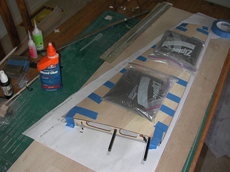

The bottom of the left wing has been sheeted. The right wing has been framed and the top sheeting has been applied.
Kirk
