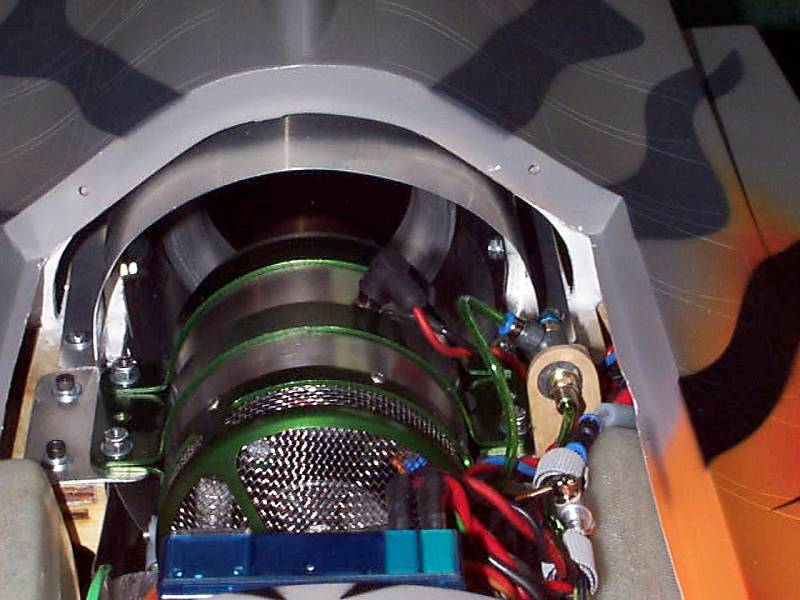

If you look closely at my installation photo you will see that I have put a thin metal u shape under the rear of the engine at the end of the engine to fill the gap between the pipe and engine. I used a piece of thin scrap titanium, stainless as used for the exhaust would do just as well. The reason for doing this if for any reason lighted fuel drips from the engine at startup it will not burn on the epoxy. I did badly damage a model like this once. In theory it should not be needed but I feel more comfortable knowing it is there. The counter to this is that if drips do fall below it they may be difficult to reach with the extinguisher. I have not found it necessary to paint the fuselage all around the point of the gap.
John

Instead of using the U shaped piece of fiberglass that comes with the F-16 I made a heat shield out of .016" aluminum to go over the area between the rear of the engine case to the pipe bellmouth. Also I put aluminum tape on the bypass underneath the engine in that same area. The outer pipe stays relatively cool compared to the inner pipe and as you get further away from the engine the cooler it gets. Nonetheless I also stuck some aluminum tape to the inside of the fuse above the pipe (heat rises), from the engine hatch to about half the length of the pipe. The formers and inside of the tailcone were painted with BVM Heatshield.
Christian

Rob,
There is no top for the bypass. This is a non-bypassed set up.
The part that I was calling a bypass is actually an extension of the inlet. It extends under the engine serving as a shield. It resembles the botton half of a bypass. If you look at the pictures on the FEJ website you will see what the parts look like.
Absolutely not. I have about an inch gap between the engine tailcone and pipe bellmouth. The aluminum is positioned well above and around the engine allowing plenty of airflow to the pipe. As mentioned in my last post FEJ provides a U shaped piece of fiberglass for this purpose (see installation manual). I merely replaced it with a slightly larger piece of aluminum, since aluminum makes a much better heat shield than fiberglass.
I haven't flown it yet (waiting for spring) but I have run the engine a couple of times in the driveway. It has plenty of power and keeps the fuse nice and cool.
Joe
