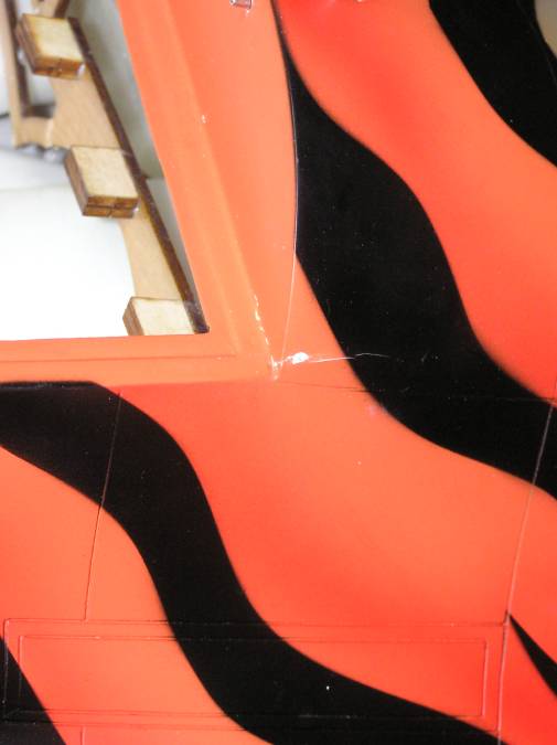

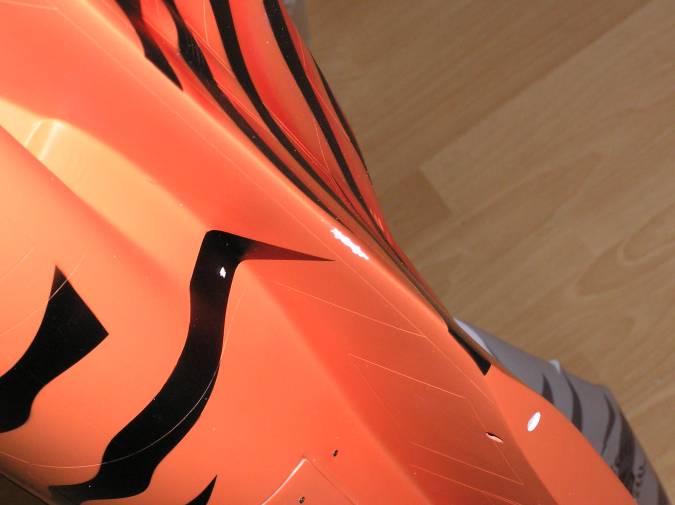

We are now receiving our planes from Fly Eagle, but we found that their shipping box is too flimsy to go by UPS when they arrive at the USA. We know how UPS deliver our planes. It would be a nightmare to deal with. The F-15 box is also over sized for reasonable ground shipping cost within the Gerth.
One of my company's container is going out in a couple of days. I will load up these planes in the original FE boxes to the container for our local California Pick up. However, for the East Coast guys, I really feel the need to make a new shipping box for each one of them. I had told them to hold off the delivery until they repack the planes properly. Here are some photos of the damages from one plane delivered to Europe for our club member there by UPS AIR directly from FE factory. I will talk to my crew and ask them to come up with better packaging. FE is great in service and agreed to replace the products, but it's just a hassle to deal with the exchanges.
Mike
Mike

Hi Mike, Glad to see that FEJ is standing by their products. Their f-16 looks like its going to be a big hit. is the "ace in the hole" coming over in this shipment?
Rich
Rich

UPS ??? What happened to DHL?
They had a much better track record with the early planes that were shipped by DHL. None of these shipping companies are very good, but UPS is the worst. Upgrading the packaging is the right thing to do, however they (you) should also use a company capable of handling them properly. Any savings realized by using UPS will be eaten up by resending all the broken parts.
Joe
Joe
#630
joe, mine was delivered by DHL and still came with some frames broken but as the fej man said this was mainly due to the fact that they fill the internal of the a/c with bits and pieces and with a slight movement they hit the frames.although mine passed from 5 different airports before arriving to cyprus i must admit DHL delivered it in 5 days and in much better condition than those of ups.

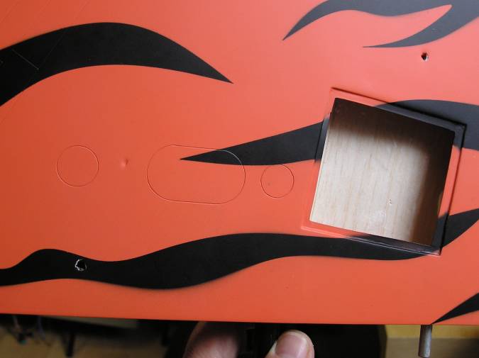

max nitro i think that when they say about the hinging of control surfaces they mean that they drill the holes at the correct distance as per their schematic in f16 instructions
and are ready for you,just to glue the hinges in....what you didnt mention is if they install the tanks as this is included in the price.read my previous post for info.

The Fuel Tanks are 'placed' in the fuse but the klunk and stoppers were not installed, I don't think this is a big deal. I am not exactly sure what is mean by fuel tanks 'installed' I guess they mean they were placed in the correct position.?

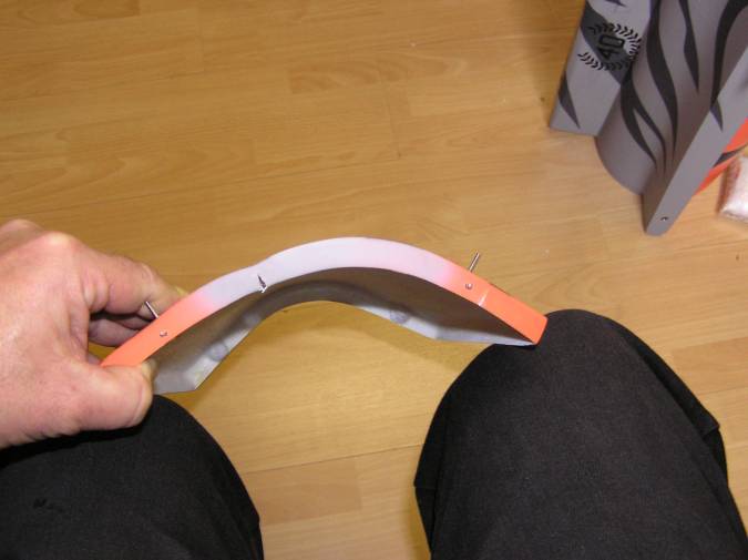

Hi John, thanks for the reply, my kit was missing a few parts with FEJ has sent out (have not received yet but they were just sent out).
I was missing the rudder servo hatch, the ply rings that go in the tail cones to hold the pipe, and I didn't get any parts for the gear door cylinder mount. The small ply pieces they show glued to the doors that the ball screws onto, easy to make though so no big deal
I've got my main gear doors on, surfaces hinged and glued, and elevon servo mounts installed (really nice idea on how those go in too!)
I'll do a little more work tonight, if possible, can you give me some pictures on how your air valves are hooked up? How does the actuation work between the doors and the gear? Is there a switch that actuates it with servo slow? do you need a sequencer?
Thanks!
Jeremy
Thanks!
Jeremy
