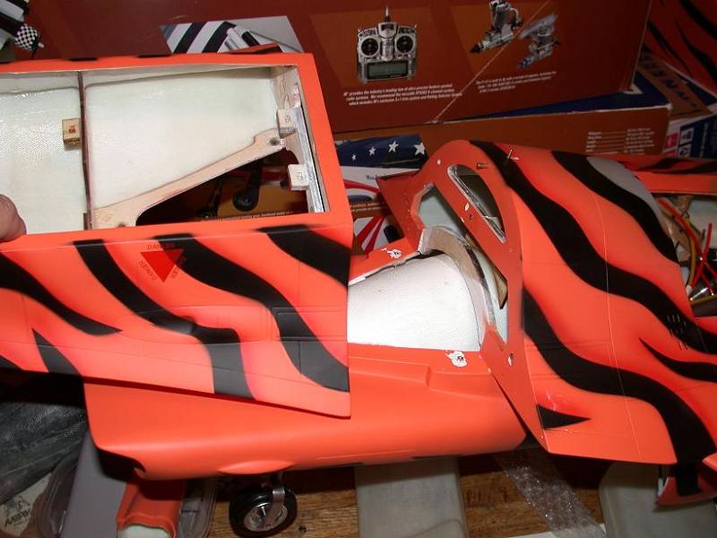

couple more shots of the front end apart..... you can see the 3rd tank removed in the last shot too.
a heads up, the bolts holding the nose section on were only finger tight.
I've also noticed quiet a few of the bolts on the main under carriage are backed out about half way (or never tightened to begin with) and I'm hoping after i take it out and go over the whole thing it solves the one wheel wobbling.
