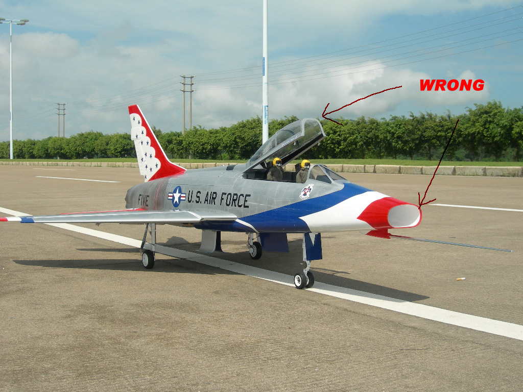

Guys i think molds are not corect and need more work[&o]

ORIGINAL: soufman
comparing a 2 seater (F model) to a single (D model)??

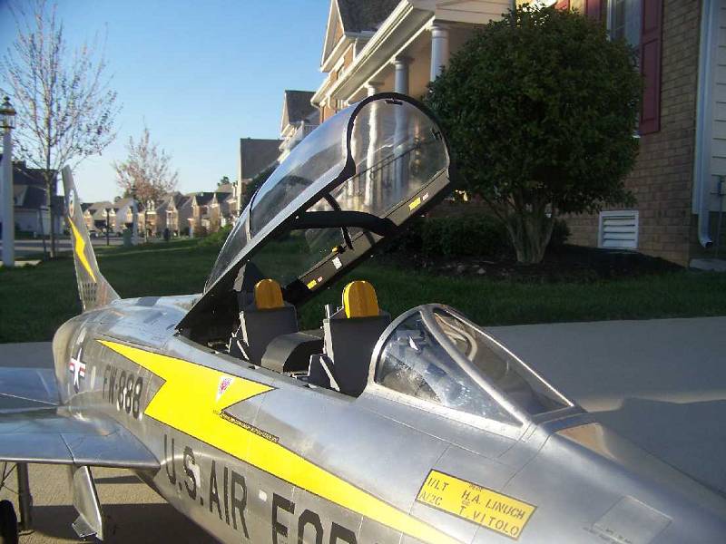

Default RE: FLy Eagle Jet Models
ORIGINAL: KC36330
ORIGINAL: soufman
here you go a twin seater
[] dont wish to start anythink so i stop here.
