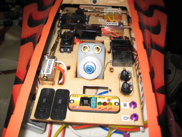

Keith, can you or any others advise me please?
I'm in the process of finishing off an 1/8 F16 advanced version with three tanks.
I'm a bit confused with the fuel plumbing. FEJ diagram shows two tanks plumbed in parallel.
Am I correct in saying that the feed from the main tanks are teed equally to supply the third one and the main tank vents are joined to the small tank vent to the outside of the fuse?
In other words the small tank uses three connections, 1 clunk feed to uat, 2 to common vents and 3 fuel in from main tanks?
Sorry to be a bit thick,
Gary.

Joe, you're an absolute star, thanks very much for that.
I assumed that the nosetank would need to vent, presumably it must do that via the main tanks then.
As a matter of interest what do you use as tee's for tygon, festo's?
Regards, Gary.

Gary,
The nose tank needs to be non-vented. As fuel is drawn from the nose tank it creates a slight vacuum which draws in fuel from the main tanks.
I use tygon up to the pump and get nylon tees from an auto parts store, the type that are commonly used for automotive vacuum hoses. Also since tees add considerably to system restriction I buy oversized tees and force them into the tygon. For example if the saddle tanks are plumbed with 1/8 inch tubing I would use a 5/32" tee. Then the single line after the tee would be 5/32" tygon. Remember that the line after the tee has to flow twice as much fuel as each line before the tee.
Another way to reduce system restriction is to not use a tee. Instead install two vent tubes into the nose tank and run each saddle tank directly into the nose tank. You need to insure that each vent tube is identical and have equal lengths of hose from each saddle tank. Here's a picture of how I did that on my F-16.
Joe

Thanks again Joe, I'll do that. It looks from your pic as if you have removed/modified the former at the cockpit rear to take your front tank.
Mine is the one supplied by FEJ which is really akward as it is flat fronted and squashes against the former which means the tubes have to go at right angles to avoid kinking. Good idea to have your uat facing rear also.
I'll post a pic when I get home this evening.
Regards,
Gary.
Regards,
Gary.

Joe, just took a some pics, have to drop the uat more to clear cockpit details, the guy I got it off already put the pump mounting in so I guess I'll have to have a forward facing uat!
See what I mean about the front tank, I think I'll have to bend the pipes at 90 degrees, I'm terrified of kinking the tygon.
Gary.
Gary.

That center tank is not the best design. This is the one I have: http://www.rcuniverse.com/market/item.cfm?itemId=556105
Global Jets was selling it for this application before FEJ came out with their version. I don't see it on Global Jets website any longer. It's 22 oz., not 20 as stated in the ad.
Check out those FEJ air valves to make sure they work properly. Most guys had trouble with them leaking, as well as the rest of the air system . I finally gave up on mine and installed a UP3 valve for retracts & doors, and a UP6 brake valve. Also I went with Airpower door cylinders. The 1" throw Airpower cylinders are almost a drop in replacement.
Joe
Joe

Thanks for that Joe, I normally use Jetronic valves but as these babies had already been installed I thought I would try them.
I have read the whole thread a couple of times and noted the horror stories!
I have had the valves apart and siliconed them etc and they are all holding 120 lbs for at least three days so may try them.
The stb gear did not want to retract fully but I traced that to a leaking nipple in the air cylinder.
Also the front door doesn't want to close fully so I will take your advice on the rams, Gary.
