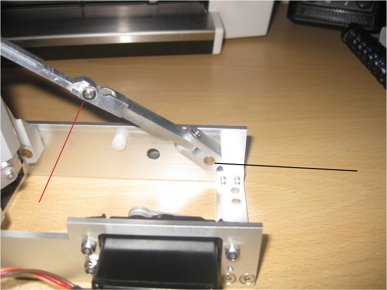

Hi Joe, or anyone with an F16, I need a little more help please on my F16 ADV.
She is progressing well and I have now turned my attention to the dreaded pneumatics.
Attached a pic of port brake disc. Firstly the disc seems to be seized on the axle, secondly the aluminium disc has no brake lining material attached to it.
Am I correct in thinking that a) the disc should move along the axle when air is applied to the system and b) the disc should have brake material attached to it?
Also, the wheel was not holding air, after dismantling I found that the o ring had been fitted incorrectly and had been squashed at one point, anyone know of a supplier of such things please?
Gary.

Gary,
You might want to contact James at their USA office. His contact information is on the FEJ website. He has been good in the past about answering questions and sending replacements for problem parts.
My brakes look different than yours. Yours look like they may take a large o-ring to sit in a grove around the circumference of the hub. Mine is an early standard F-16 and is equipped with Airpower wheels & brakes. They are the disc type shown on FEJ's website and the 33mm. brakes shown on Airpower's website.
http://www.flyeaglejet.com/f16%20Accessories.html
http://www.airpowernet.com/twe3/prod...products_id=27
Also here are the Airpower wheel seals if James isn't able to send you some. My main wheels are 76 mm.
http://www.airpowernet.com/twe3/index.php?cPath=12_38
Joe

Gary,
I believe I have that setup on my F-16 (not advanced). The way it works is the sir would push up the o-ring and contact the wheel to stop it. The main disk will not rotate, it is fine. if you have air leak around the tire, then use some heavy silicon grease on the interface of the tire and the wheel and tighten the screws in x-pattern, pump it up and retighten if required to stop the leak.
Regards,
Mike

Thanks guys,
Mike, the brakes are also leaking, presumably from the o ring/bellows. If I needed to change or check the bellows I can't see any way of removing them because that outer disc is fixed solid.
I see what you mean about the rubber bellows expanding into the wheel though. I would expect the rubber to wear out fast!
Do you mean use silicon on the wheels instead of an o ring?
Joe, thanks for links etc.
Regards to you both,
Gary.

What Mike is saying is that it appears you do not have bellows/disc type brakes. They look like the o-ring type, similar to BVM.

Hi Gary,
I would use the silicon between the interface of the tire rubber and the wheel frame where the tire edges are sandwiched. I am sure if I understand what you mean about the brakes leaking? Is it leaking around the nipple or somewhere else?
Regards,
Mike

You got it Joe, that's the baby, never seen that system before, just gotta find the leaks now.
Mike, I suspect the brake bellows may be damaged but now know what I am looking for it's gonna be a lot easier.
Thanks again guys, much appreciated,
Gary.

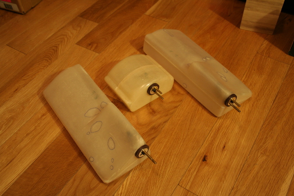

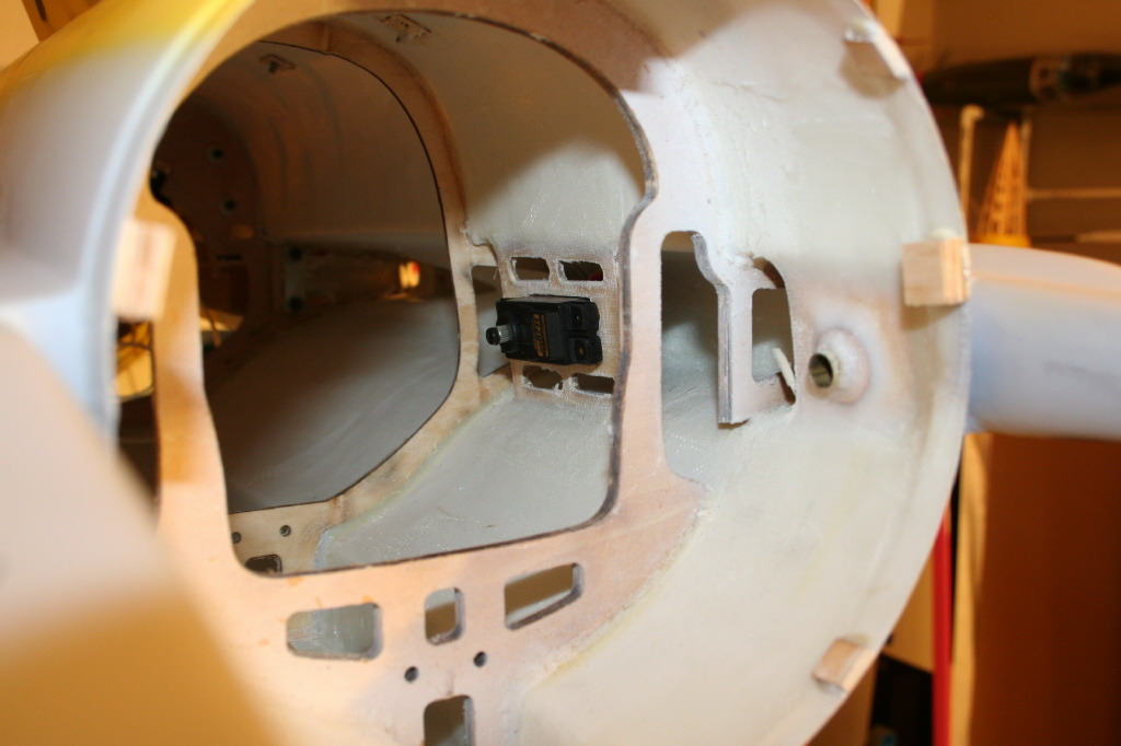

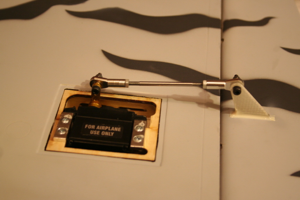

Default RE: FLy Eagle Jet Models
Hi.
My name is Young.
I recieved FlyEagle F-16 1/8 Advance Two months ago.
and almost finish.
I will post some pic this forum .
If somebody has questions or technicaly advice talk to me.

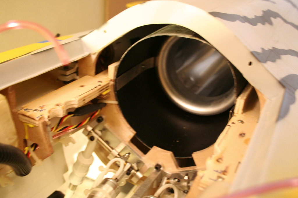

I'm in the proces of putting my 1/8 F16 advance together and notice now that the mains have 3 cylinders, whats the third centre one doing, wonder what the chances of upgrading mine to one of those would be, i'd prefer the white retracts
lozza

that 3rd Cylinder is Lock and UnLock process.
I'm using EV5U at gear door and retract.
and one more use EV2U valve to that cylinder.
I found the manual for this randing gear at same company 1:5 1/2 scale F-16 manual...[8D]

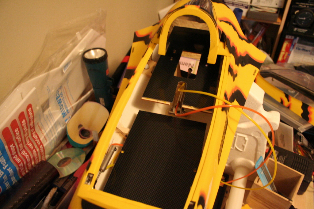

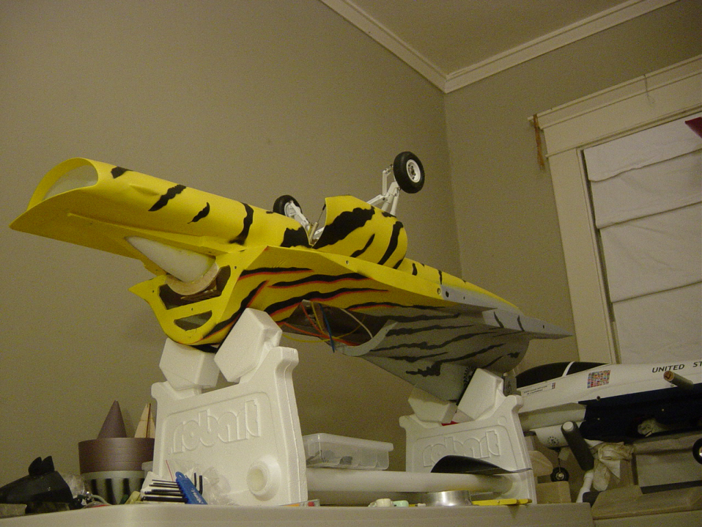

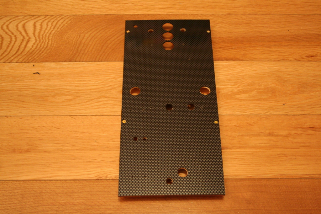

  #1897
Joined: Jan 2007
Posts: 16
From: Los Angeles, CA
Hi.
I finished Elevator and Rudder.
and test fit Engine setting.
I warry about over weight the P-120SE...

If you have an advanced F16 Juan and your nose gear is collapsing you can fix it. I had problems with mine collapsing I just modified it and now it will rip off out of the plane before collapsing. Many others had that same problem. All you have to do is regrind the flat spot on the pivot shaft that retracts/ extends the nose gear drag link to give it more travel when it extends. It'll put more pressure on the drag link in the down position and will make it virtually impossible to collapse.
F16 1/8 ADVANCED VERSION
Ok to try and clear this up, does he mean regrind the flat on the spindle ( indicated by Black line) which will force the drag link up (indicated by Red line) keeping it locked straight, if this is the case have you guys done it on the cylinder side of the spindle where theirs two grub screws, or the drag link side which has one larger grub screw.
Also i see the mains now have three cylinders third acting as a lock any guys had problems with the two cylinder set up.
Cheers in advance
lozza

Glad you asked that Laurie, I'm in the same boat at the moment!
Gary.
