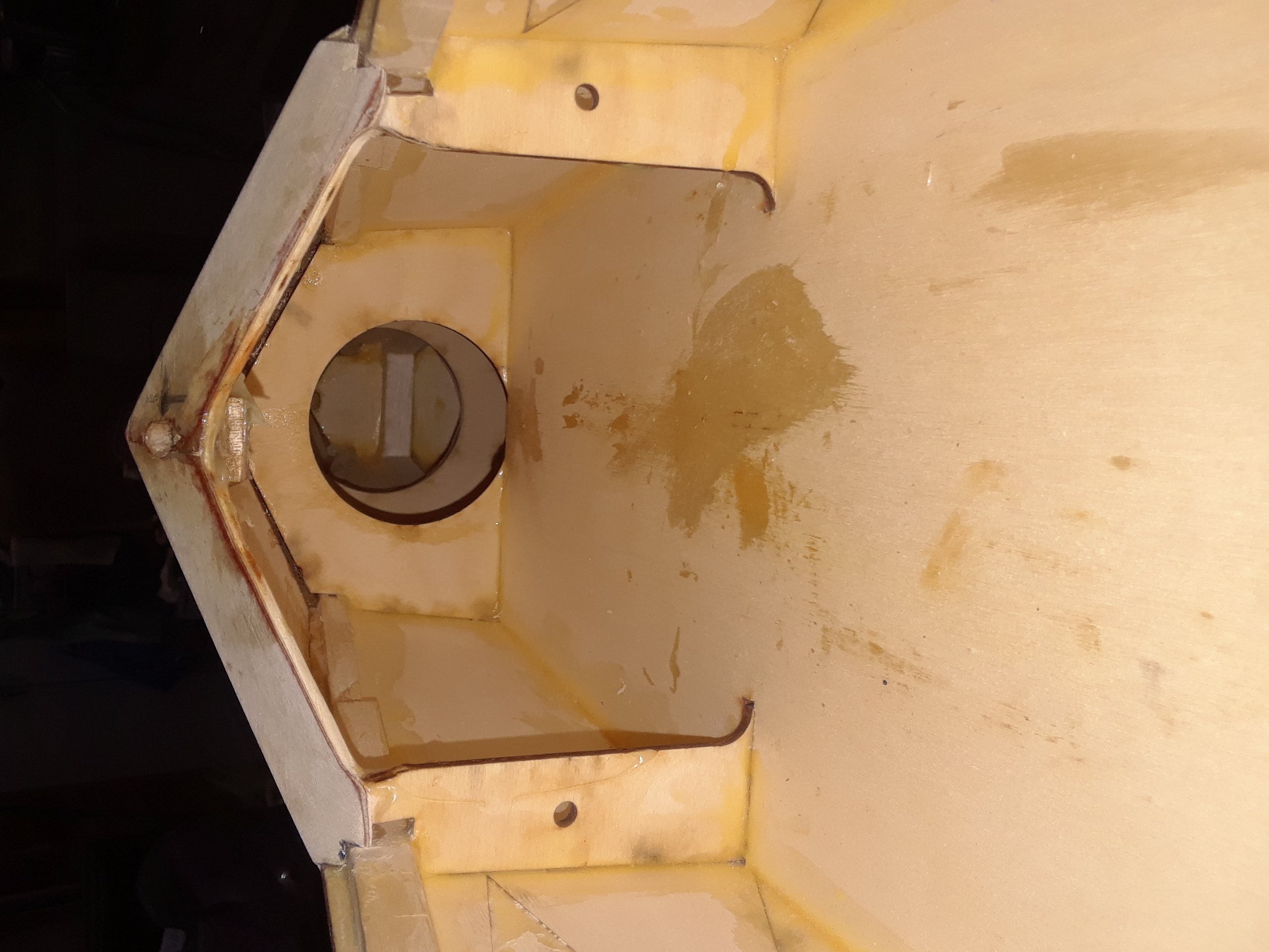

Dan what did you use for a heat shield material on the underside of the fuse aft of the turbine?
Hi.
I used the stainless steel plate.
I did not have enough stainless steel sheets and I also used a piece of aluminum sheet to the tail.

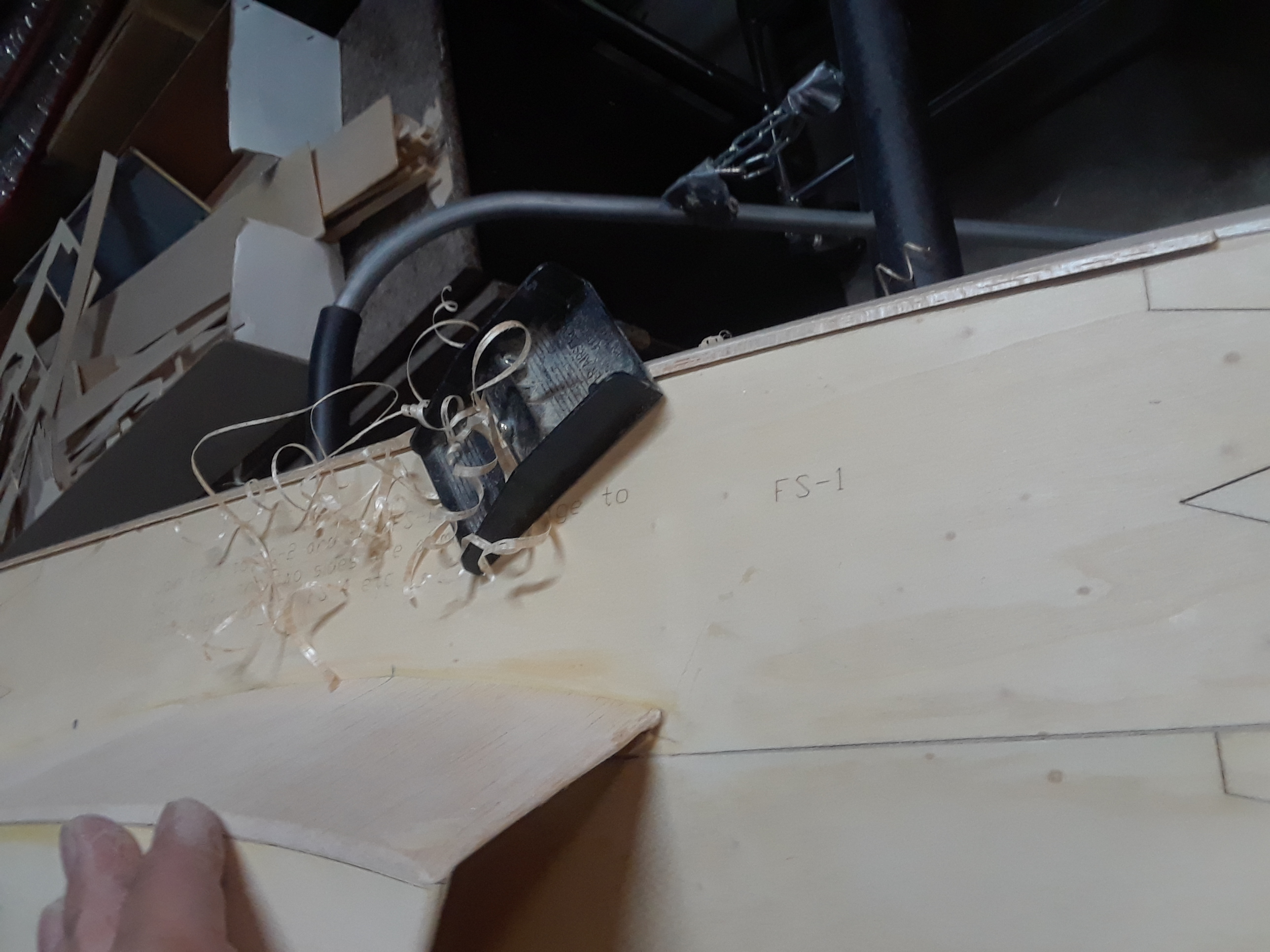

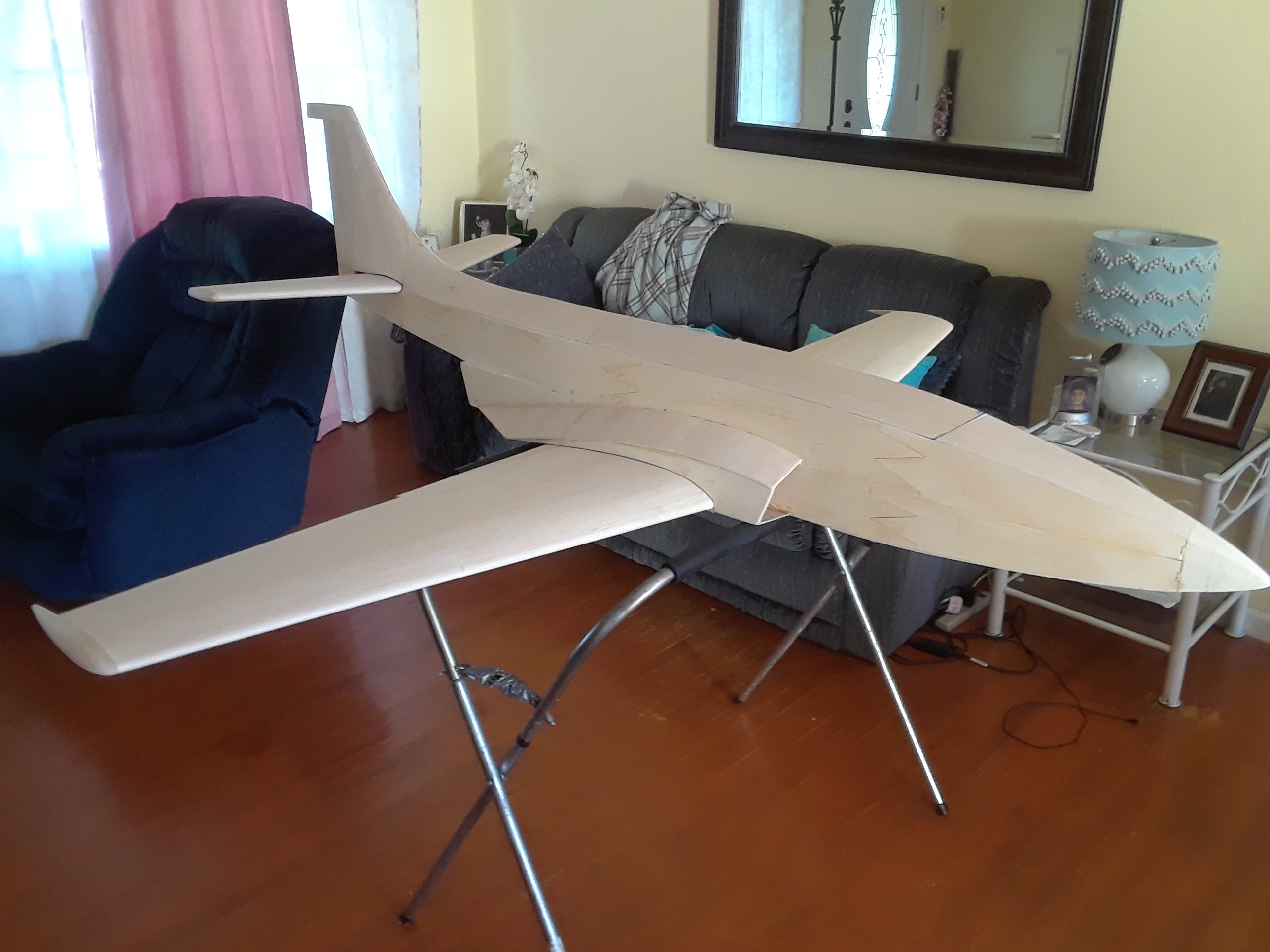

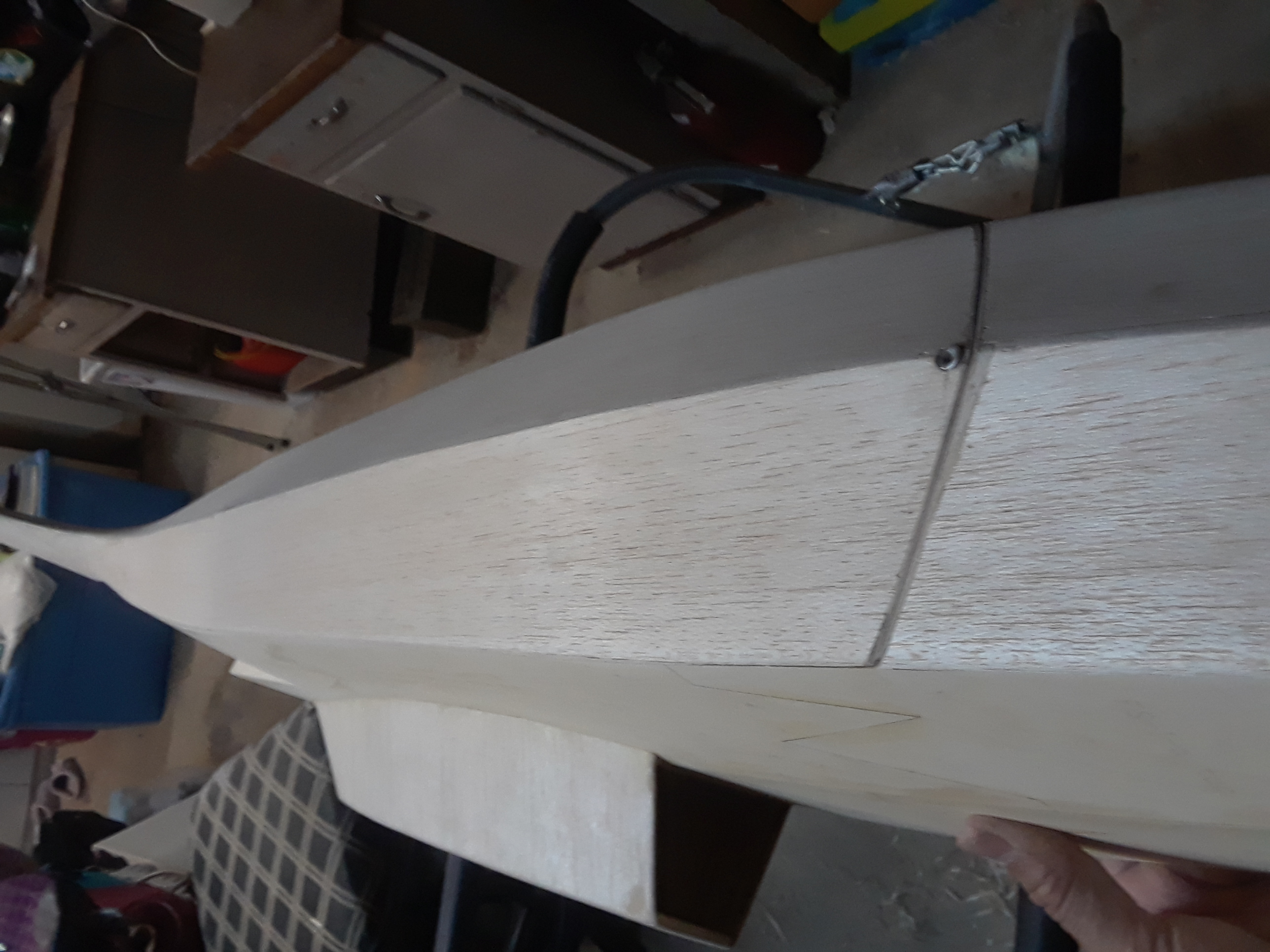

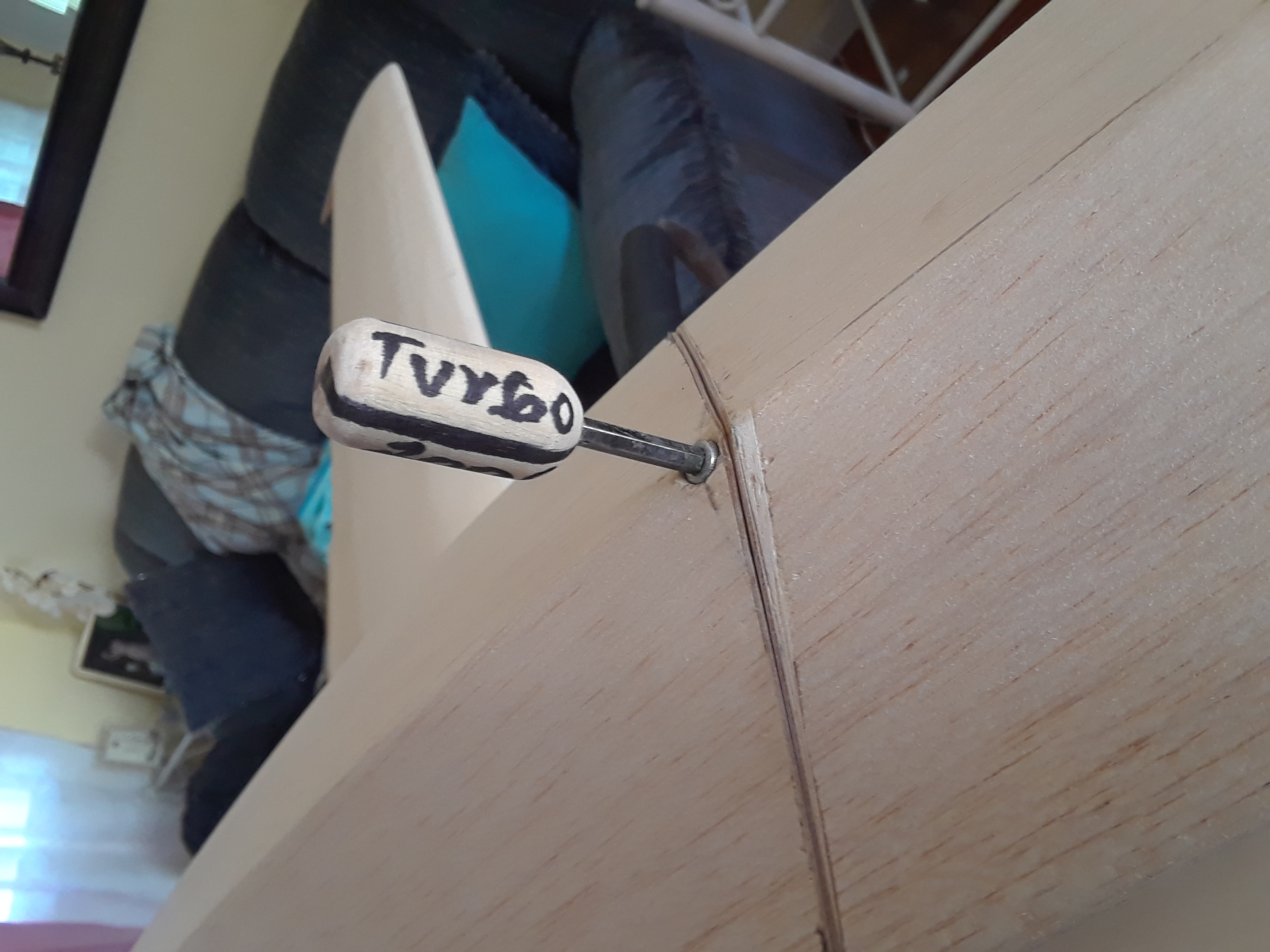

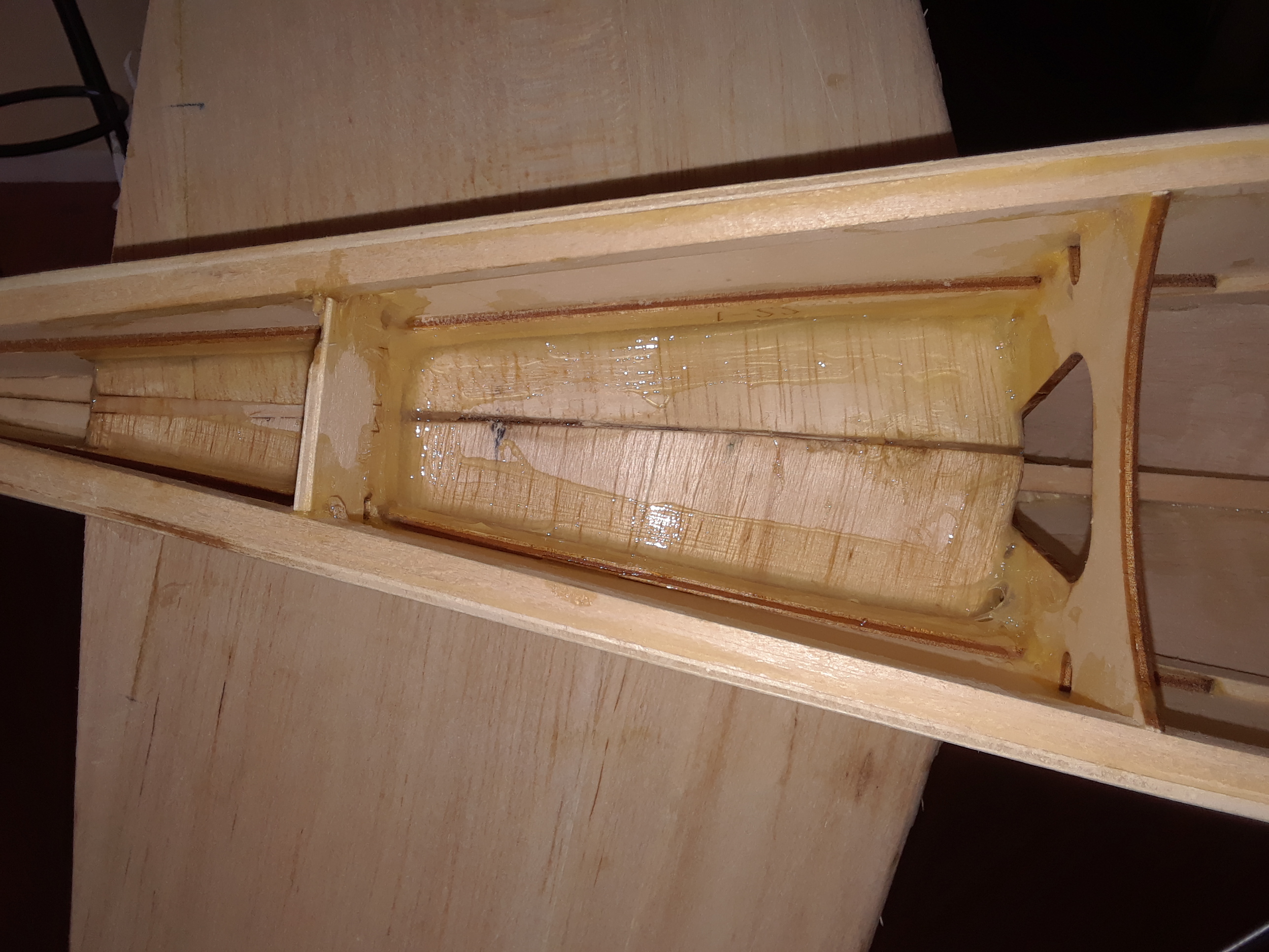

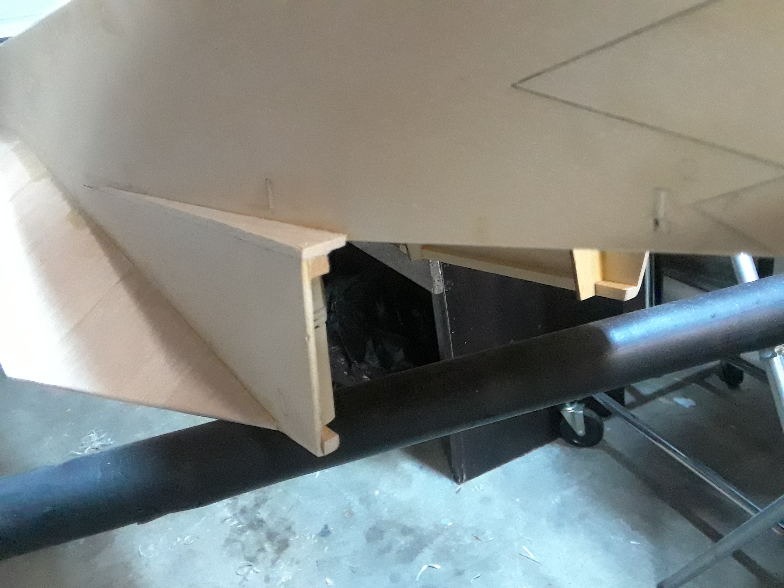

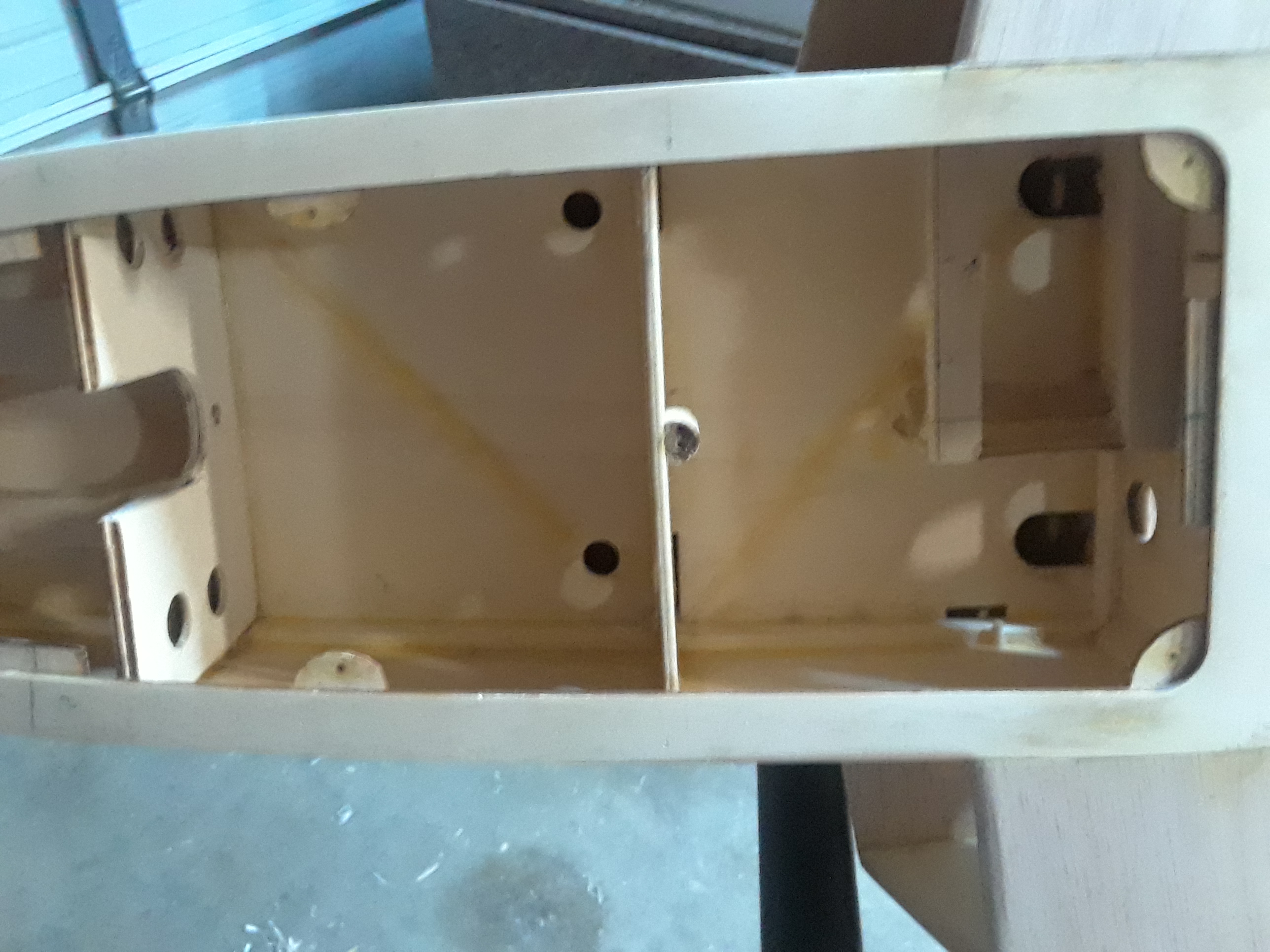

Some work done on the hatch last night.

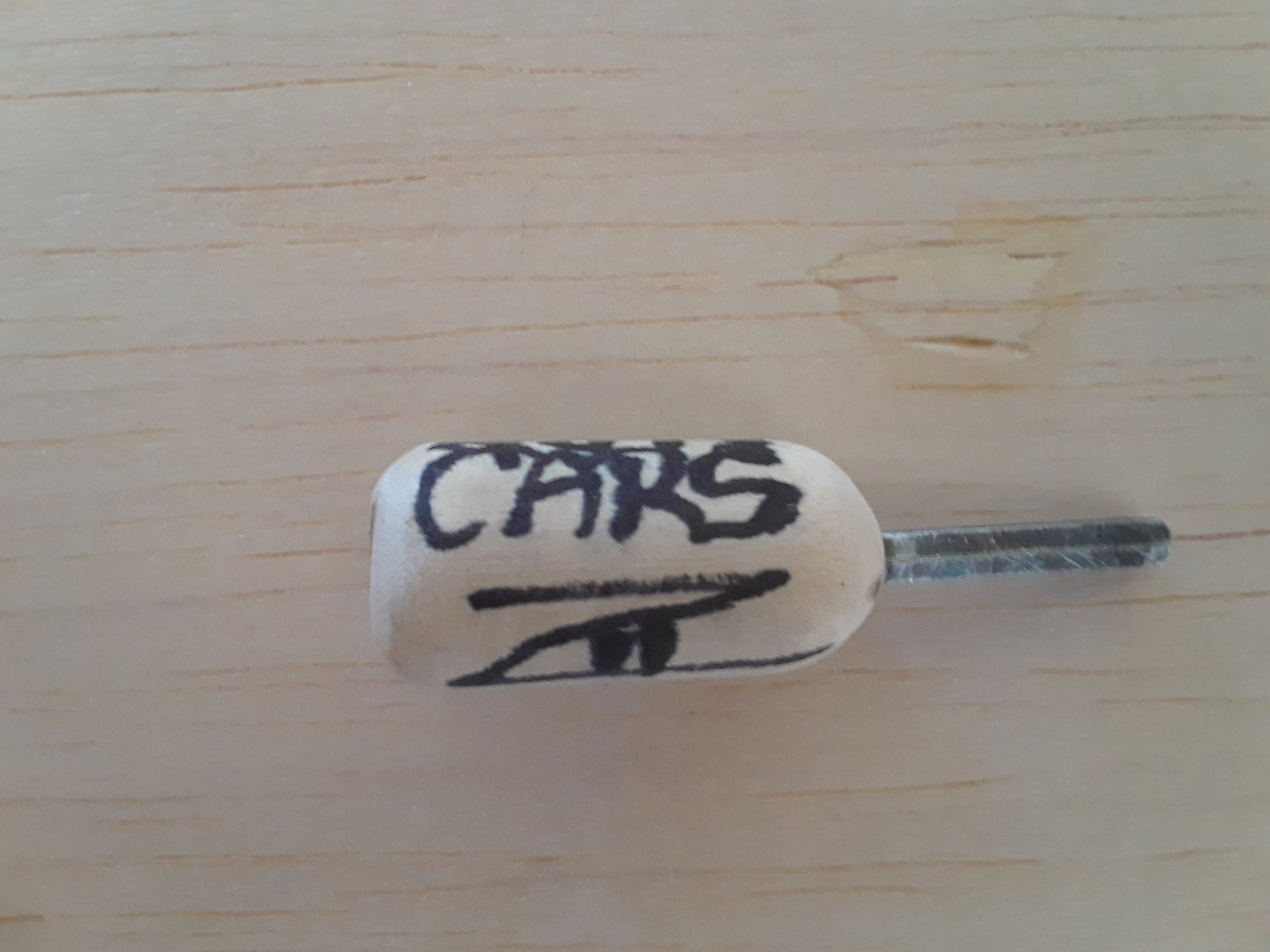

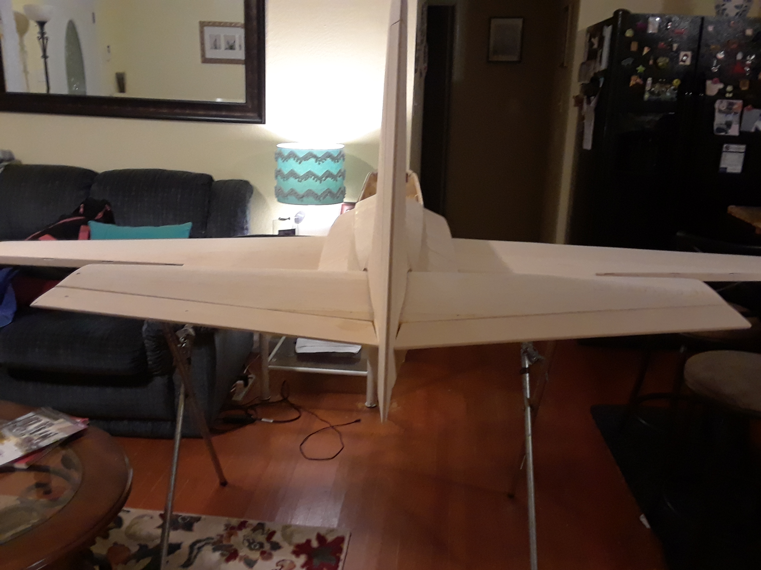

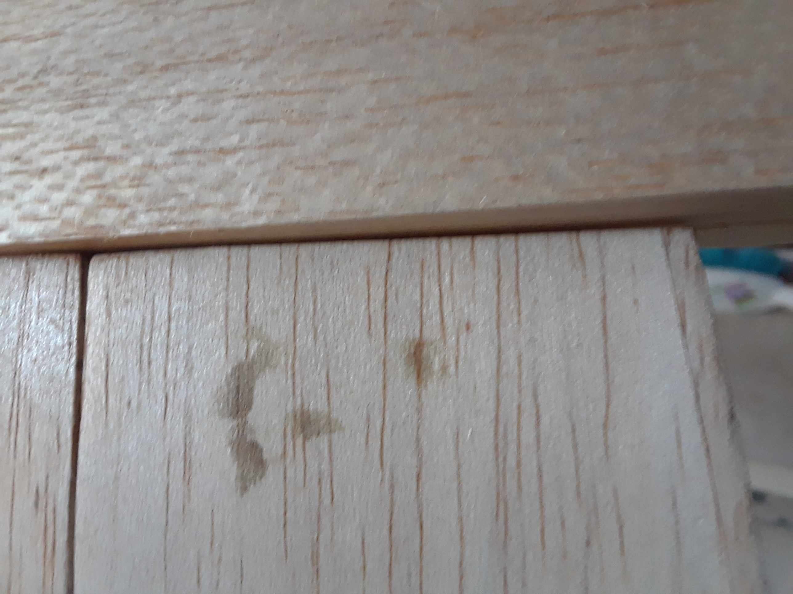

Other picture. The cat was asking if she can ride the jet
CG related
One thing I noticed on the plans regarding CG is that it tells to measure it from bulkhead WJ2, when the wing is on and you measure the CG you most likely will be measuring at the wing leading edge where it meets the fuse which is about 1/2 inch back from WJ2 position.

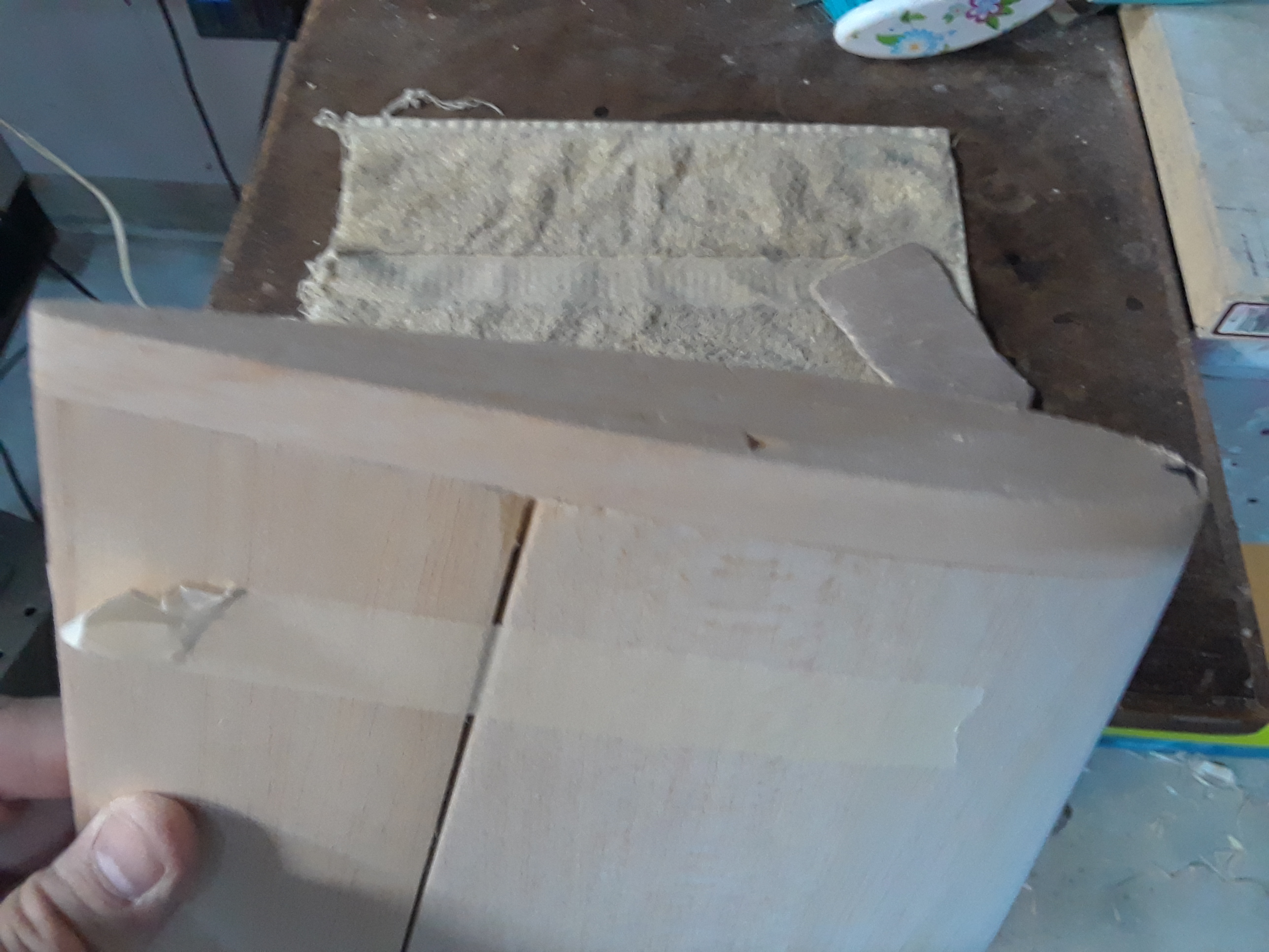

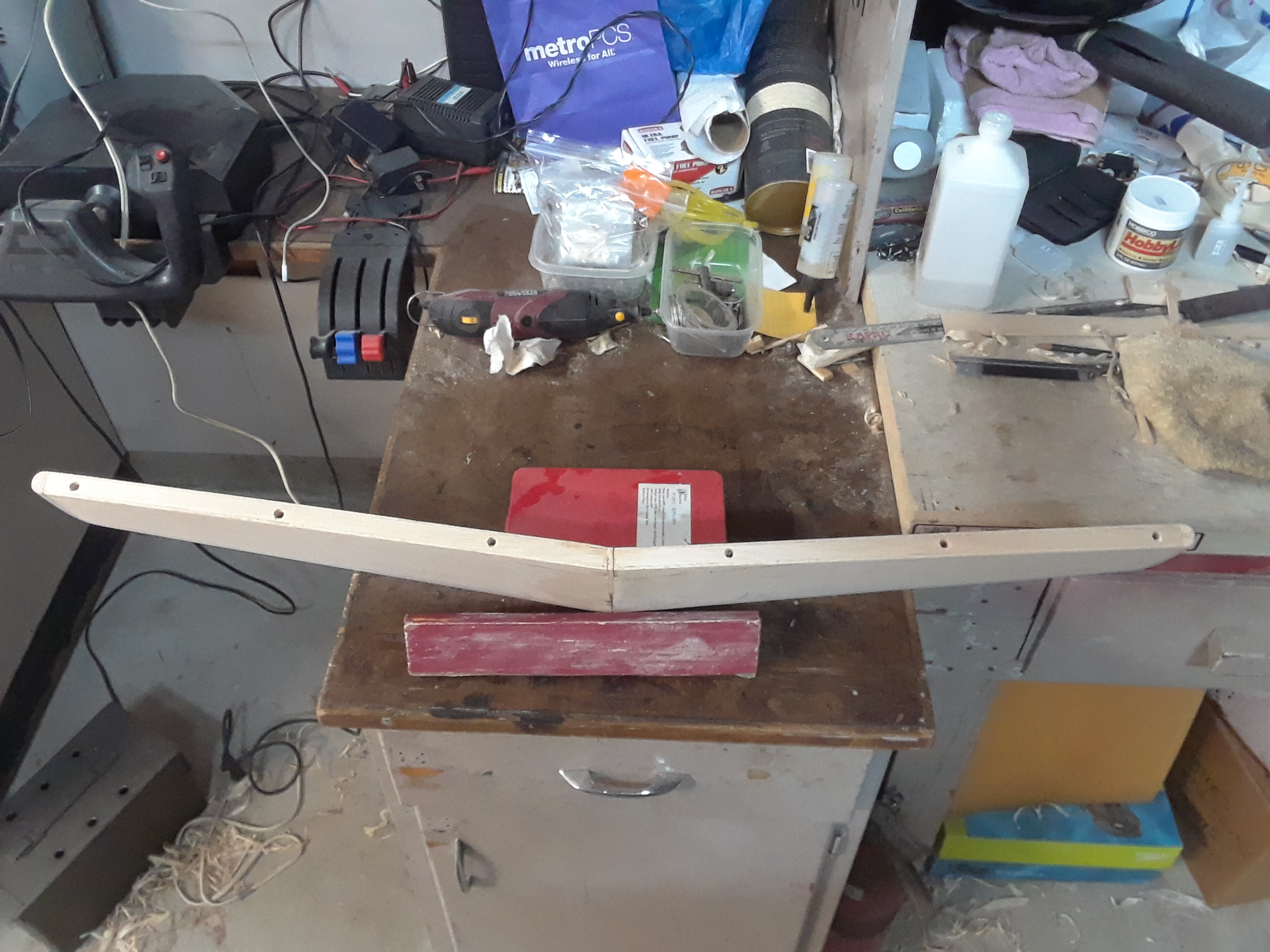

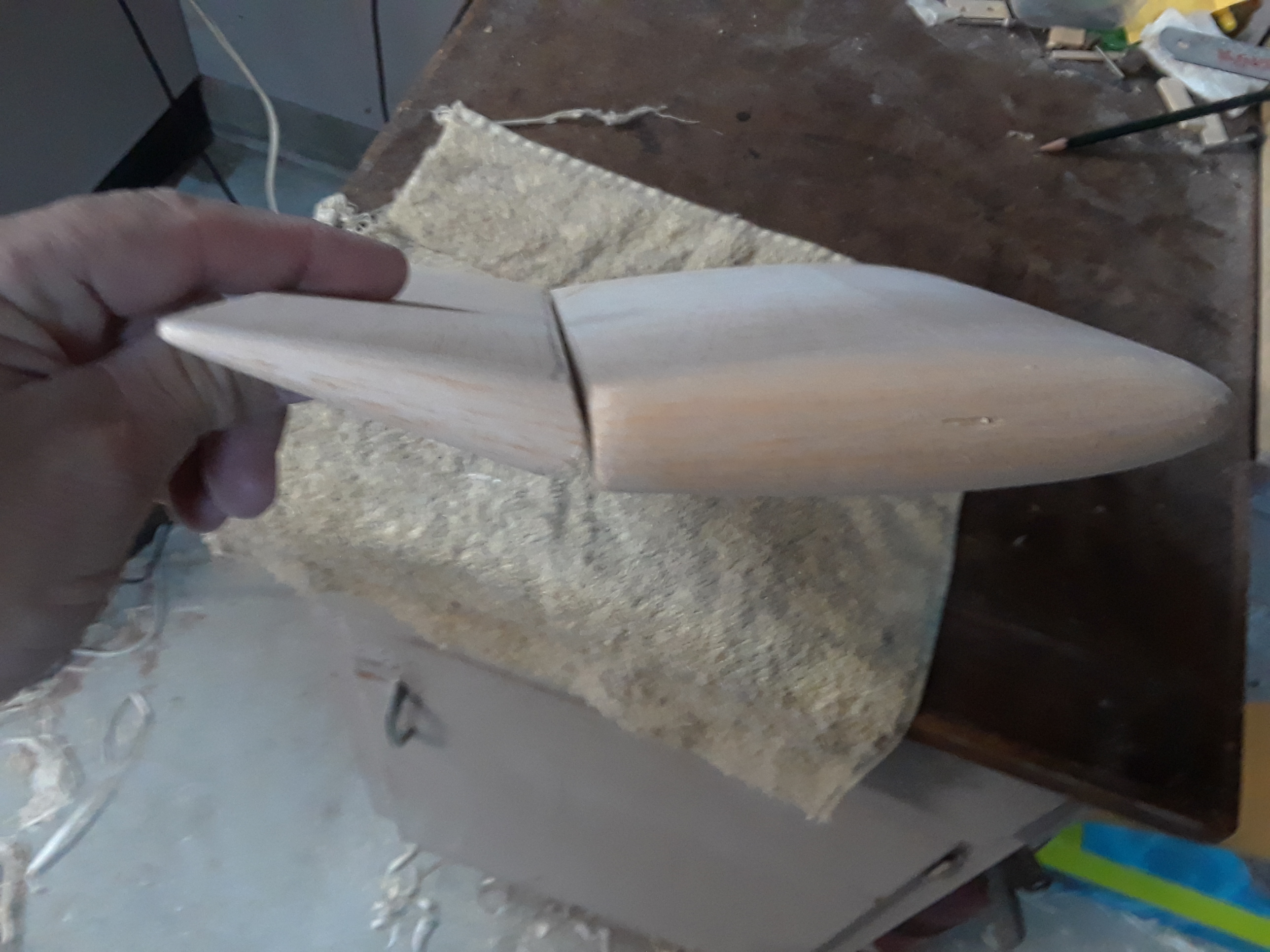

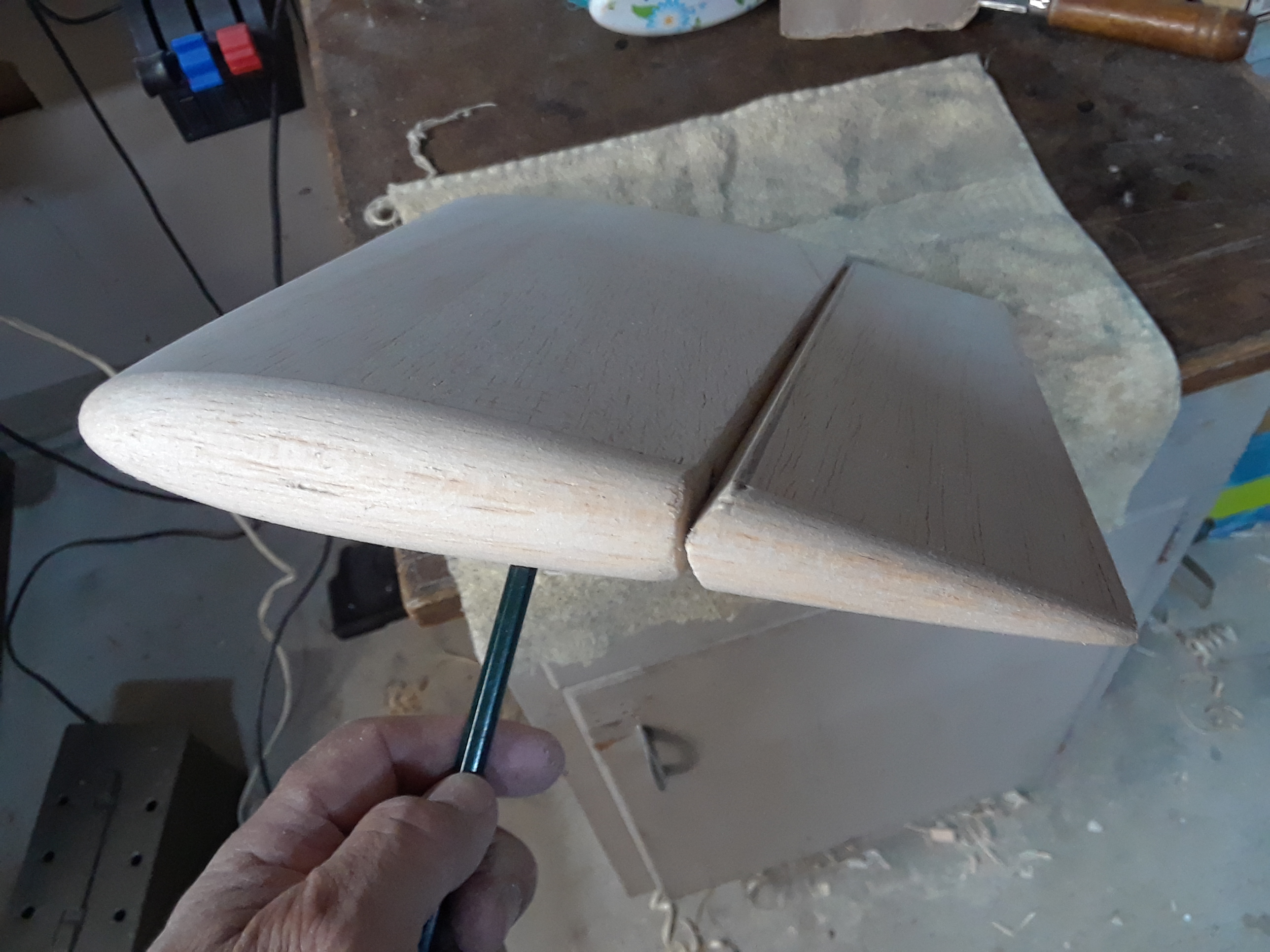

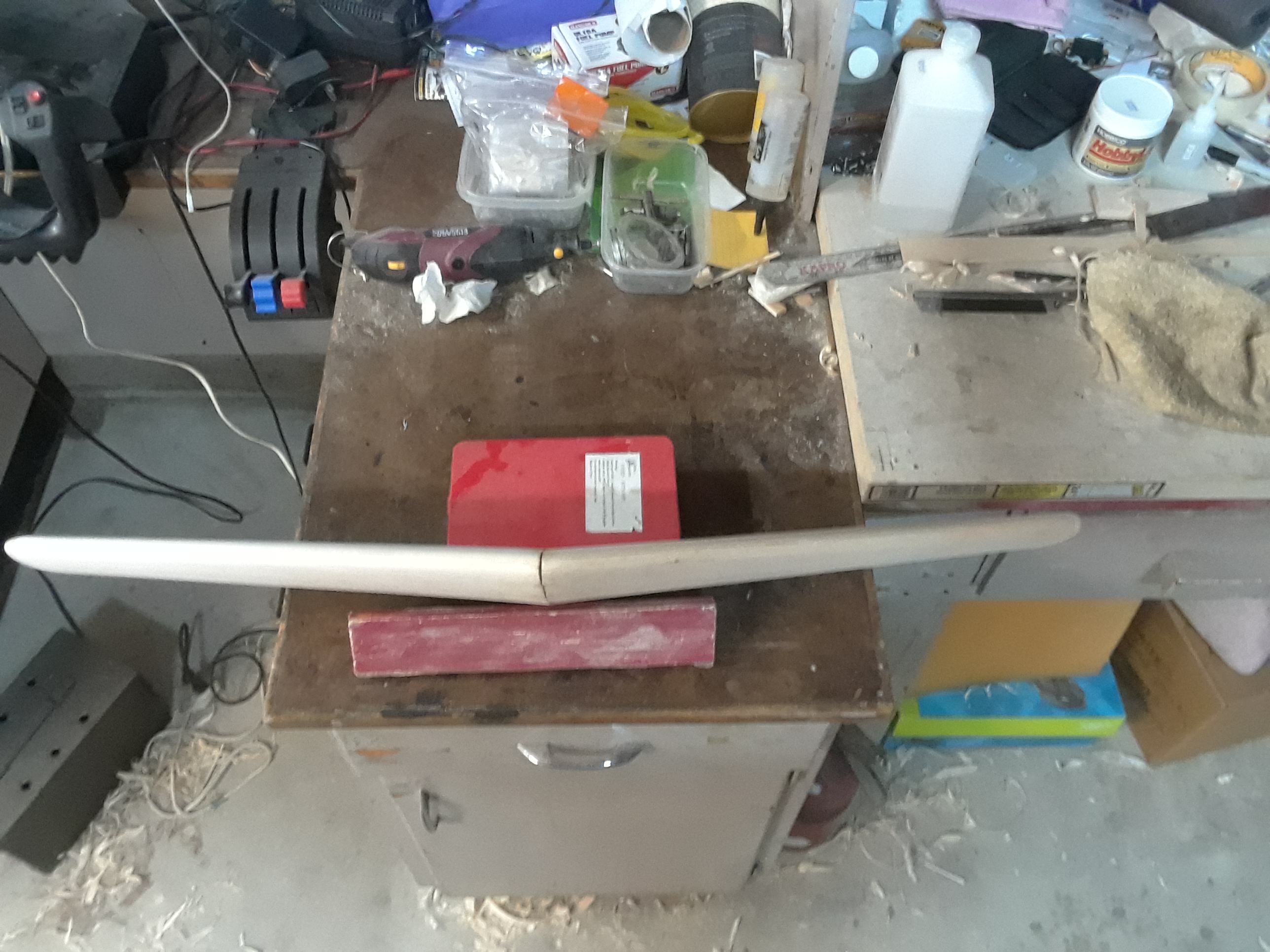

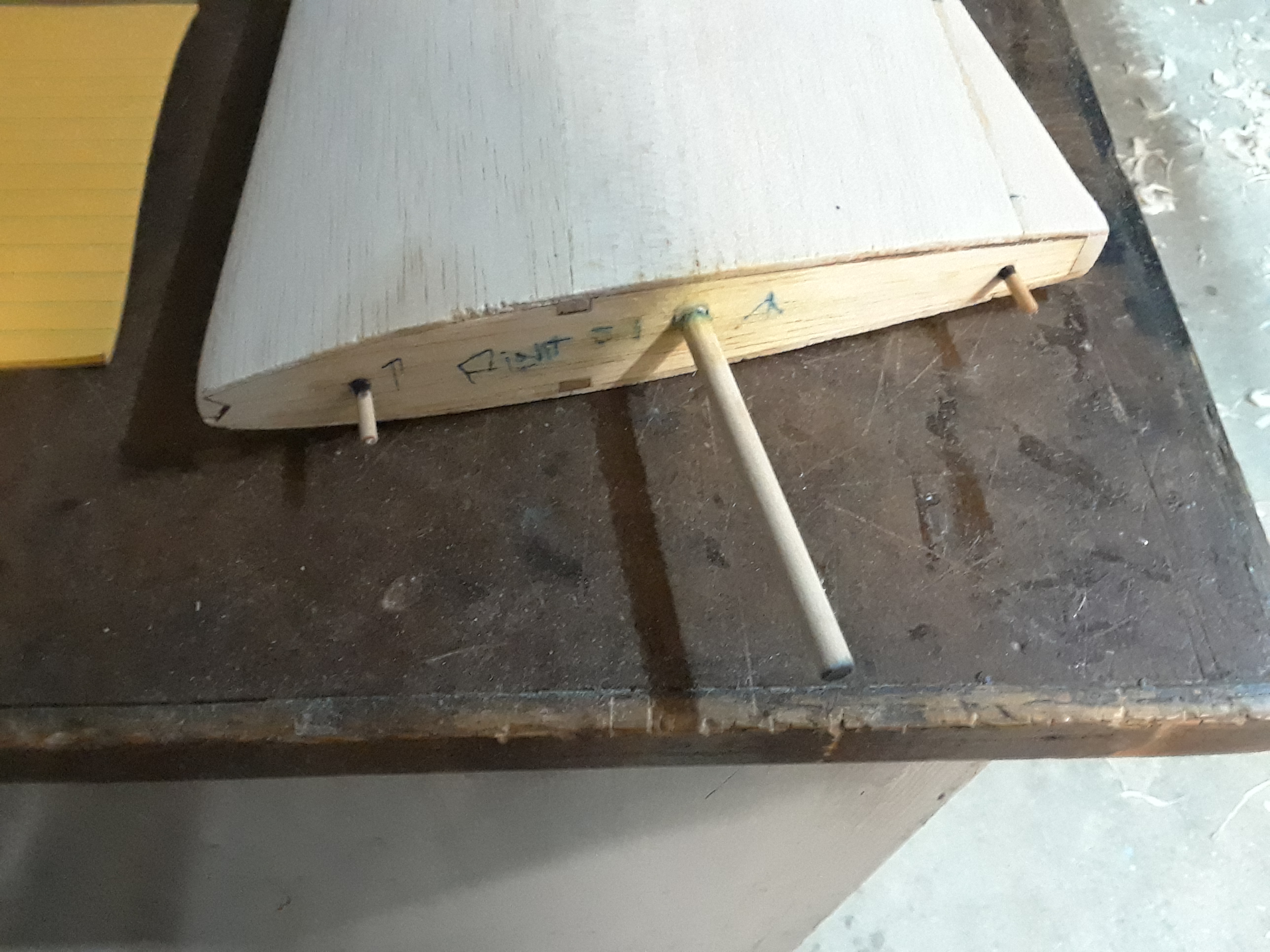

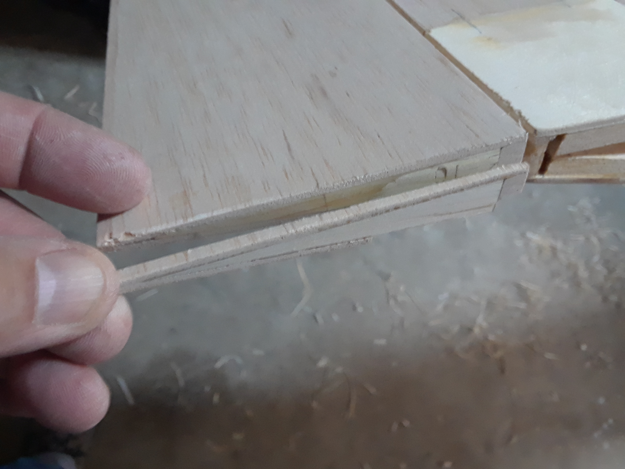

some work done on the rudder today.

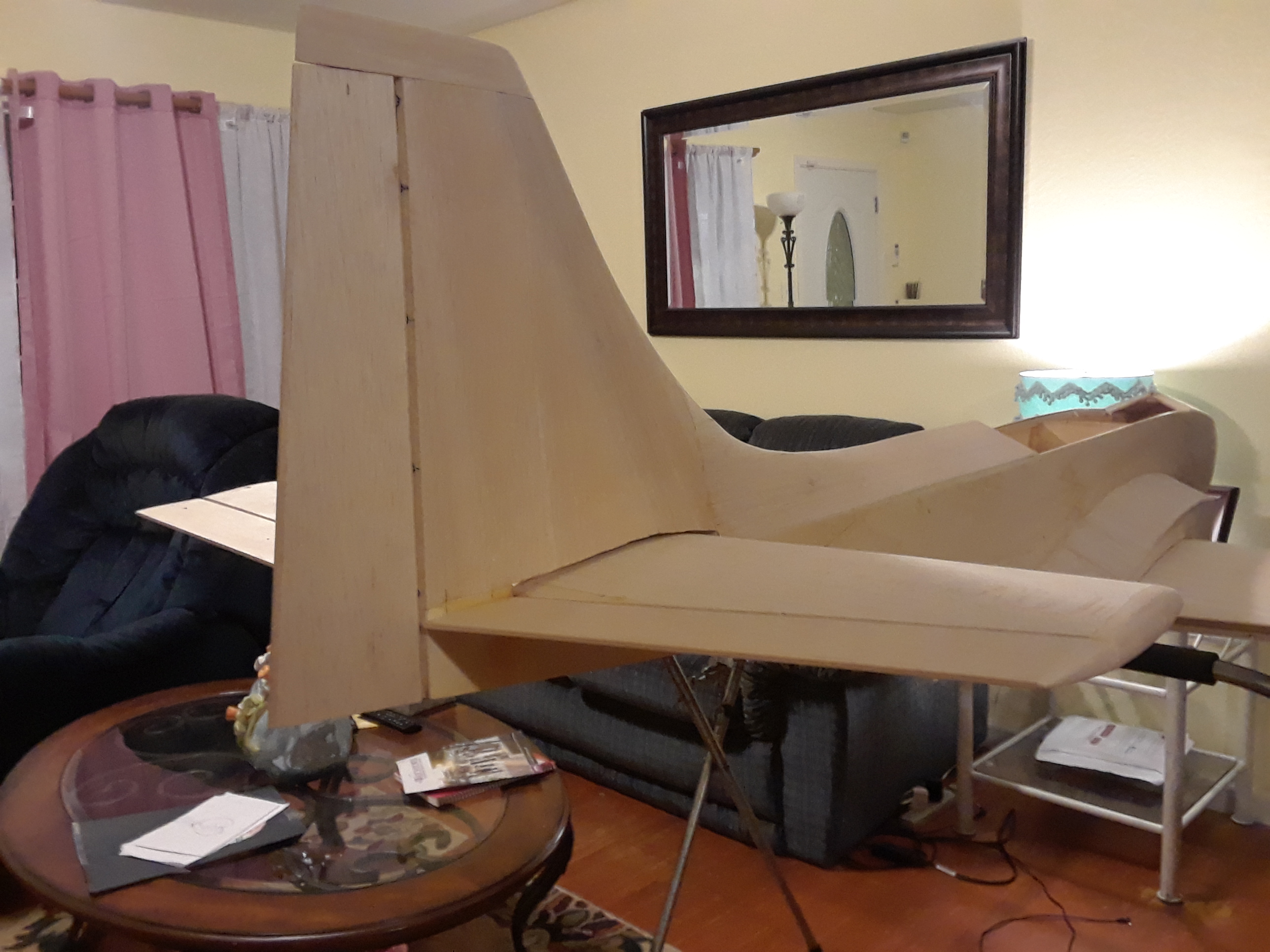

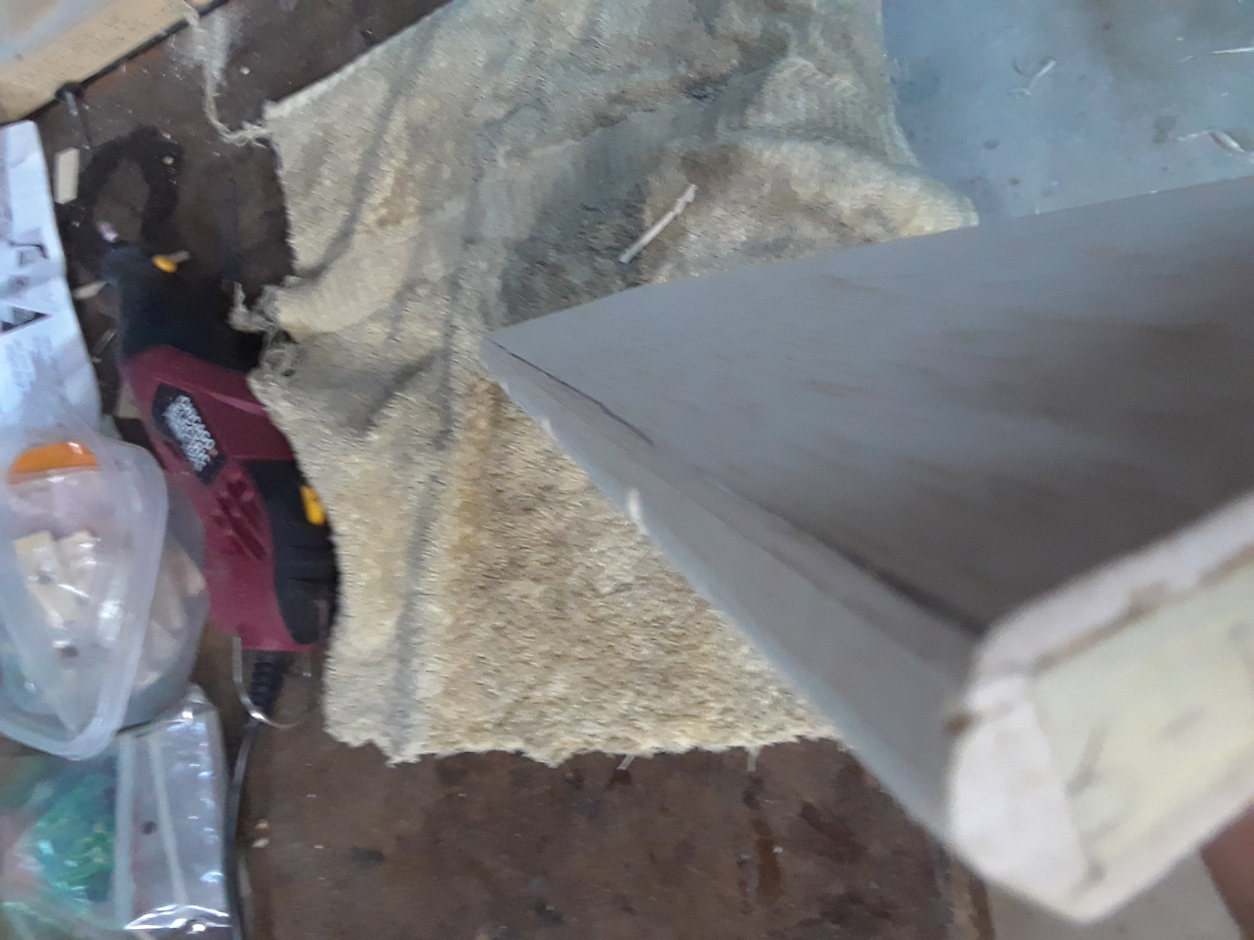

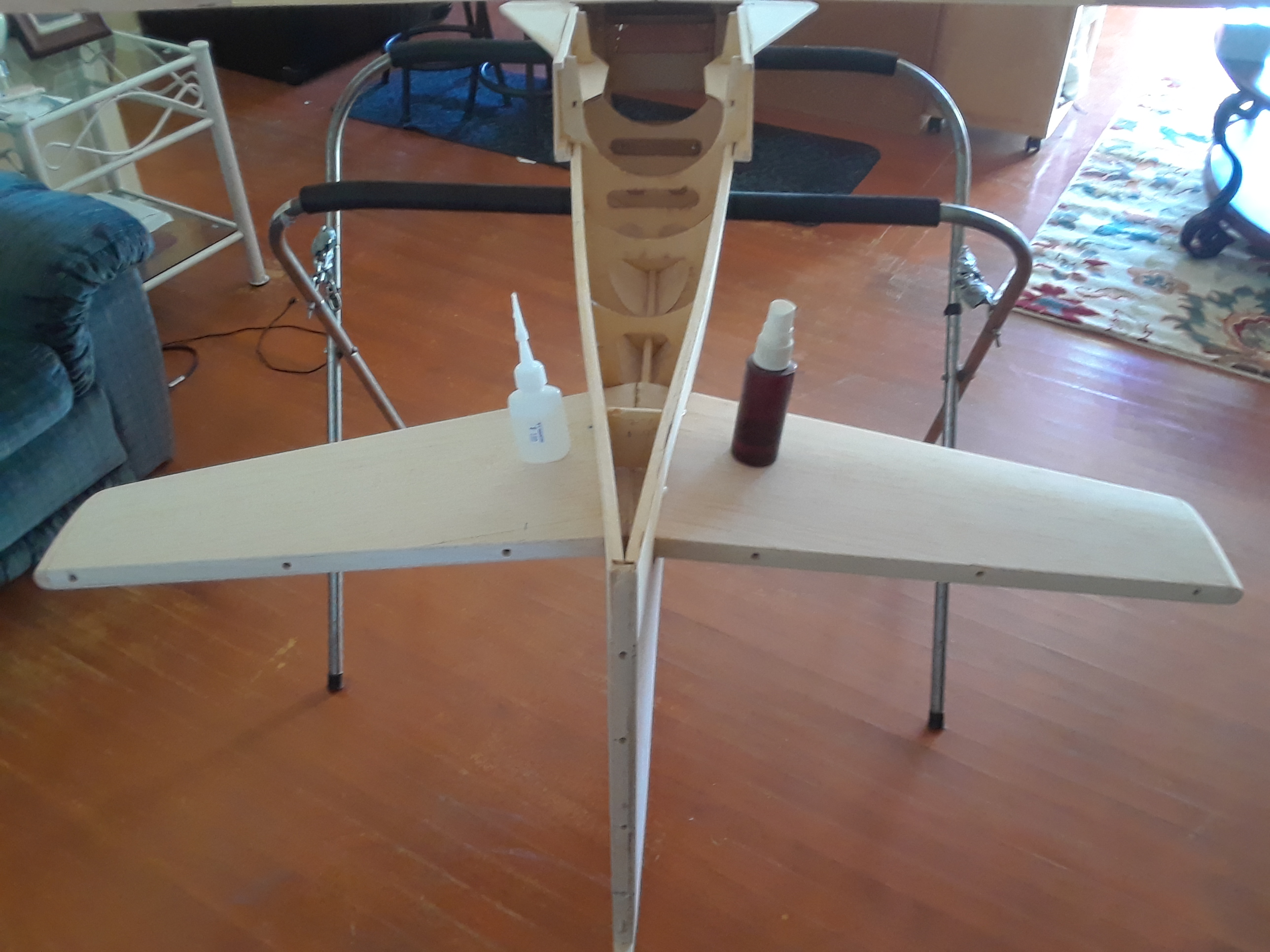

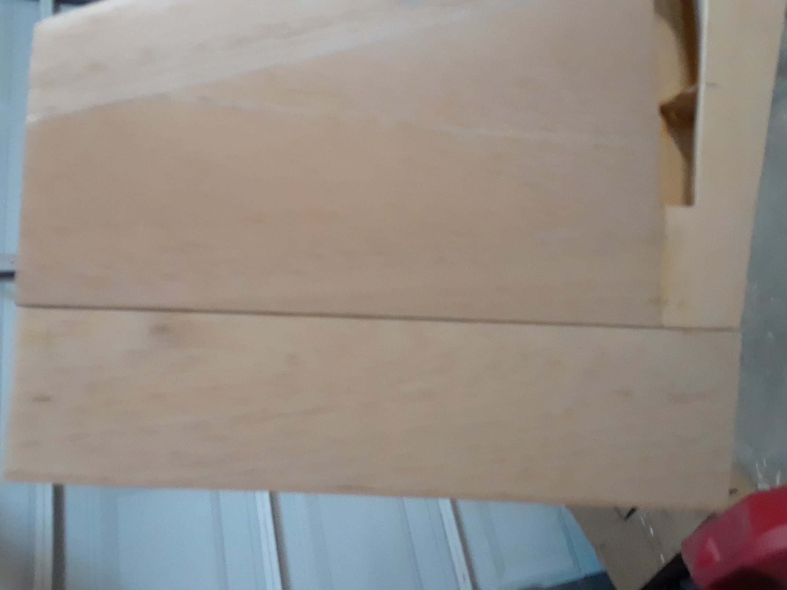

Right stab and elevator are done, continuing with the left side.

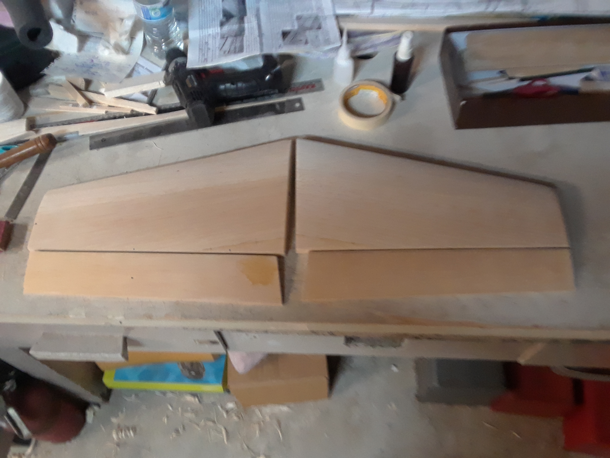

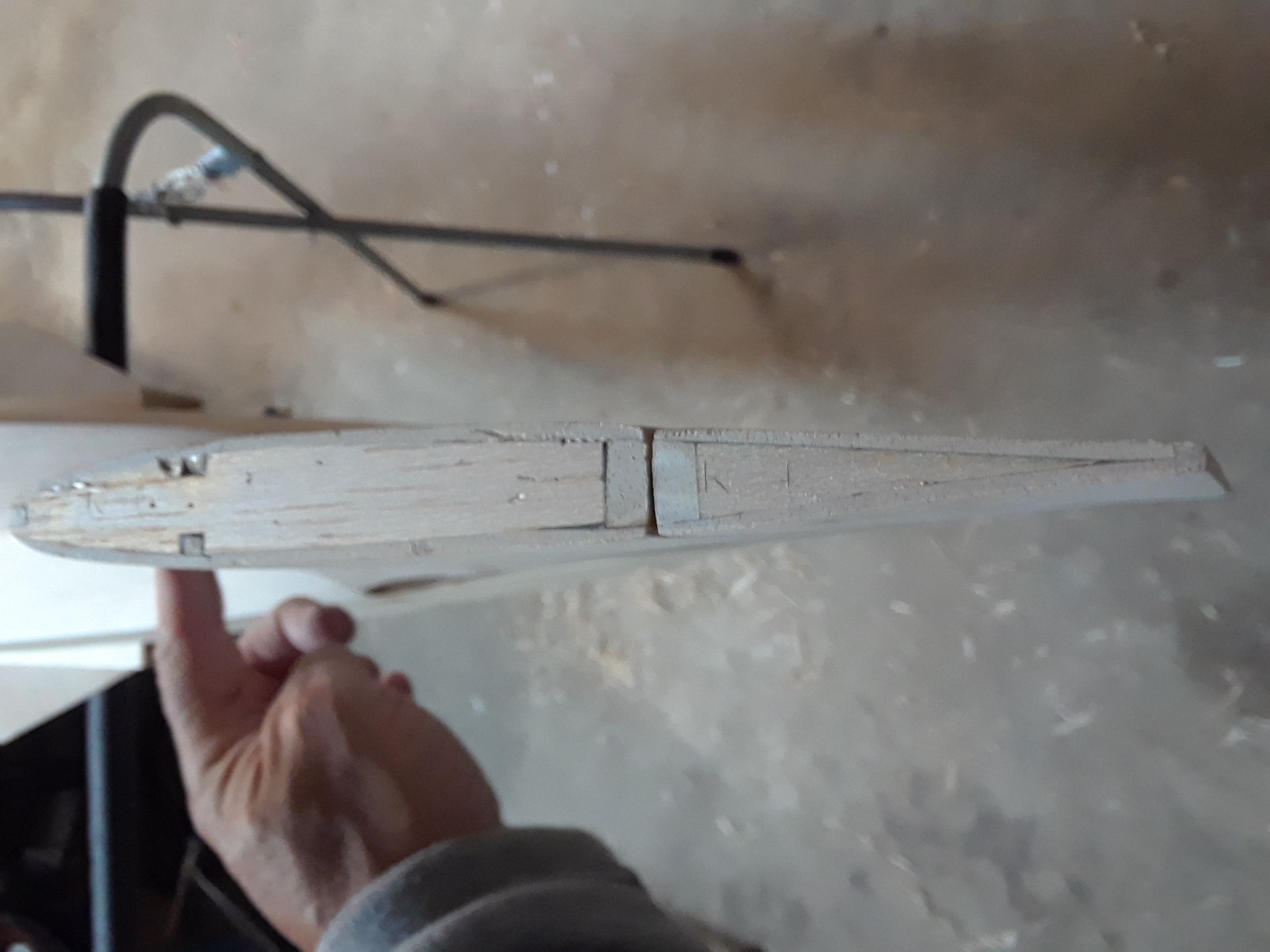

Ok then, the stabs are done and glued together, I will glue them to the fuse tomorrow, I have done that before where the stabs are glued to the fuse before they are covered, it takes extra time to cover them but it is something I have done many times.
Since the garage is cold over night I have the stabs in the smallest room with the door closed, the heat is on, by tomorrow morning the epoxy will be completely dry.

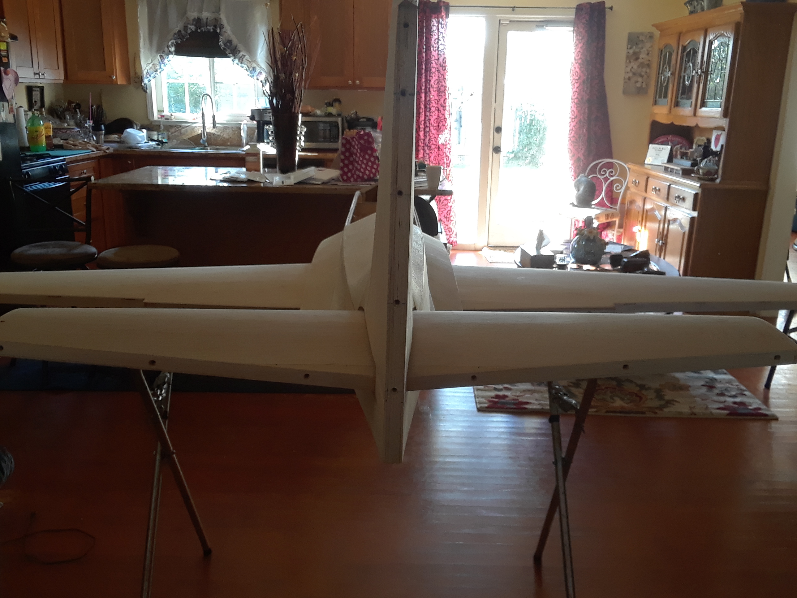

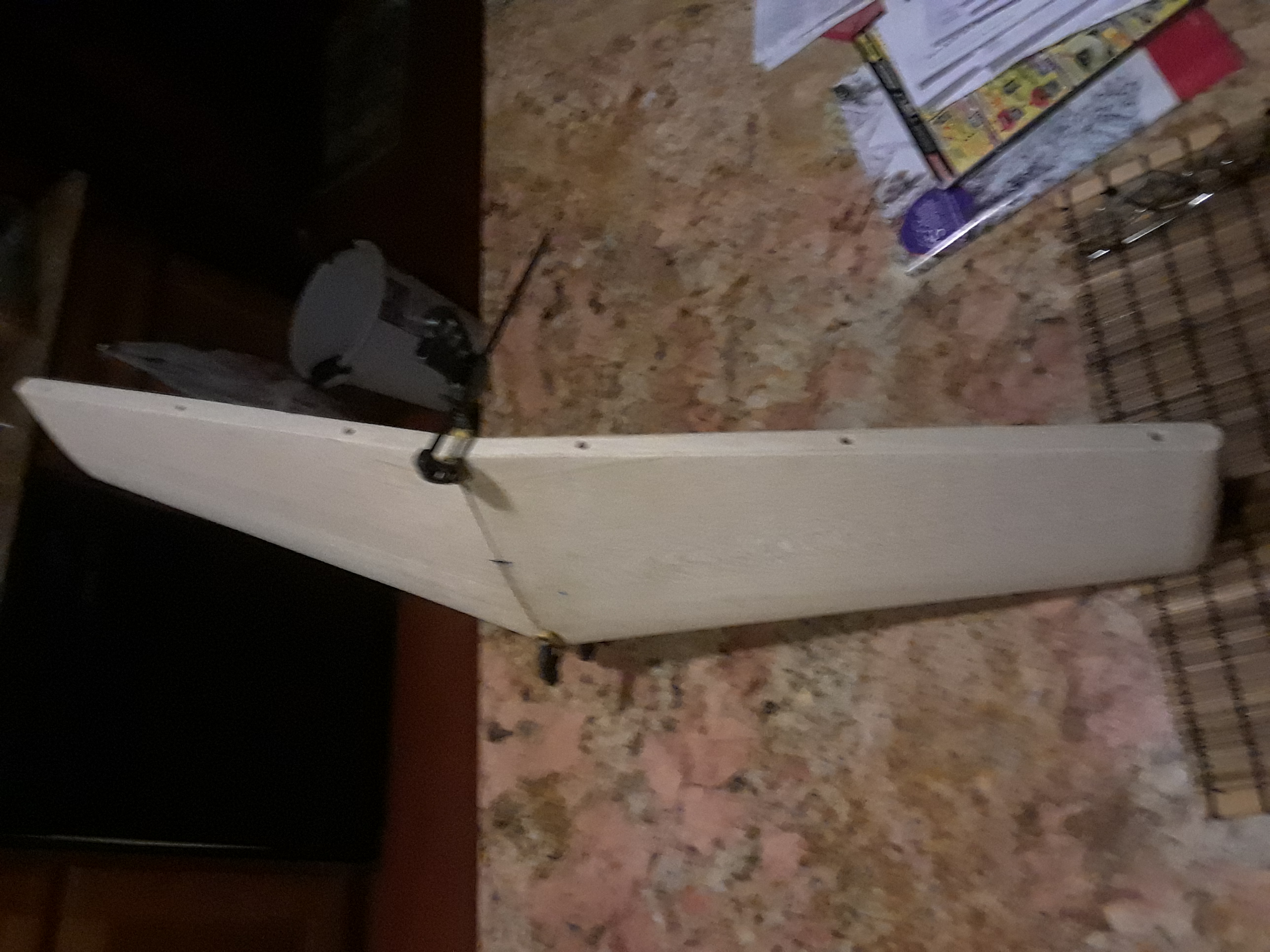

I gave the H stab a final touch here and there, it is now glued to the fuse, Im just waiting for the epoxy to dry, I used Six10 epoxy on the inside and 30 minutes epoxy on the outside, I was very surprised when it came time to fit the stab on the fuse, when eyed from behind it was perfectly aligned, after frizing it in its position with four spots of CA the wing was removed and the epoxy was added to the inside and outside of the stab.
Ok, a little game for you guys. Can you find my cat? I know she is somewhere around here, from time to time she disappears I know she is on one of the last pictures posted here, good luck and happy hunting Oh! Im adding another hunt, what kind of tequila am I drinking?

Fortunately and unfortunately I'm at work today and tomorrow so, no building 'till Monday.
still a lot of small but important details to do on the fuse, the wing will be another milestone
Today I get to play with the real ones
Mmm?, double post, how did that happened?

From last night, this is how I met the new year I was taking a quick look on how much I will have to trim the elevators .
