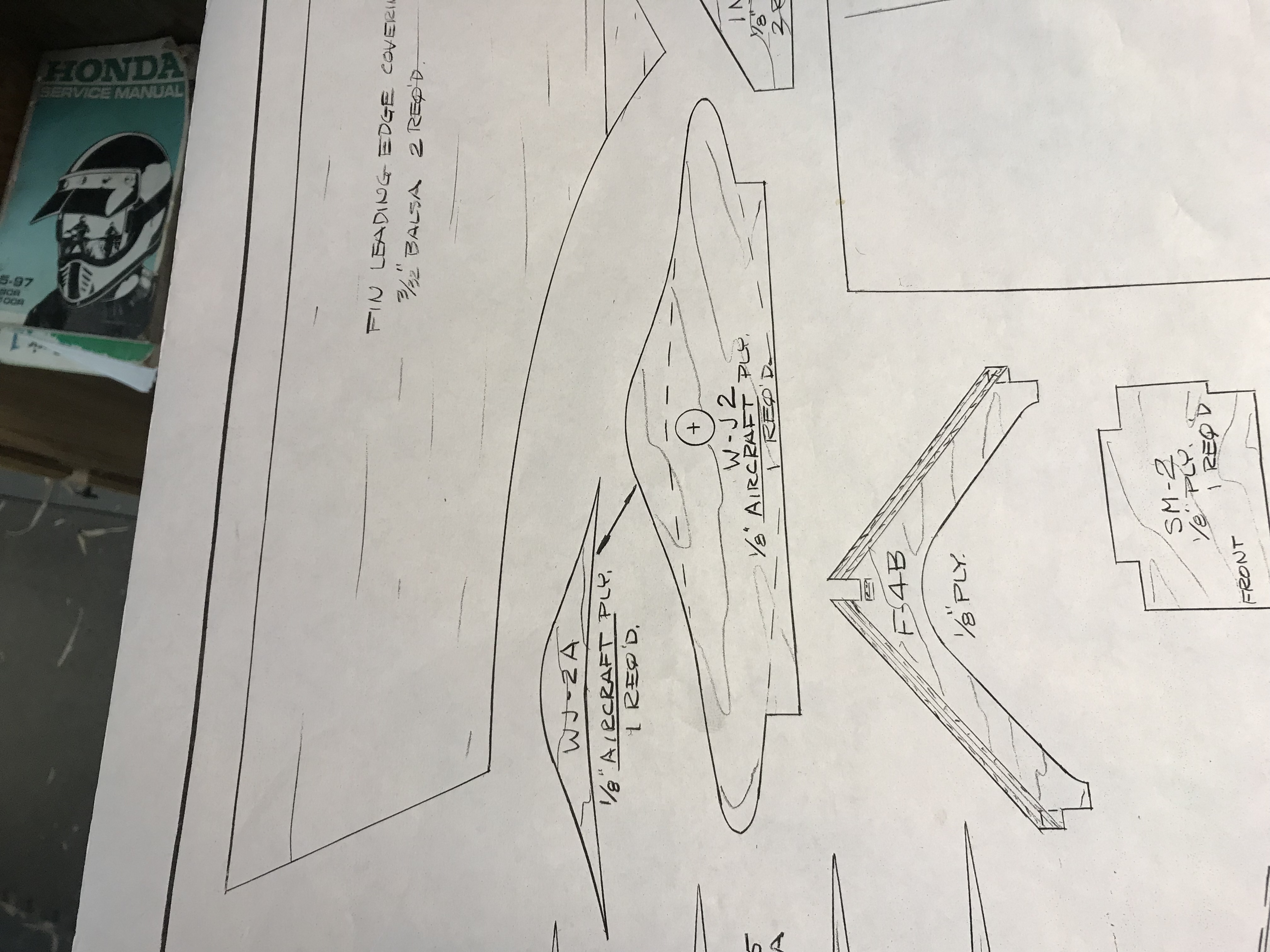

Thanks again Carlos!!
these are the parts I have.

Just not sure what you mean by elongated hole on one of the parts. I don’t see that anywhere.

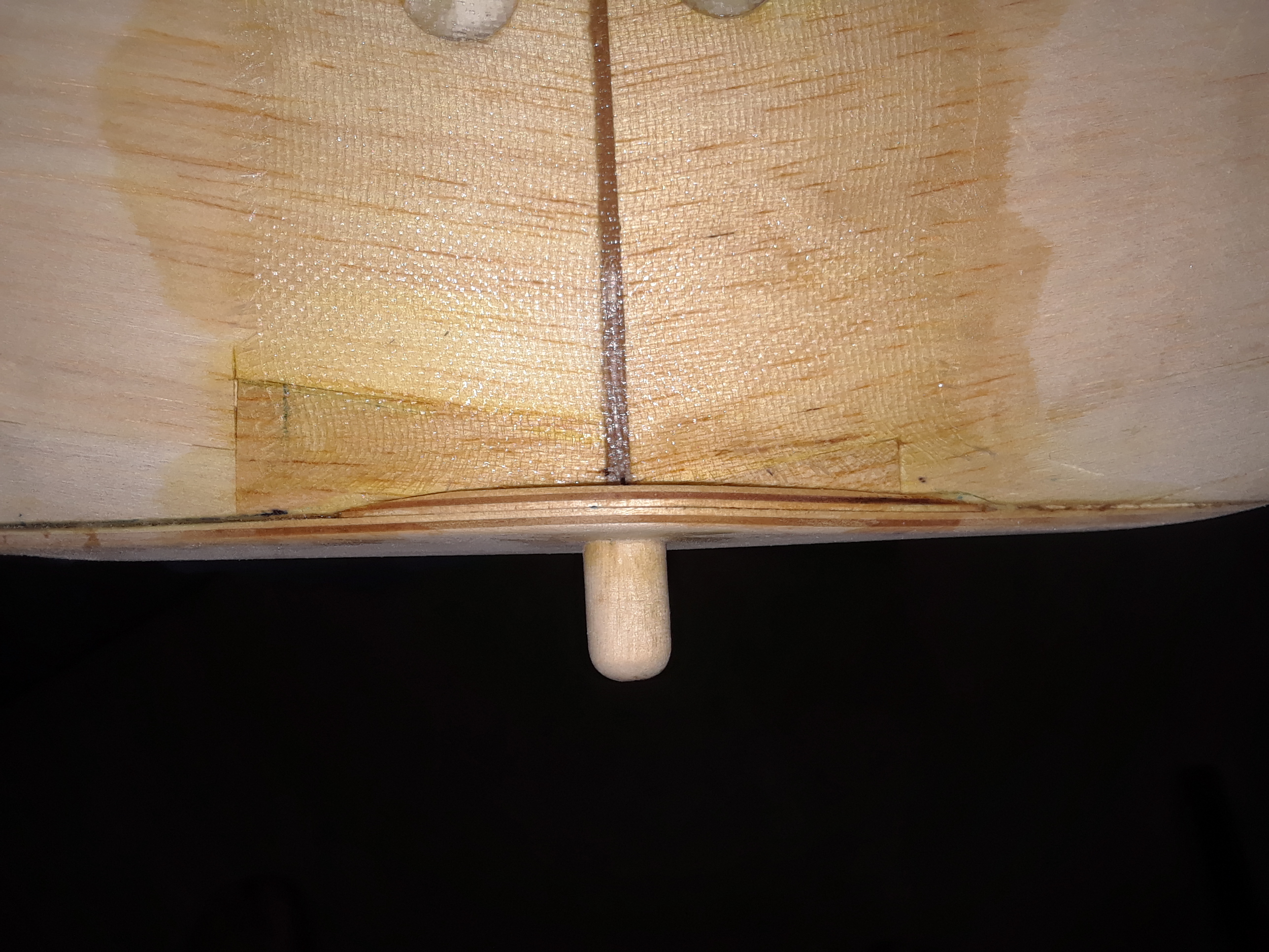

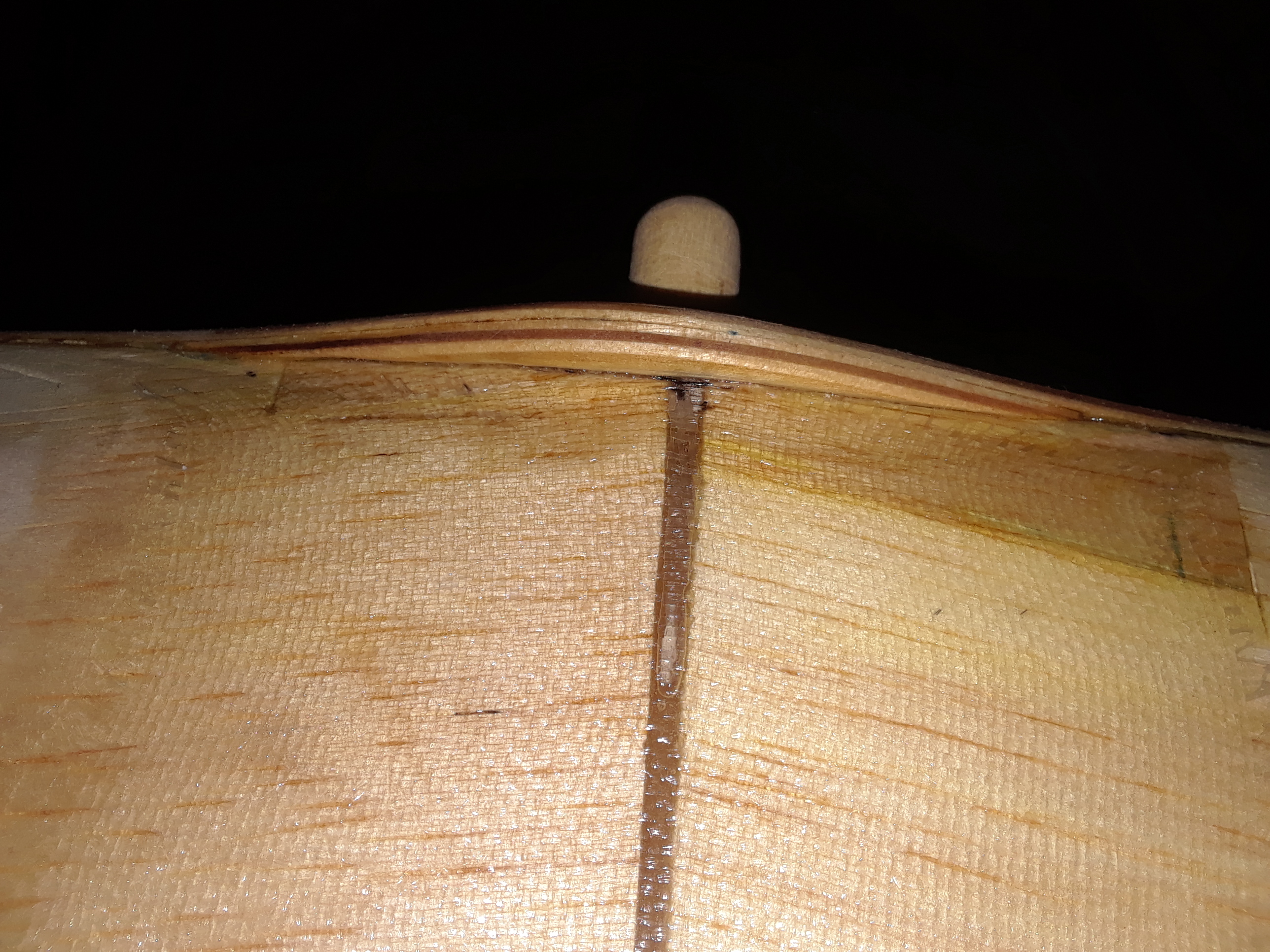

WJ2 hole is long, here, you can easily see the elongated hole that allowed me to fit the wing on and secured it with the nylon screws then I was able to secure the dowel with WJ2A from the back, I can see that the WJ2 bulkhead was not cut in your kit like the one on mine, but that easily fix, right? after all you are just the builder piece of cake for you

I have been looking for the post I did where I mention the adjustment of the hole but, can't find it, do you recall the post number, I like to go back to it to remained me what I did and said.

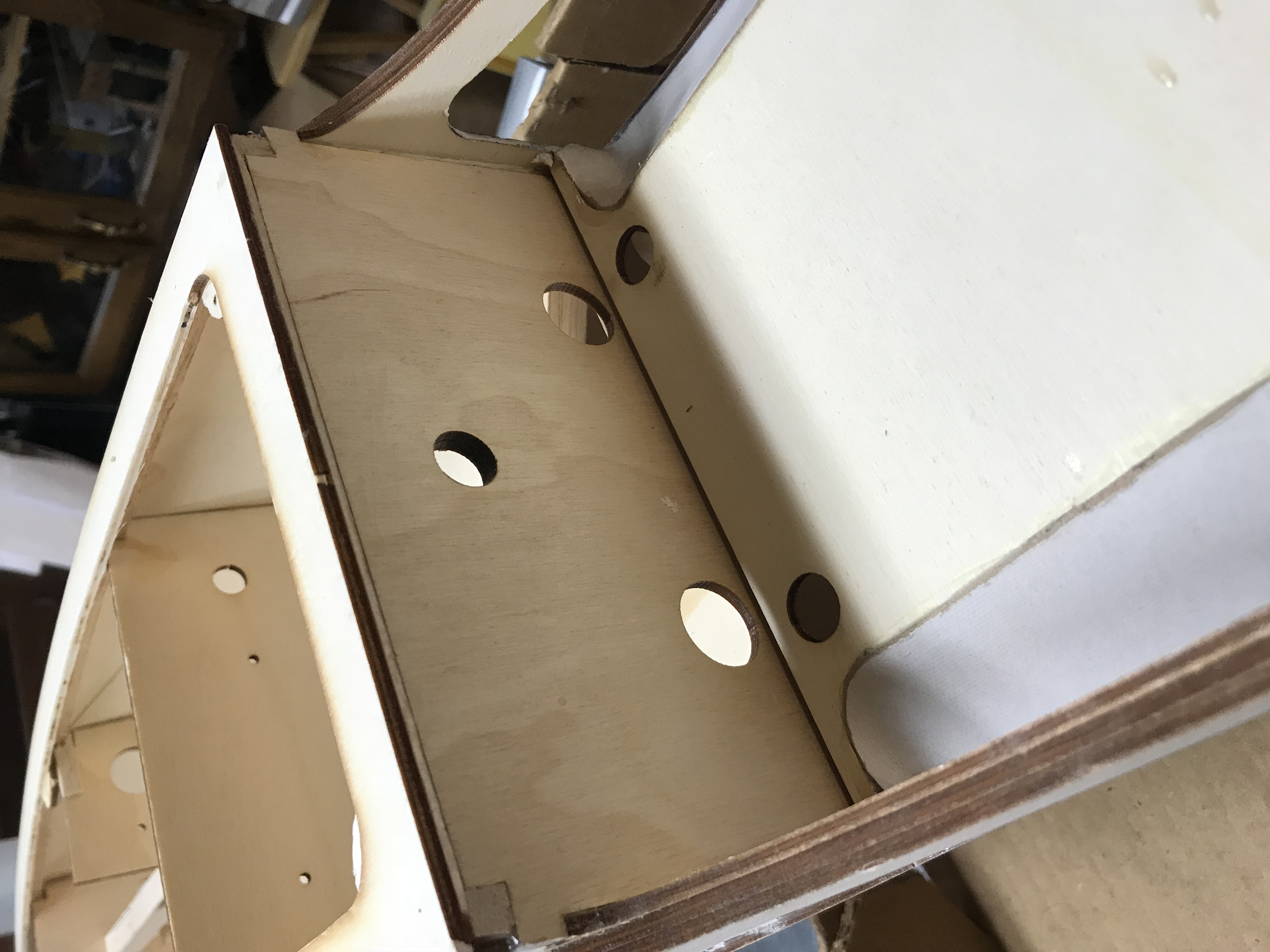

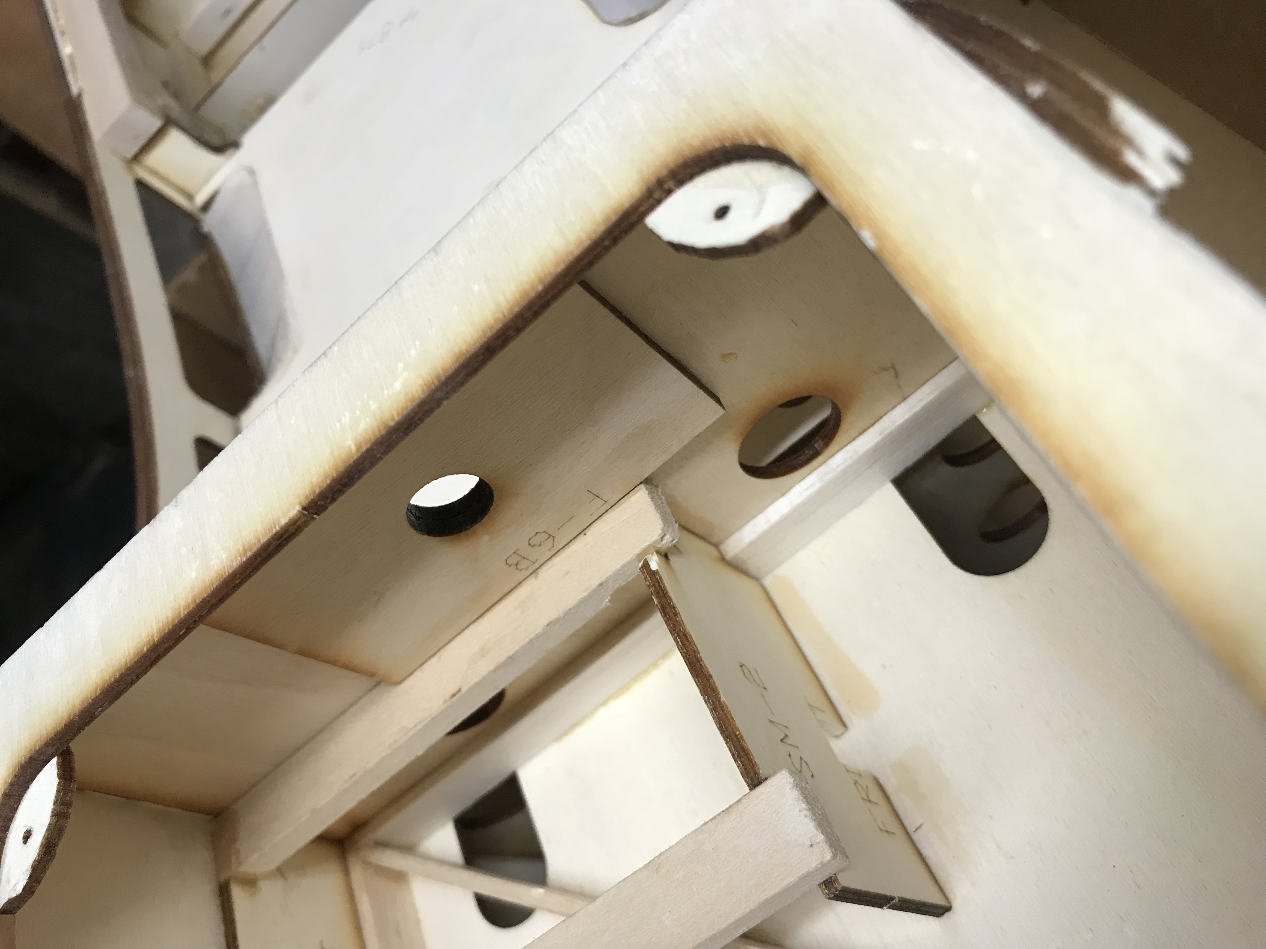

I have to correct myself here, the bulkhead holding the wing dowel is F6 which came on my kit with an elongated hole, that made it easer to fit the wing to the fuse, F6B has a round hole.<br /><br />Thank you to LDS for adding that small detail to the bulkhead

. Are you able to post some pics of the front of your wing where the 1/2" dowel protrudes? I would like to see how it supposed to look with W-J2, and WJ-2A installed.
Thanks again!
Yes if you could please, The W-J2 and WJ-2A are pictured in above post # 576. They glue to the wing.

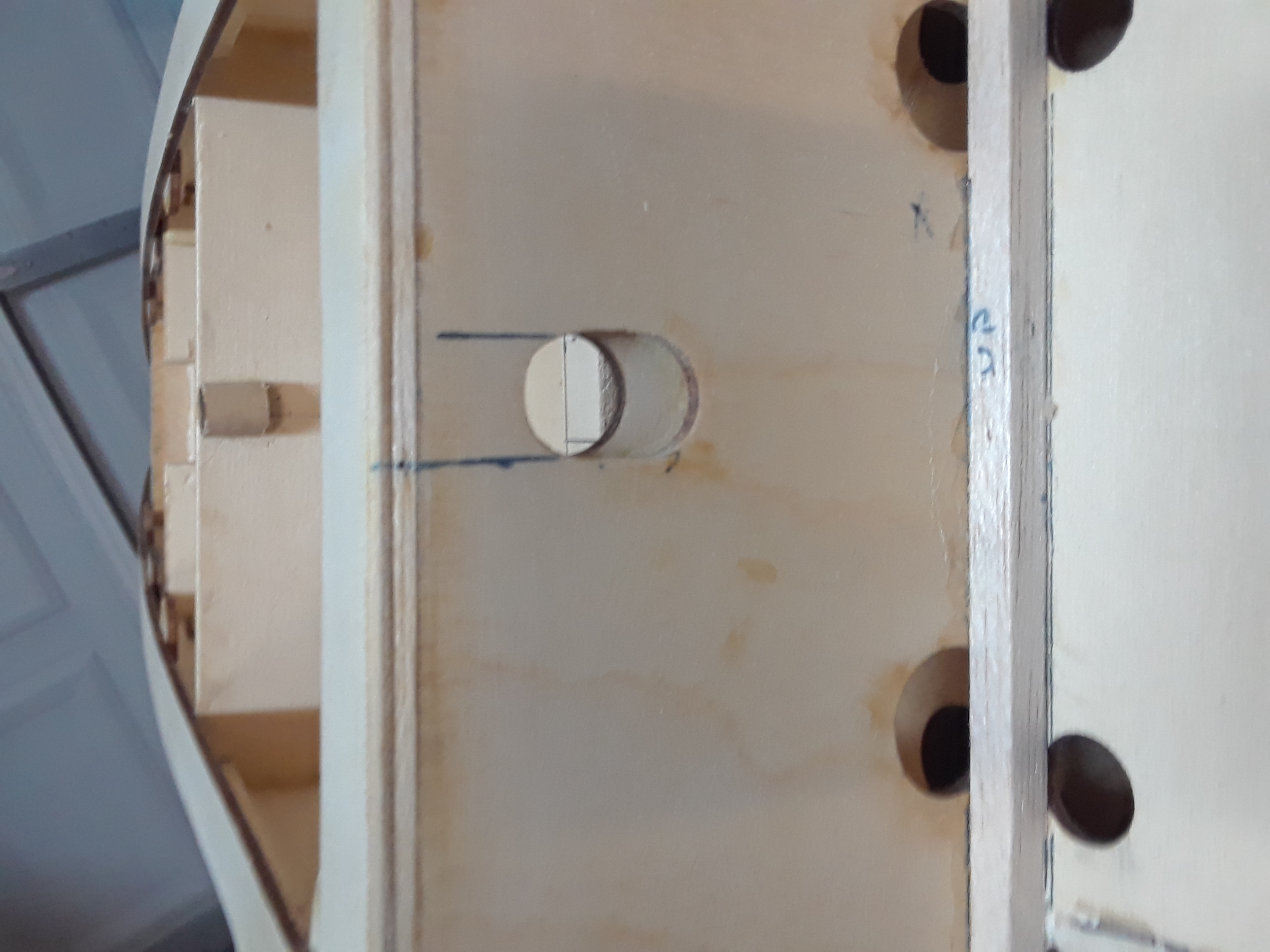

I'm checking my phone to see if I have taken the picture before.
I took a few new ones, WJ-2A supports WJ-2 from the back, it is difficult to see WJ-2A but it is there.
